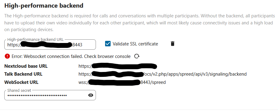

Hello, I have a problem with the configuration, it doesn’t display an error but it doesn’t connect correctly, what could be wrong?
without a valid SSL certicate you will not be able to validate the SSL certificate!
did you see this: High Performance Backend for Talk on Nextcloud with Docker ?
get your signal domain certified to be able to validate the certificate. that URL must be https://…
locally am I able to do this ? https verification ? without external server ?
which configs are important, can someone take a look at what’s wrong?
I would like someone to install each step step by step and only those things that are necessary for HPB to work

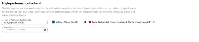

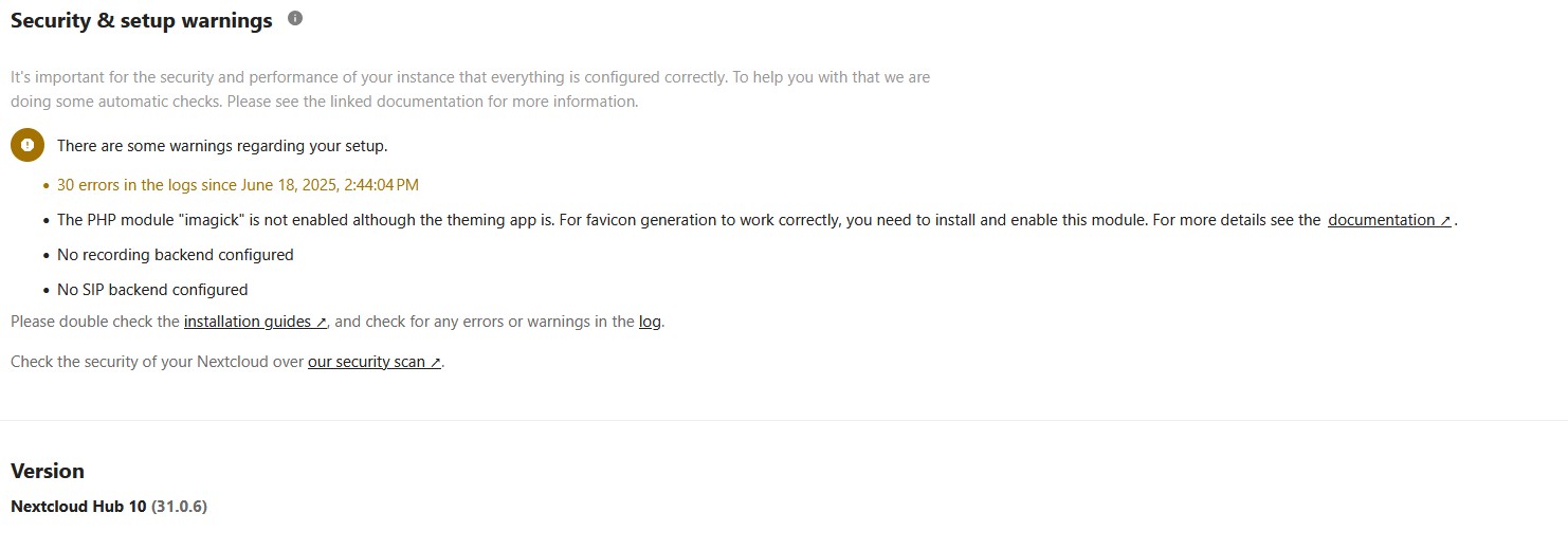

What could be wrong and where to look for the problem?
did you actually read this? nextcloud signaling server.conf Failed to start signaling.service - #13 by fakir_fakir
it almost works, but I have one more problem. please advise
