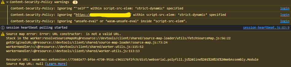

What, specifically, appears in your browser inspector Console tab when you’re logged out?

When logged out, the following appears in the console:
This was via a manual log out, but the same appears when I’m logged out due to the session error too.
