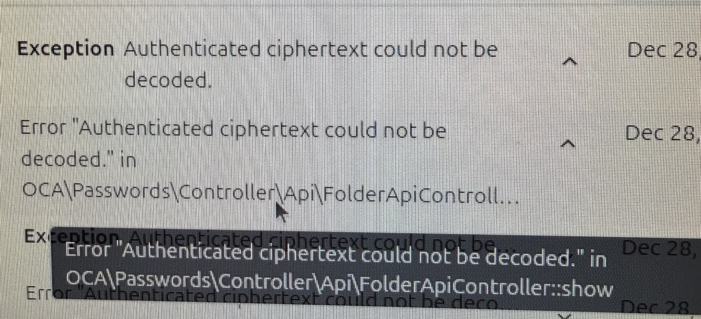

Thanks! That got me one step closer as I can now at least see and import the file, though now I’m getting a different error when trying to actually access the passwords app after the backup. Is there some step between restoring and opening the app again that I’m missing? When I view it as the default admin account on Nextcloud it’s all blank, but when I view it with my remade user (same account name as the previous backup, just recreated on a new server), I get the attached error regarding decryption. I would have thought the admin account could see everything. Do I need to make the user first and try to restore to that user with the –user option on the command line function?
Can you post the full error and stack trace instead of a screenshot?
This error indicates that something somewhere has more or less parts in the encrypted message than nextcloud expects
Do you just mean something like a “docker logs Nextcloud-aio-nextcloud” error log or do I need to be looking somewhere else as well? Just wanted to make sure I got enough info.
So I’m not sure why it messed up the formatting when I copied it out of the logs, but do you mean something like this?
{"reqId":"gg4Yupv3uCFg3YwizLgb","level":4,"time":"2026-01-01T17:43:35+00:00","remoteAddr":"172.18.0.2","user":"Redacted","app":"passwords","method":"POST","url":"/index.php/apps/passwords/api/1.0/folder/show","message":"Authenticated ciphertext could not be decoded.","userAgent":"Mozilla/5.0 (X11; Ubuntu; Linux x86_64; rv:146.0) Gecko/20100101 Firefox/146.0","version":"32.0.3.2","exception":{"Exception":"Exception","Message":"Authenticated ciphertext could not be decoded.","Code":0,"Trace":[{"file":"/var/www/html/lib/private/Security/Crypto.php","line":98,"function":"decryptWithoutSecret","class":"OC\\Security\\Crypto","type":"->","args":["*** sensitive parameters replaced ***"]},{"file":"/var/www/html/custom_apps/passwords/lib/Encryption/Object/SseV1Encryption.php","line":167,"function":"decrypt","class":"OC\\Security\\Crypto","type":"->","args":["*** sensitive parameters replaced ***"]},{"file":"/var/www/html/custom_apps/passwords/lib/Services/EncryptionService.php","line":127,"function":"decryptObject","class":"OCA\\Passwords\\Encryption\\Object\\SseV1Encryption","type":"->","args":["*** sensitive parameters replaced ***"]},{"file":"/var/www/html/custom_apps/passwords/lib/Helper/ApiObjects/AbstractObjectHelper.php","line":129,"function":"decrypt","class":"OCA\\Passwords\\Services\\EncryptionService","type":"->","args":["*** sensitive parameters replaced ***"]},{"file":"/var/www/html/custom_apps/passwords/lib/Helper/ApiObjects/FolderObjectHelper.php","line":84,"function":"getRevision","class":"OCA\\Passwords\\Helper\\ApiObjects\\AbstractObjectHelper","type":"->","args":[{"__class__":"OCA\\Passwords\\Db\\Folder","id":3},{"trashed":false,"hidden":false},true]},{"file":"/var/www/html/custom_apps/passwords/lib/Helper/ApiObjects/FolderObjectHelper.php","line":220,"function":"getApiObject","class":"OCA\\Passwords\\Helper\\ApiObjects\\FolderObjectHelper","type":"->","args":[{"__class__":"OCA\\Passwords\\Db\\Folder","id":3},"model",{"trashed":false,"hidden":false}]},{"file":"/var/www/html/custom_apps/passwords/lib/Helper/ApiObjects/FolderObjectHelper.php","line":99,"function":"getFolders","class":"OCA\\Passwords\\Helper\\ApiObjects\\FolderObjectHelper","type":"->","args":[{"__class__":"OCA\\Passwords\\Db\\FolderRevision","id":null},{"0":"And 10 more entries, set log level to debug to see all entries","id":"00000000-0000-0000-0000-000000000000","created":1767289414,"updated":1767289414,"edited":1767289415,"revision":"00000000-0000-0000-0000-000000000000"}]},{"file":"/var/www/html/custom_apps/passwords/lib/Controller/Api/AbstractObjectApiController.php","line":150,"function":"getApiObject","class":"OCA\\Passwords\\Helper\\ApiObjects\\FolderObjectHelper","type":"->","args":[{"__class__":"OCA\\Passwords\\Db\\Folder","id":null},"model+folders"]},{"file":"/var/www/html/lib/private/AppFramework/Http/Dispatcher.php","line":204,"function":"show","class":"OCA\\Passwords\\Controller\\Api\\AbstractObjectApiController","type":"->","args":["00000000-0000-0000-0000-000000000000","model+folders"]},{"file":"/var/www/html/lib/private/AppFramework/Http/Dispatcher.php","line":118,"function":"executeController","class":"OC\\AppFramework\\Http\\Dispatcher","type":"->","args":[{"__class__":"OCA\\Passwords\\Controller\\Api\\FolderApiController"},"show"]},{"file":"/var/www/html/lib/private/AppFramework/App.php","line":153,"function":"dispatch","class":"OC\\AppFramework\\Http\\Dispatcher","type":"->","args":[{"__class__":"OCA\\Passwords\\Controller\\Api\\FolderApiController"},"show"]},{"file":"/var/www/html/lib/private/Route/Router.php","line":321,"function":"main","class":"OC\\AppFramework\\App","type":"::","args":["FolderApiController","show",{"__class__":"OC\\AppFramework\\DependencyInjection\\DIContainer"},{"_route":"passwords.folder_api.show"}]},{"file":"/var/www/html/lib/base.php","line":1061,"function":"match","class":"OC\\Route\\Router","type":"->","args":["/apps/passwords/api/1.0/folder/show"]},{"file":"/var/www/html/index.php","line":25,"function":"handleRequest","class":"OC","type":"::","args":[]}],"File":"/var/www/html/lib/private/Security/Crypto.php","Line":114,"message":"Authenticated ciphertext could not be decoded.","exception":[],"CustomMessage":"Authenticated ciphertext could not be decoded."},"id":"6956b259bdfaf"}
