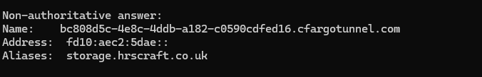

The error dns_probe_finished_nxdomain indicates that no IP address can be resolved for the name of the Nextcloud (NXDOMAIN == Non-Existent Domain). Can you use e.g. ‘nslookup’ to check the resolution of the name to the correct IP address?
it comes up with this what should i do next
now i am getting a bad gateway
I think there is a configuration error at Cloudflare. Post parts of your configuration.
