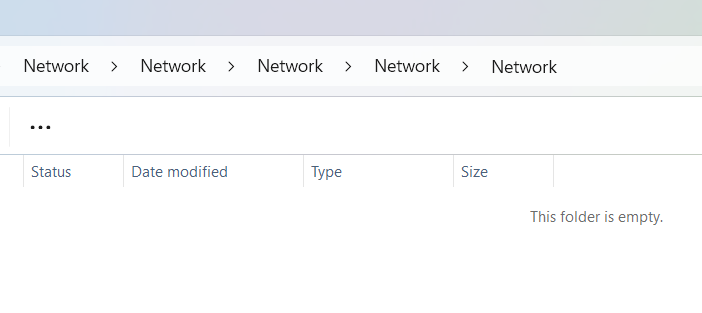

I already switched to dev branch for my Windows NextCloud Client and updated to the latest version v4.0.1, but it seems those folders are still there and there is no something like auto deletion of these folders.

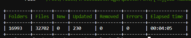

files:scan --all
on your server to update the database links. It is recommended that no one interact with the system during this operation.
I have performed the full scan and got the result below:
After this, I tried resyncing my folders using Windows NextCloud client, and those folders still exists.
Note: These folders are visible on both the server side and my own computer, with status “Synced”
