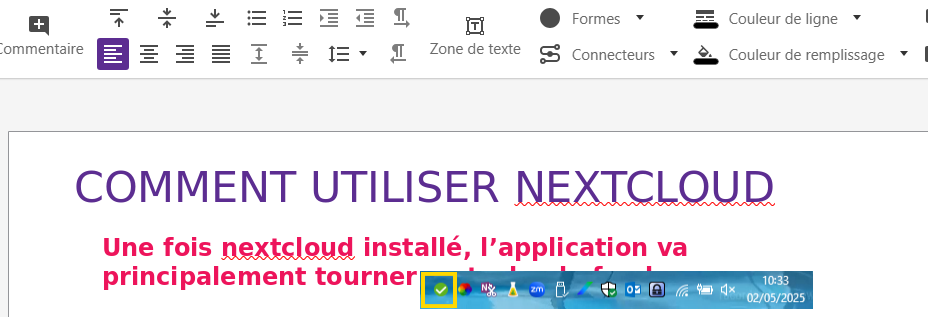

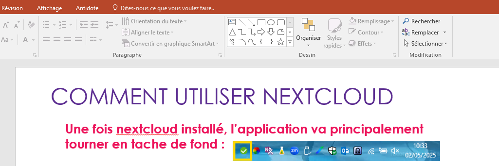

Here’s an example of the kind of “issue” that we encounter.
Here’s what a powerpoint i made looks like in MS office.
Here’s what it looks like in collabora
I tried putting the same file (litteraly did a copy paste) on my own nextcloud (which is the AIO running on unraid) and it displays just fine.
So i guess the issue is with that specific instance of nextcloud that we use at work. Could it be an issue of not being up to date ?
EDIT : just double checked, work nextcloud is hub 8 29.0.5 and my home version is hub 10 31.0.4 so i guess the issues are because of that.

Yes that is a correct assumption. Nextcloud office (collabora online) has improved quite alot.
