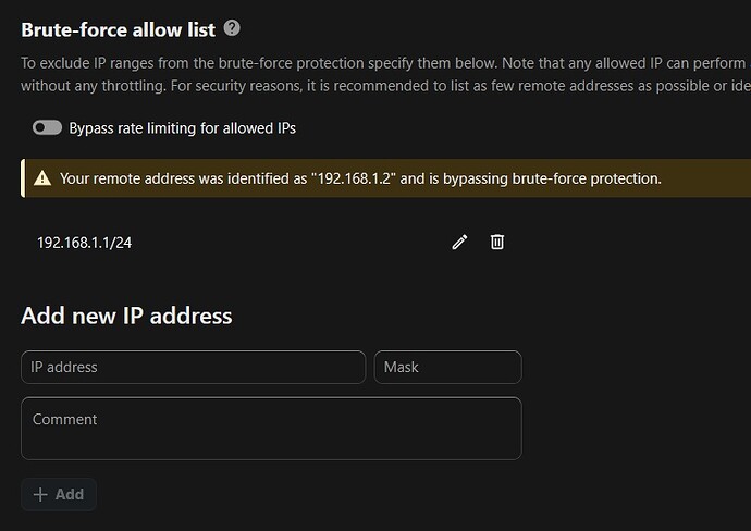

Are the server (self-hosted) and the PC on your local LAN, or it’s hosted outside and you’re accessing it over the internet? The reason I’m asking is that if they’re both on your LAN then just exclude your local IP range from being throttled. This way you get this variable out of the equation and rule it out as a potential culprit. Otherwise, just disable the “Brute-force settings” app altogether, temporarily, to see if that fixes the problem.
Just to clarify: this just disables the UI; it does not disable brute force protection:
