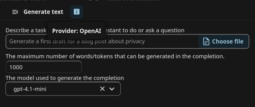

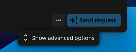

The model chosen in the admin settings is only the default model for all tasks where OpenAI is chosen as the provider. The model to actually use can be changed within the Assistant under the advanced options:
Is that what you are looking for, or are you referring to something else?

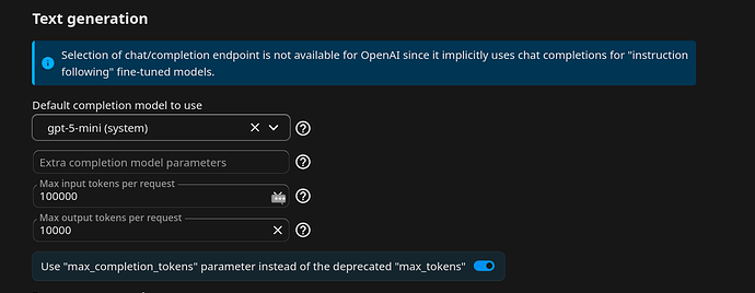

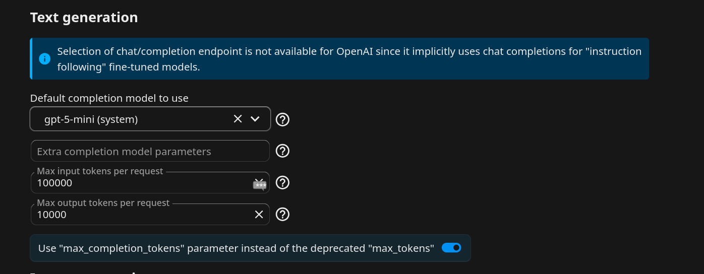

It’s the one configured for text generation in the OpenAI integration settings:
I guess we could add a note there that it’s the Chat one
Chat with AI indeed does not have its own model selector, it is selected by the administrator in the way @janepie described in the post above me.
