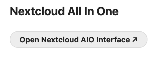

  1. Open your NC instance in Brave Browser
  2. Go to Admin settings
  3. CLick on “Open AIO interface”

Actually, everything works perfectly fine when I use the 8443 port instead of the 8080 (At least after rolling back to stable 2.1.2 AIO).
So I believe it would be nice that the link to the AIO interface from within the Administration panel of the NC instance would point to 8443 and not 8080.
