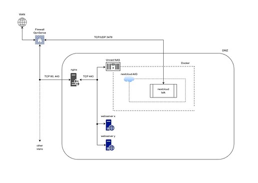

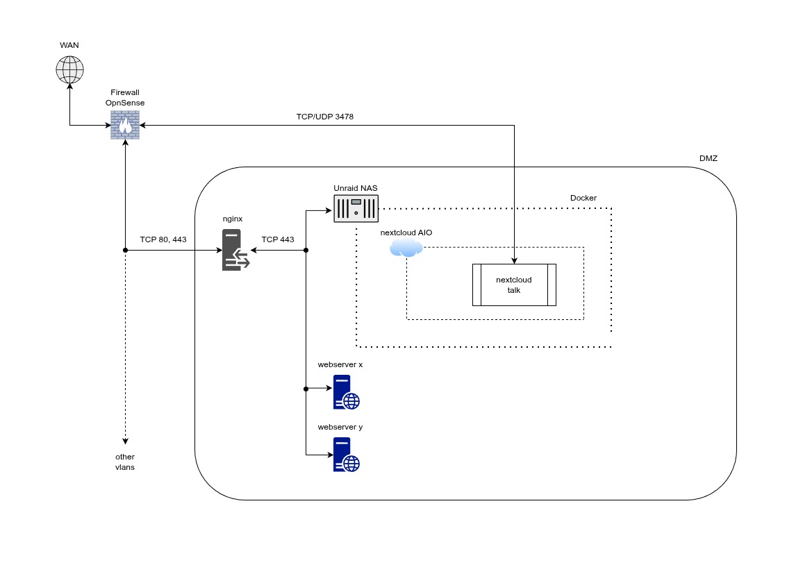

Nextcloud-Aio-Talk cant connect to video call
Nextcloud AIO version : v13.4.1
Nextcloud: Nextcloud Hub 26 Winter (33.0.7)
Talk Server version (eg, 14.0.2): eturnal 15.2.6/janus 1.4.1 (latest as per AIO bundel)
Custom Signaling server configured: No
Custom TURN server configured: No
Custom STUN server configured: No
In case the web version of Nextcloud Talk is involved:
Operating system (eg, Windows/Ubuntu/…): Windows, Ubuntu
Browser name and version (eg, Chrome v101): Firefox
The issue you are facing:
Chat is working. Videocalls start then open and close in a loop
Is this the first time you’ve seen this error? (Y/N):
from the beginning of the install
Network schema:
The first hints i followed were about the ports i have to open but i already did that according to the AIO install instructions. nginx config is from the instructions with http2 and https only. But as the port does not go via nginx that should be no problem.

eturnal.yml
eturnal:
  listen:
    - ip: "::"
      port: 3478
      transport: udp
    - ip: "::"
      port: 3478
      transport: tcp
  log_dir: stdout
  log_level: warning
  secret: "ASDF"
  relay_ipv4_addr: "172.18.0.12"
  blacklist_peers:
  - recommended
  whitelist_peers:
  - 127.0.0.1
  - ::1
  - "172.18.0.12"
janus.jcfg comments removed
general: {
        configs_folder = "/usr/local/etc/janus"                 # Configuration files folder
        plugins_folder = "/usr/local/lib/janus/plugins"                 # Plugins folder
        transports_folder = "/usr/local/lib/janus/transports"   # Transports folder
        events_folder = "/usr/local/lib/janus/events"                   # Event handlers folder
        loggers_folder = "/usr/local/lib/janus/loggers"                 # External loggers folder
        debug_level = 4                                                 # Debug/logging level, valid values are 0-7
        admin_secret = "janusoverlord"
        protected_folders = [
                "/bin",
                "/boot",
                "/dev",
                "/etc",
                "/initrd",
                "/lib",
                "/lib32",
                "/lib64",
                "/proc",
                "/sbin",
                "/sys",
                "/usr",
                "/var",
                "/opt/janus/bin",
                "/opt/janus/etc",
                "/opt/janus/include",
                "/opt/janus/lib",
                "/opt/janus/lib32",
                "/opt/janus/lib64",
                "/opt/janus/sbin"
certificates: {
        #cert_pem = "/path/to/certificate.pem"
        #cert_key = "/path/to/key.pem"
        #cert_pwd = "secretpassphrase"
        #dtls_accept_selfsigned = false
        #dtls_ciphers = "your-desired-openssl-ciphers"
        #rsa_private_key = false
media: {
        #ipv6 = true
        #ipv6_linklocal = true
        #min_nack_queue = 500
        #rtp_port_range = "20000-40000"
        #dtls_mtu = 1200
        #no_media_timer = 1
        #slowlink_threshold = 4
        #twcc_period = 100
        #dtls_timeout = 500
plugins: {
        #disable = "libjanus_echotest.so,libjanus_recordplay.so"
transports: {
        #disable = "libjanus_rabbitmq.so"
loggers: {
        #disable = "libjanus_jsonlog.so"
events: {
        #broadcast = true
        #combine_media_stats = true
        #disable = "libjanus_sampleevh.so"
        #stats_period = 5
nat: {
        turn_server = "my.domain.tld"
        turn_port = 3478
        turn_type = "udp"
        turn_user = "ASDF"
        turn_pwd = "ASDF"
    # The ice ignore list is set by janus by default, so also do this here
    ice_ignore_list = "vmnet"
After some tests and restarting the AIO dockers i saw errors and warning when the talk server starts. Can’t say if they are of any help.
talk server start log
+ SIGNALING_LISTEN='[::]:8081'
+ '[' warn '!=' debug ']'
+ set +x
[44] 2026/08/07 12:20:32.792223 [INF] Starting nats-server
[44] 2026/08/07 12:20:32.792253 [INF]   Version:  2.14.3
[44] 2026/08/07 12:20:32.792255 [INF]   Git:      [9b17a58]
[44] 2026/08/07 12:20:32.792256 [INF]   Name:     NA2JIW7B2KRHDA7LGGTISVYOBMZOYEJ4PNUKNRR7TRRQSFD6ZA4CSMI5
[44] 2026/08/07 12:20:32.792258 [INF]   ID:       NA2JIW7B2KRHDA7LGGTISVYOBMZOYEJ4PNUKNRR7TRRQSFD6ZA4CSMI5
[44] 2026/08/07 12:20:32.792262 [INF] Using configuration file: /etc/nats.conf (sha256:32d5c4377083a8a4547e8923799e2b9a01e89973836d67582ed9ece110290cce)
[44] 2026/08/07 12:20:32.795731 [INF] Listening for client connections on 127.0.0.1:4222
[44] 2026/08/07 12:20:32.795751 [INF] Server is ready
main.go:177: Starting up version 2.1.1~docker/go1.26.1 as pid 47
main.go:184: Using a maximum of 12 CPUs
client.go:114: Connection established to nats://127.0.0.1:4222 (NA2JIW7B2KRHDA7LGGTISVYOBMZOYEJ4PNUKNRR7TRRQSFD6ZA4CSMI5)
common.go:208: WARNING: No GRPC server certificate and/or key configured, running unencrypted
common.go:210: WARNING: No GRPC CA configured, expecting unencrypted connections
backend_storage_static.go:73: Backend backend-1 added for https://my.domain.tld/
hub.go:285: Using a maximum of 32 concurrent backend connections per host
hub.go:292: Using a timeout of 10s for backend connections
hub.go:325: No trusted proxies configured, only allowing for [127.0.0.0/8, ::1/128, 10.0.0.0/8, 172.16.0.0/12, 192.168.0.0/16]
hub.go:366: Not using GeoIP database
hub.go:449: No candidates allowlist
hub.go:460: No candidates blocklist
settings.go:70: Maximum bandwidth 1 Mbps per publishing stream
settings.go:78: Maximum bandwidth 2 Mbps per screensharing stream
janus.go:182: Using a timeout of 10s for MCU requests
janus.go:194: No candidates allowlist
janus.go:206: No candidates blocklist
main.go:287: Could not initialize janus MCU (dial tcp 127.0.0.1:8188: connect: connection refused) will retry in 1s
janus.go:516: Connected to Janus WebRTC Server 1.4.1 by Meetecho s.r.l.
janus.go:520: Found JANUS VideoRoom plugin 0.0.10 by Meetecho s.r.l.
janus.go:532: Plugin janus.eventhandler.wsevh not found, realtime usage will not be available
janus.go:535: Used dependencies: {Glib2:2.88.1 Jansson:2.15.0 Libnice:0.1.22 Libsrtp:libsrtp2 2.7.0 Libcurl: Crypto:OpenSSL 3.5.7 9 Jun 2026}
janus.go:540: Data channels are supported
janus.go:544: Full-Trickle is enabled
janus.go:551: Created Janus session 300216103081964
janus.go:558: Created Janus handle 6177246073247423
main.go:319: Using janus MCU
hub.go:503: Using a timeout of 10s for MCU requests
backend_server.go:127: No IPs configured for the stats endpoint, only allowing access from [127.0.0.1/32, ::1/128]
main.go:389: Listening on [::]:8081
Exec: /opt/eturnal/erts-15.2.6/bin/erlexec -noinput +Bd -boot /opt/eturnal/releases/1.12.2/start -mode embedded -boot_var SYSTEM_LIB_DIR /opt/eturnal/lib -config /opt/eturnal/releases/1.12.2/sys.config -args_file /opt/eturnal/releases/1.12.2/vm.args -erl_epmd_port 3470 -start_epmd false -- foreground
Root: /opt/eturnal
/opt/eturnal
Janus version: 1401 (1.4.1)
Janus commit: 85304a7a4bdb2719583ad53ae04130a8273dba6a
Compiled on:  Thu Jul 30 13:19:19 UTC 2026
Logger plugins folder: /usr/local/lib/janus/loggers
  Starting Meetecho Janus (WebRTC Server) v1.4.1
Checking command line arguments...
Debug/log level is 3
Debug/log timestamps are disabled
Debug/log colors are disabled
[WARN] libcurl not available, Streaming plugin will not have RTSP support
[WARN] libogg not available, Streaming plugin will not have file-based Opus streaming
[ERR] [plugins/janus_streaming.c:janus_streaming_init:2812] Can't add 'ondemand' mountpoint 'file-ondemand-sample', unsupported format (we only support raw mu-Law and a-Law files right now)
[WARN] No Unix Sockets server started, giving up...
[WARN] The 'janus.transport.pfunix' plugin could not be initialized
Any help or idea what I should do next?
It is irritating as this was the AIO install and everything else so far works except the video calls.
