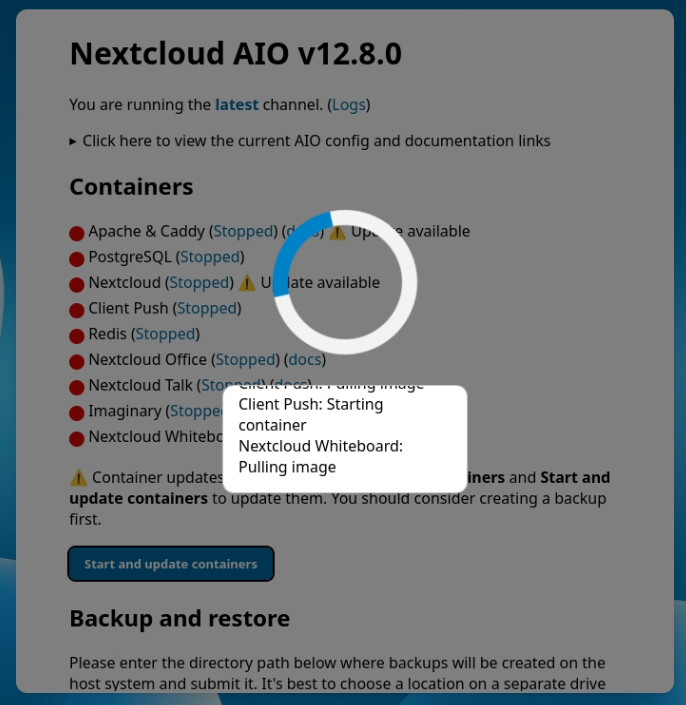

I’m trying to setup AIO in a VM, but no matter which I use, be it KVM, VirtualBox or VMWare, after making all the docker setup and starting AIO, after entering domain and picking the containers you want (I went with all defaults, no extra stuff besides picking Winter), I pressed the Start Containers button and it seems to work for a little bet, then it gets stuck or timeouts? it never does anything, after refreshing, several containers and images are missing.
The Master Container’s logs don’t contain anything helpful, I have no idea how to troubleshoot this one, given the lack of logs, doing this same process outside of a VM works flawlessly and I’ve successfully setup AIO in regular non-VM systems.
If I refresh the AIO Config website after it is stuck like this for a long time, I can stop all containers and try to start them again, but it’s the same, it just gets stuck and I’m not sure what’s wrong, or where to get logs for it, checking docker’s own logs seems to yield nothing weird, and mastercontainer’s own logs are basically empty besides start up messages, so I don’t know where to find the cause of the timeout or block.
I’ve made sure to set SELinux permissive on host and guest just in case, DNS is not an issue and both host and guest can talk to each other, can browse the web and both host and guest can download all images from the AIO repos (I manually pulled them on both sides to make sure they weren’t being blocked or unable to resolve, they all pulled successfully).
I’m honestly stuck and would really appreciate some help, as I said, nothing like this happens in Host, only in VM Guests.
  1. Make a VM (I’ve tried QEMU/KVM, VirtualBox and VMWare, Debian and Fedora based guests)
  2. Setup Docker and Install AIO
  3. Go to the AIO initial config, get past domain validation and start your containers for the first time.

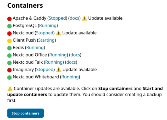

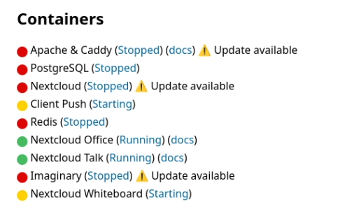

it didn’t do much, same behavior, it gets stuck starting containers, there’s no logs detailing why either, it gets stuck here:
if I refresh, it’s always failing at the last few containers

That said, I found this in docker’s journalctl:
Apr 03 00:47:44 fedora dockerd[1198]: time="2026-04-03T00:47:44.846895149+01:00" level=error msg="[resolver] failed to query external DNS server" client-addr="udp:127.0.0.1:43747" dns-server="udp:127.0.0.53:53" error="read udp 127.0.0.1:43747->127.0.0.53:53: i/o timeout" question=";nextcloud-aio-nextcloud.\tIN\t AAAA"
Apr 03 00:48:18 fedora dockerd[1198]: time="2026-04-03T00:48:18.895924146+01:00" level=error msg="[resolver] failed to query external DNS server" client-addr="udp:127.0.0.1:36374" dns-server="udp:127.0.0.53:53" error="read udp 127.0.0.1:36374->127.0.0.53:53: i/o timeout" question=";nextcloud-aio-nextcloud.\tIN\t A"

Who owns the 192.168.122.0/24-Network?
Is it owned by VM-Host and a Virtual Network (NAT)? If so you shall not use such a network, but use Bridge Device or a Mactap Device instead.
Hint: Bridge Device, Mactap Device and Virtual Network are the options in KVM/QEMU and its Virtual Machine Manager. There are similar options in VirtualBox and VMWare, but they may have diffrent namens..
I ask for this, because KVM/QEMU’s automaticaly created virbr0 uses usually a 192.168.122.0/24-Network for its Virtual Network’s.
I would say using such a Virtual Network is not recommended for what you intend to do (hostiing an NC-Server) because to access a Server in such a Virtual Network need one more NATing in your local network to access the NC-Server from other networks.
It seems, that your DNS server cannot resolve the reverse-DNS (PTR).

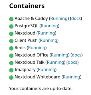

I was indeed using the default NAT network adapter that comes with qemu/kvm, I have switched to a macvtap adapter and rolled back my docker-compose to how it was without MTU modification.
Docker stopped complaining about DNS resolution issues in journalctl, but Nextcloud is still unable to start all the containers, I’m not sure where to look next.
Master Container’s logs still offer nothing usable to debug this, and now docker’s own logs are pretty quiet without the resolution issues.
After some system package updates on both host and guest, things lit up as expected, I’m still concerned I’m not able to find out what the original problem was…
I’ll keep monitoring, maybe they’ll fail when I want to update them, or change some settings that requires restarting the containers? at least they all started this time, fingers crossed it was just some rotten old packages :grimacing:
