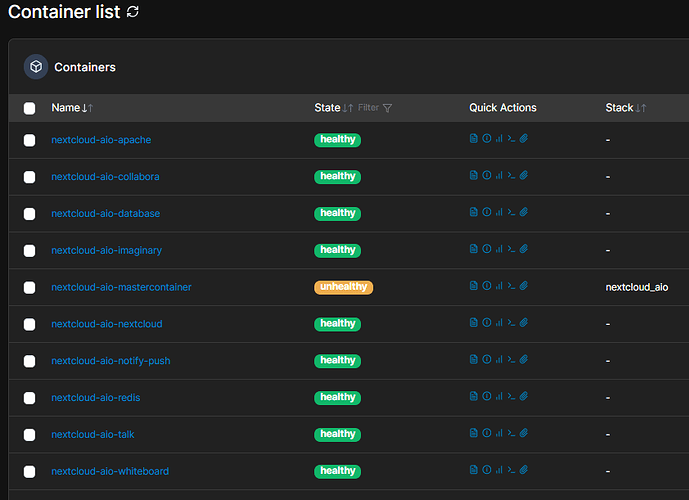

Running Nextcloud AIO version 32.0.2 (latest) as a docker/container on my Synology NAS running DSM 7.2.2 update 5. In addition, NAS is configured as a reverse proxy (which works fine, including my other reverse proxy entries (exchange and MSSQL servers)

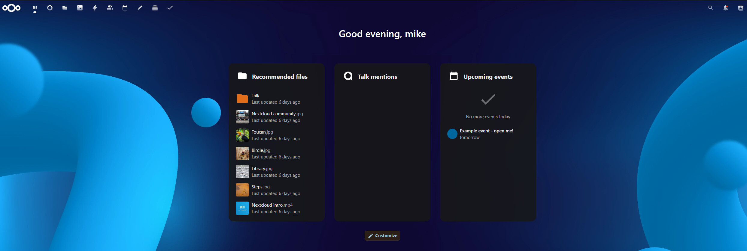

Seems Nextcloud AIO is working fine, after navigating around the GUI, uploading files…etc
However, I get a warning (status yellow) for the nextcloud-aio-mastercontainer

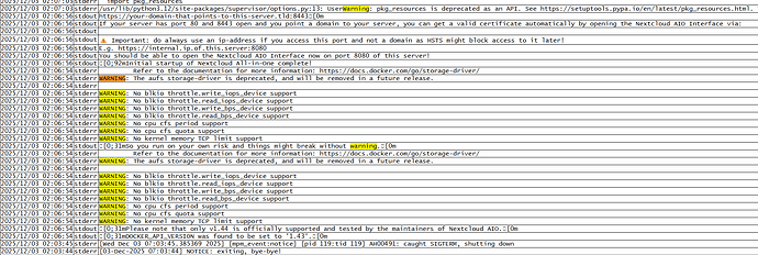

Looking at the logs, I see serveral warnings. Not sure which warning needs to be addressed to get the nextcloud-aio-mastercontainer to go “green”
Any help on this matter would be greatly appreciated. It would be safe this has happened to someone else

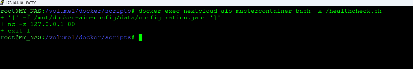

Hm… Can you run sudo docker exec nextcloud-aio-mastercontainer bash -x /healthcheck.sh and post the output here?

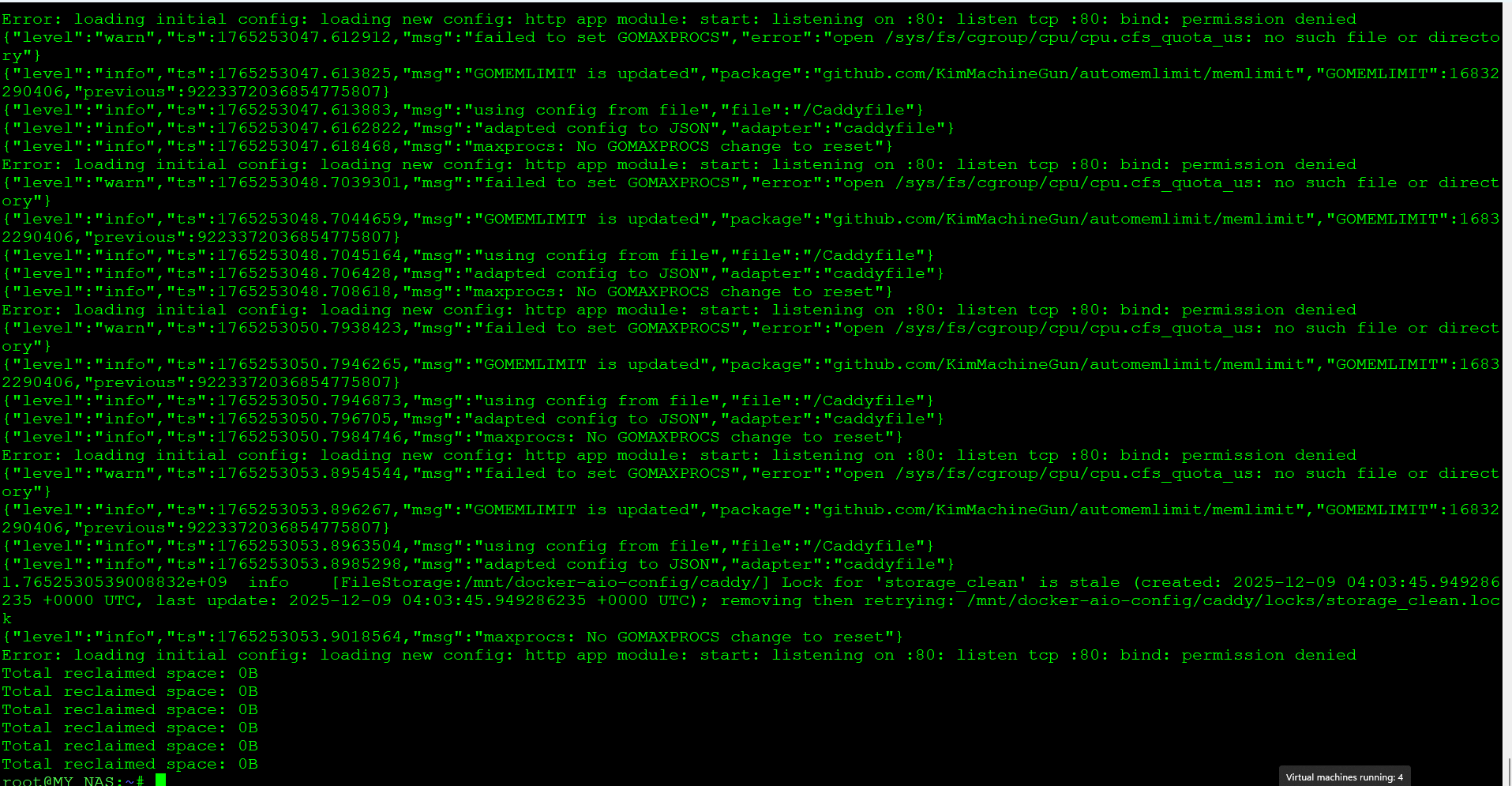

Hm… Can you post the output of sudo docker logs nextcloud-aio-mastercontainer here?
r
root@MY_NAS:/mnt# docker exec nextcloud-aio-mastercontainer bash -x /healthcheck.sh
  • ‘[’ -f /mnt/docker-aio-config/data/configuration.json ‘]’
  • nc -z 127.0.0.1 80
  • exit 1
    root@MY_NAS:/mnt#

I still need the output of sudo docker logs nextcloud-aio-mastercontainer
Sorry, here you are;

It looks like you run a kernel below 4.11 which would explain the behaviour: Apache cannot start because listen tcp :443: bind: permission denied · nextcloud/all-in-one · Discussion #1267 · GitHub
