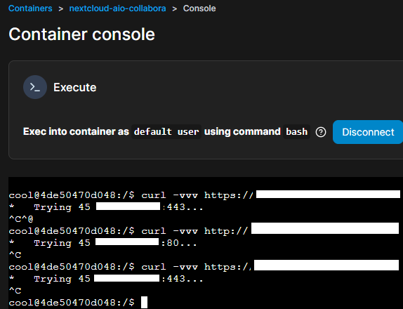

However, my nextcloud containers seems to be ignoring it, and always resolving to my external IP. (45.###.###.###).
This makes it so that for example collabora does not work.
This example query is from the collabora container, though others have the same issue.
For me this looks like a.i.o. is ignoring my hosts dns settings, as other container on the same host do resolve it correctly.
I am however able to access nextcloud itself. So the containers are reachable. They just don’t use the correct dns settings.

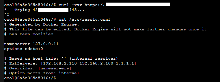

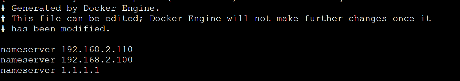

A test container reports the expected values:

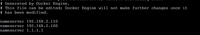

Even worse:
This is the output of /etc/resolv.conf in the collabora container.
In the commented ExtServers the expected nameservers are listed.
