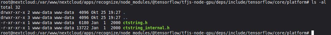

There are files from the Recognize app dated January 1, 2000. Nextcloud didn’t even exist back then.
All files for which there are no write permissions come from the recognize app.
