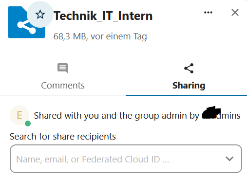

All folders are created trough the local admin account and shared with the users:
grafik
If using the forementioned admin account we can search trough all the files:
If using another account from the admin group we can only find files from the folders shared only with the admin group:
grafik
If using a normal user account the search doesn’t return anything:
