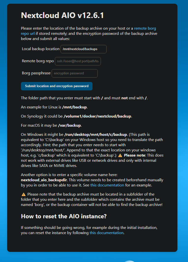

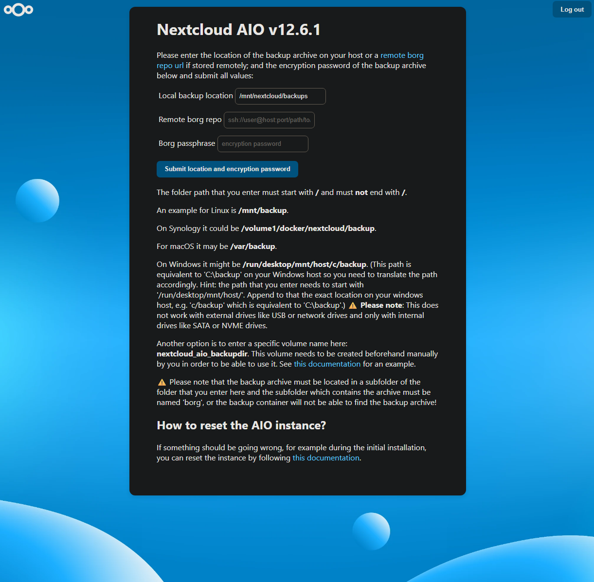

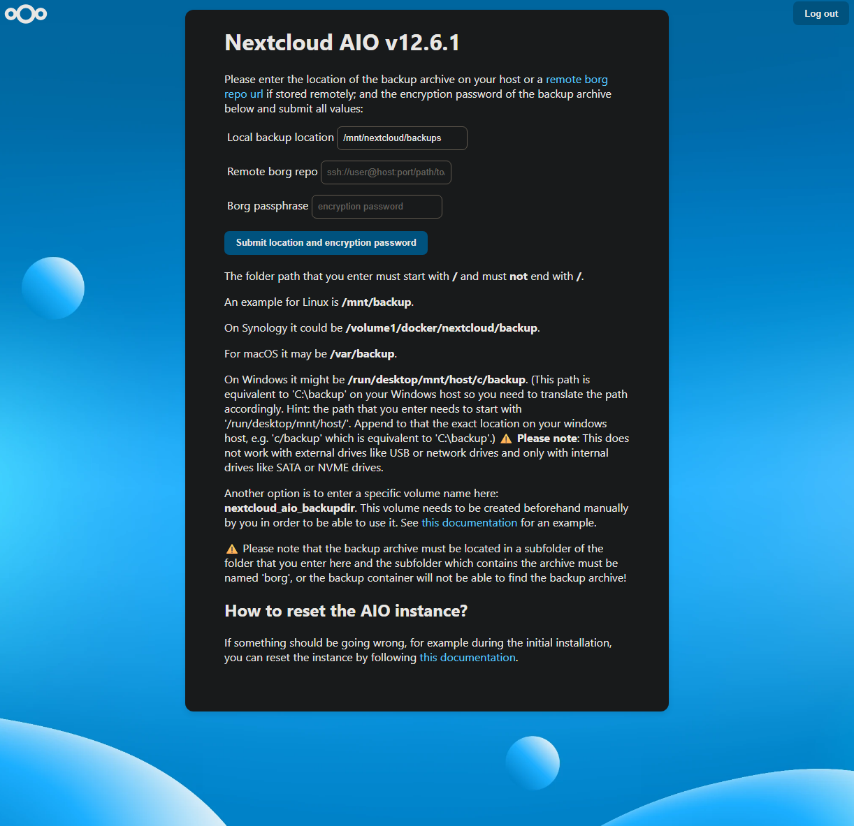

However, after starting up the mastercontainer again, it requires a different AIO passphrase, which I got from the container via this command:
 docker exec nextcloud-aio-mastercontainer grep password /mnt/docker-aio-config/data/configuration.json
Then when I logged in, it asked me to either create a new instance or to restore from backup. I tried to restore, it found the backups fine, and I had saved the password so it all worked. I verified the backup and then restored. But after it was done restoring, it just showed me the same “Restore Backup“ screen I previously filled out. I’ve tried restarting the container, the system, and just continuing to restore from backup. It doesn’t ever get past this. Maybe I am doing something wrong. The backup was made with AIO v12.5.1, and the update changed it to 12.6.1. I assumed I’d be able to restore just fine, but it seems like either I messed up the process or misconfigured something. I do have a snapshot of the VM from just before updating as well, so I can revert back to the old version, but I can’t actually start Nextcloud AIO v12.5.1, as the only button available for the services is the update button.
  1. Create NextCloud instance with AIO v12.5.1
  2. Do some configuration (e.g. Oauth, users, Talk, HPB, etc.)
  3. Make a backup via AIO v12.5.1
  4. Update from v12.5.1 to v12.6.1
  5. Try to restore backup with saved backup key and local directory

Ok thanks! And after you went though the restore process nothing happens?
Can you post a screenshot of what you are seeing in the AIO interface after you restored a backup and reloaded the aio interface?
After the restore completes, it brings me back to this page:
The same thing happens when I repeatedly do restores as well.
Hm… after another restore attempt, can you try to restart the mastercontainer via sudo docker restart nextcloud-aio-mastercontainer and check if that makes a difference?
After doing another restore and then going back to the web itnerface, it brings me to the same restore page:
