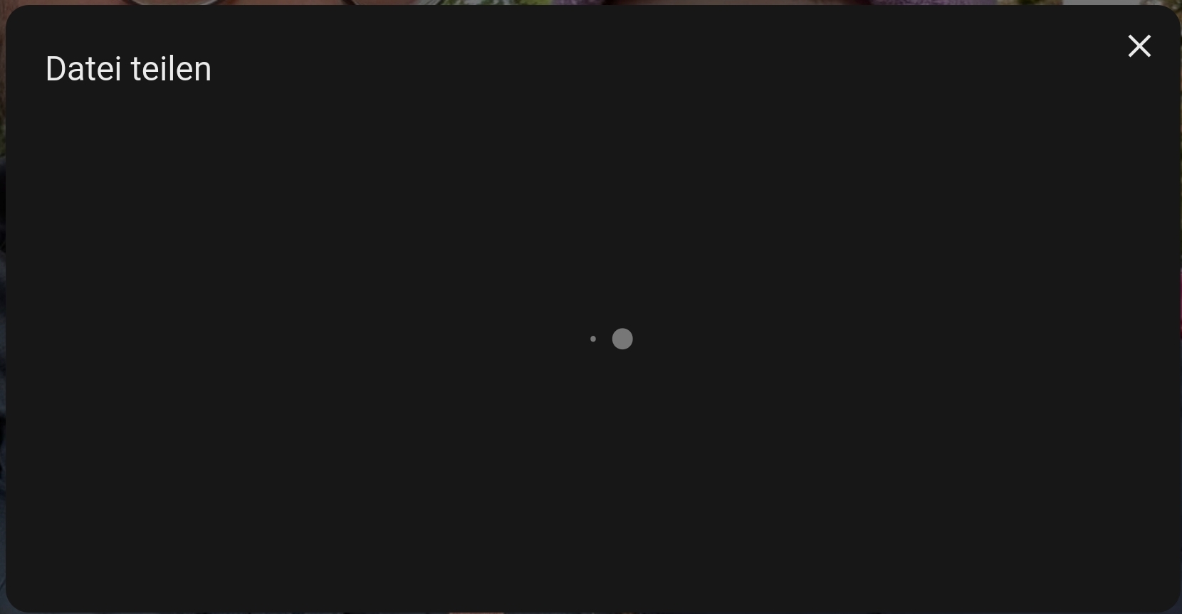

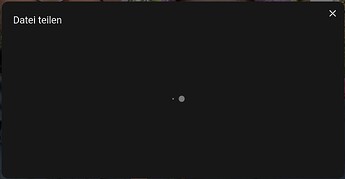

The problem: When I try to share a pic in the Android app, all that show’s up is a little window that says “Datei teilen” (“share file”) and three moving dots - no matter which sharing options I chose (low res, high res, original file):

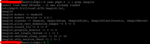

The php module imagick is, as stated above, enabled (the error in the administrator overview does not show up anymore):

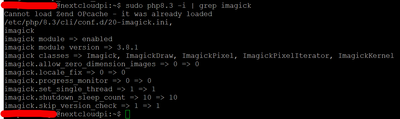

NextcloudPi 1.58 supports nc server up to v.33.x and php up to v.8.3.x.
You state running php8.4, your picture shows php8.3. Do you have a mixed up php setup?

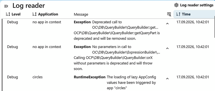

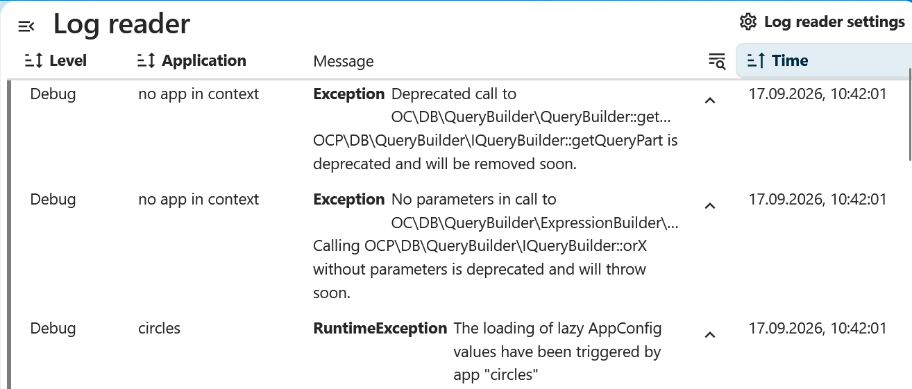

(1) According to the time code, this would be the entries triggered by an attempt to share a pic:
But I need to say that I do not know what to look for.
(2) Unfortunately I do not know where I would find the Memories log
That’s the php version:
In the OP screenshot it says “php8.3”, because in the post as linked above the user jtr mentioned to install php8.3-imagick instead of just php-imagick (with which it did not work). With php8.3-imagick, Imagick it did finally work though and the error “The PHP module ‘imagick’ is not enabled” finally disappeared
Maybe there is a php.8.4-imagick you could try?
Indeed there is, but only with php8.3-imagick it works (not with php-imagick nor php8.4-imagick, I had tested either)

By sharing I mean e.g. to share a photo from the Memories gallery to another person via messenger. That does not work, only three dots show up.
(I do use the NC Android app for uploading photos from my devices to my Nextcloud or syncing; that is not what I refer to as sharing.)
