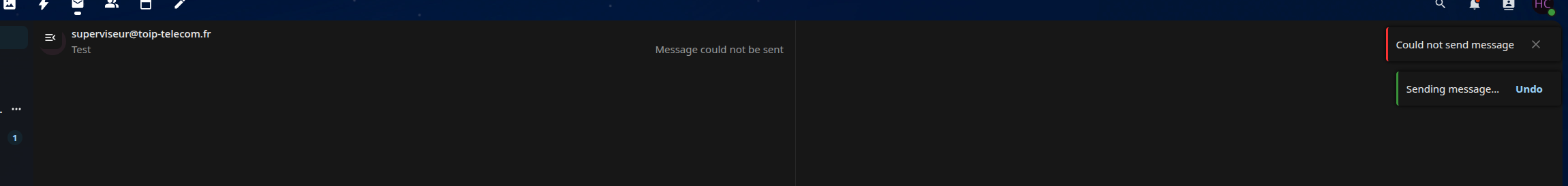

Hello,
We have installed Nextcloud on a Docker container and are experiencing an issue where emails are not being sent from Nextcloud to the Postfix server when using the mail application. However, when sending from the administration options, the email is sent successfully.
In debug mode, we don’t see any logs when it doesn’t work. And when it works with the admin option, we can see the application.

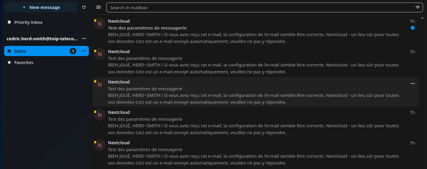

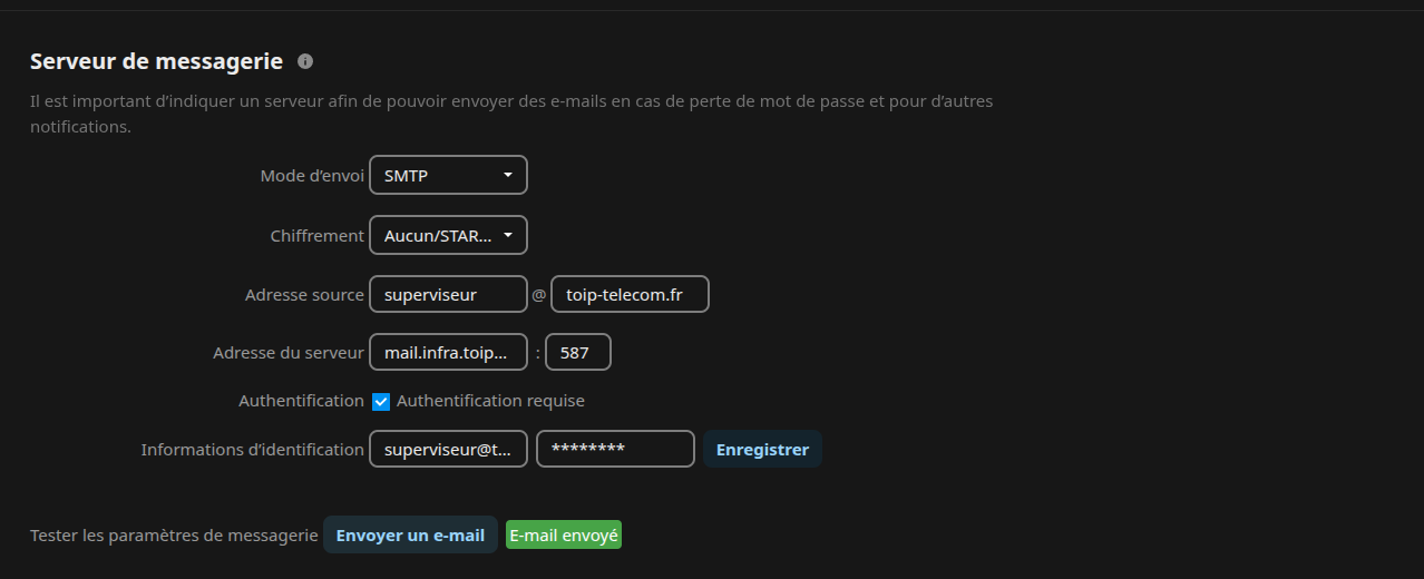

The admin account is functional and emails are received in the mailbox:

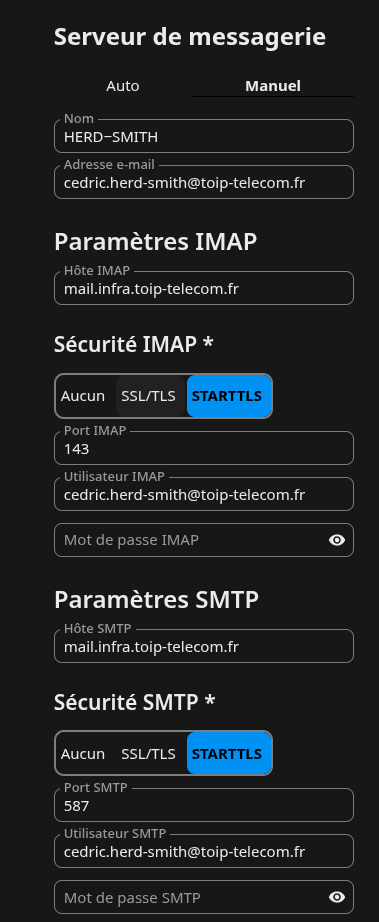

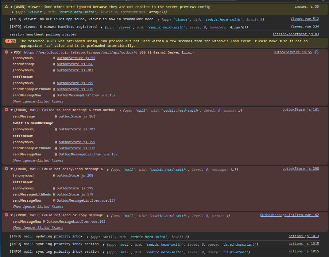

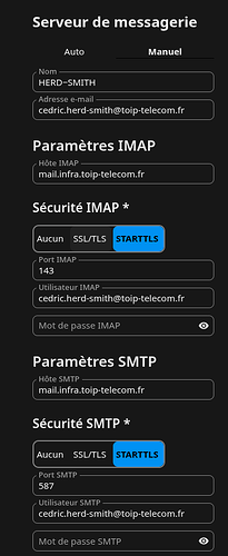

On an account, the mail application fails:

This time, I thank you for your help
It looks like SMTP is working from the admin panel, but not from the Mail app. The Mail app in Nextcloud doesn’t use the config.php SMTP settings—it connects directly to the user’s mail server (IMAP/SMTP). Make sure the affected user has correctly configured their mailbox in the Mail app (incoming/outgoing server, port, username, and password). Also verify that the user’s credentials are valid and that the mail server allows access. If no logs appear, enable app.mail.debug in the config and check both Nextcloud and Docker container logs for errors. Let me know if you’d like help debugging that.

We did a clean install with just active mail and the necessary ssl configuration.
The logs when I send the email:
{"reqId":"T43Uh2FXltHXTeUUm9UQ","level":0,"time":"2025-07-04T07:46:57+00:00","remoteAddr":"10.0.0.1","user":"superviseur","app":"no app in context","method":"PUT","url":"/apps/mail/api/outbox/1","message":"OCA\\Mail\\Controller\\OutboxController::update uses the @NoAdminRequired annotation and should use the #[OCP\\AppFramework\\Http\\Attribute\\NoAdminRequired] attribute instead","userAgent":"Mozilla/5.0 (X11; Linux x86_64) AppleWebKit/537.36 (KHTML, like Gecko) Chrome/138.0.0.0 Safari/537.36","version":"31.0.6.2","data":[]}
{"reqId":"HrB2NSToOeE9RVucprJT","level":0,"time":"2025-07-04T07:46:59+00:00","remoteAddr":"10.0.0.1","user":"superviseur","app":"no app in context","method":"PUT","url":"/apps/mail/api/outbox/1","message":"OCA\\Mail\\Controller\\OutboxController::update uses the @NoAdminRequired annotation and should use the #[OCP\\AppFramework\\Http\\Attribute\\NoAdminRequired] attribute instead","userAgent":"Mozilla/5.0 (X11; Linux x86_64) AppleWebKit/537.36 (KHTML, like Gecko) Chrome/138.0.0.0 Safari/537.36","version":"31.0.6.2","data":[]}
{"reqId":"4snBwnHaIFoPyTuauG91","level":0,"time":"2025-07-04T07:47:09+00:00","remoteAddr":"10.0.0.1","user":"superviseur","app":"no app in context","method":"GET","url":"/apps/mail/api/messages?mailboxId=1&limit=20","message":"OCA\\Mail\\Controller\\MessagesController::index uses the @NoAdminRequired annotation and should use the #[OCP\\AppFramework\\Http\\Attribute\\NoAdminRequired] attribute instead","userAgent":"Mozilla/5.0 (X11; Linux x86_64) AppleWebKit/537.36 (KHTML, like Gecko) Chrome/138.0.0.0 Safari/537.36","version":"31.0.6.2","data":[]}
{"reqId":"4snBwnHaIFoPyTuauG91","level":0,"time":"2025-07-04T07:47:09+00:00","remoteAddr":"10.0.0.1","user":"superviseur","app":"mail","method":"GET","url":"/apps/mail/api/messages?mailboxId=1&limit=20","message":"loading messages of mailbox <1>","userAgent":"Mozilla/5.0 (X11; Linux x86_64) AppleWebKit/537.36 (KHTML, like Gecko) Chrome/138.0.0.0 Safari/537.36","version":"31.0.6.2","data":{"app":"mail"}}
{"reqId":"GrCDgtF8R21gY6JQzeX1","level":0,"time":"2025-07-04T07:47:09+00:00","remoteAddr":"10.0.0.1","user":"superviseur","app":"no app in context","method":"POST","url":"/apps/mail/api/mailboxes/1/sync","message":"OCA\\Mail\\Controller\\MailboxesController::sync uses the @NoAdminRequired annotation and should use the #[OCP\\AppFramework\\Http\\Attribute\\NoAdminRequired] attribute instead","userAgent":"Mozilla/5.0 (X11; Linux x86_64) AppleWebKit/537.36 (KHTML, like Gecko) Chrome/138.0.0.0 Safari/537.36","version":"31.0.6.2","data":[]}
{"reqId":"GrCDgtF8R21gY6JQzeX1","level":0,"time":"2025-07-04T07:47:09+00:00","remoteAddr":"10.0.0.1","user":"superviseur","app":"mail","method":"POST","url":"/apps/mail/api/mailboxes/1/sync","message":"Forcing full sync due to QRESYNC","userAgent":"Mozilla/5.0 (X11; Linux x86_64) AppleWebKit/537.36 (KHTML, like Gecko) Chrome/138.0.0.0 Safari/537.36","version":"31.0.6.2","data":{"app":"mail"}}
{"reqId":"GrCDgtF8R21gY6JQzeX1","level":0,"time":"2025-07-04T07:47:09+00:00","remoteAddr":"10.0.0.1","user":"superviseur","app":"mail","method":"POST","url":"/apps/mail/api/mailboxes/1/sync","message":"Locking mailbox 1 for new messages sync","userAgent":"Mozilla/5.0 (X11; Linux x86_64) AppleWebKit/537.36 (KHTML, like Gecko) Chrome/138.0.0.0 Safari/537.36","version":"31.0.6.2","data":{"app":"mail"}}
{"reqId":"GrCDgtF8R21gY6JQzeX1","level":0,"time":"2025-07-04T07:47:09+00:00","remoteAddr":"10.0.0.1","user":"superviseur","app":"mail","method":"POST","url":"/apps/mail/api/mailboxes/1/sync","message":"Locking mailbox 1 for changed messages sync","userAgent":"Mozilla/5.0 (X11; Linux x86_64) AppleWebKit/537.36 (KHTML, like Gecko) Chrome/138.0.0.0 Safari/537.36","version":"31.0.6.2","data":{"app":"mail"}}
{"reqId":"GrCDgtF8R21gY6JQzeX1","level":0,"time":"2025-07-04T07:47:09+00:00","remoteAddr":"10.0.0.1","user":"superviseur","app":"mail","method":"POST","url":"/apps/mail/api/mailboxes/1/sync","message":"Locking mailbox 1 for vanished messages sync","userAgent":"Mozilla/5.0 (X11; Linux x86_64) AppleWebKit/537.36 (KHTML, like Gecko) Chrome/138.0.0.0 Safari/537.36","version":"31.0.6.2","data":{"app":"mail"}}
{"reqId":"GrCDgtF8R21gY6JQzeX1","level":0,"time":"2025-07-04T07:47:09+00:00","remoteAddr":"10.0.0.1","user":"superviseur","app":"mail","method":"POST","url":"/apps/mail/api/mailboxes/1/sync","message":"Running partial sync for 1","userAgent":"Mozilla/5.0 (X11; Linux x86_64) AppleWebKit/537.36 (KHTML, like Gecko) Chrome/138.0.0.0 Safari/537.36","version":"31.0.6.2","data":{"app":"mail"}}
{"reqId":"GrCDgtF8R21gY6JQzeX1","level":0,"time":"2025-07-04T07:47:09+00:00","remoteAddr":"10.0.0.1","user":"superviseur","app":"mail","method":"POST","url":"/apps/mail/api/mailboxes/1/sync","message":"partial sync 1:INBOX - get all known UIDs took 0s. 5/5MB memory used","userAgent":"Mozilla/5.0 (X11; Linux x86_64) AppleWebKit/537.36 (KHTML, like Gecko) Chrome/138.0.0.0 Safari/537.36","version":"31.0.6.2","data":{"app":"mail"}}
{"reqId":"GrCDgtF8R21gY6JQzeX1","level":0,"time":"2025-07-04T07:47:09+00:00","remoteAddr":"10.0.0.1","user":"superviseur","app":"no app in context","method":"POST","url":"/apps/mail/api/mailboxes/1/sync","message":"dirty table reads: SELECT * FROM `*PREFIX*mail_mailboxes` WHERE (`account_id` = :dcValue1) AND (`name_hash` = :dcValue2)","userAgent":"Mozilla/5.0 (X11; Linux x86_64) AppleWebKit/537.36 (KHTML, like Gecko) Chrome/138.0.0.0 Safari/537.36","version":"31.0.6.2","exception":{"Exception":"Exception","Message":"dirty table reads: SELECT * FROM `*PREFIX*mail_mailboxes` WHERE (`account_id` = :dcValue1) AND (`name_hash` = :dcValue2)","Code":0,"Trace":[{"file":"/var/www/html/lib/private/DB/ConnectionAdapter.php","line":50,"function":"executeQuery","class":"OC\\DB\\Connection","type":"->","args":["SELECT * FROM `*PREFIX*mail_mailboxes` WHERE (`account_id` = :dcValue1) AND (`name_hash` = :dcValue2)",{"dcValue1":"*** sensitive parameters replaced ***","dcValue2":"7e33429f656f1e6e9d79b29c3f82c57e"},{"dcValue1":2,"dcValue2":2}]},{"file":"/var/www/html/lib/private/DB/QueryBuilder/QueryBuilder.php","line":289,"function":"executeQuery","class":"OC\\DB\\ConnectionAdapter","type":"->","args":["SELECT * FROM `*PREFIX*mail_mailboxes` WHERE (`account_id` = :dcValue1) AND (`name_hash` = :dcValue2)",{"dcValue1":"*** sensitive parameters replaced ***","dcValue2":"7e33429f656f1e6e9d79b29c3f82c57e"},{"dcValue1":2,"dcValue2":2}]},{"file":"/var/www/html/lib/public/AppFramework/Db/QBMapper.php","line":269,"function":"executeQuery","class":"OC\\DB\\QueryBuilder\\QueryBuilder","type":"->","args":[]},{"file":"/var/www/html/lib/public/AppFramework/Db/QBMapper.php","line":375,"function":"findOneQuery","class":"OCP\\AppFramework\\Db\\QBMapper","type":"->","args":[{"__class__":"OC\\DB\\QueryBuilder\\QueryBuilder"}]},{"file":"/var/www/html/custom_apps/mail/lib/Db/MailboxMapper.php","line":83,"function":"findEntity","class":"OCP\\AppFramework\\Db\\QBMapper","type":"->","args":[{"__class__":"OC\\DB\\QueryBuilder\\QueryBuilder"}]},{"file":"/var/www/html/custom_apps/mail/lib/Cache/Cache.php","line":85,"function":"find","class":"OCA\\Mail\\Db\\MailboxMapper","type":"->","args":["*** sensitive parameters replaced ***","INBOX"]},{"file":"/var/www/html/custom_apps/mail/vendor/bytestream/horde-imap-client/lib/Horde/Imap/Client/Cache.php","line":172,"function":"getMetaData","class":"OCA\\Mail\\Cache\\Cache","type":"->","args":["INBOX","*** sensitive parameters replaced ***",["_m","uidvalid"]]},{"file":"/var/www/html/custom_apps/mail/vendor/bytestream/horde-imap-client/lib/Horde/Imap/Client/Socket.php","line":1178,"function":"getMetaData","class":"Horde_Imap_Client_Cache","type":"->","args":["*** sensitive parameters replaced ***","*** sensitive parameters replaced ***",["_m","uidvalid"]]},{"file":"/var/www/html/custom_apps/mail/vendor/bytestream/horde-imap-client/lib/Horde/Imap/Client/Base.php","line":1066,"function":"_openMailbox","class":"Horde_Imap_Client_Socket","type":"->","args":["*** sensitive parameters replaced ***","*** sensitive parameters replaced ***"]},{"file":"/var/www/html/custom_apps/mail/vendor/bytestream/horde-imap-client/lib/Horde/Imap/Client/Base.php","line":1701,"function":"openMailbox","class":"Horde_Imap_Client_Base","type":"->","args":["*** sensitive parameters replaced ***"]},{"file":"/var/www/html/custom_apps/mail/vendor/bytestream/horde-imap-client/lib/Horde/Imap/Client/Data/Sync.php","line":199,"function":"status","class":"Horde_Imap_Client_Base","type":"->","args":[["*** sensitive parameters replaced ***"],19456]},{"file":"/var/www/html/custom_apps/mail/vendor/bytestream/horde-imap-client/lib/Horde/Imap/Client/Base.php","line":3643,"function":"__construct","class":"Horde_Imap_Client_Data_Sync","type":"->","args":["*** sensitive parameters replaced ***","*** sensitive parameters replaced ***",{"U":"1","V":"1751614368","H":"1"},{"U":"*** sensitive parameters replaced ***","V":1751614368,"H":"*** sensitive parameters replaced ***"},64,"*** sensitive parameters replaced ***"]},{"file":"/var/www/html/custom_apps/mail/lib/IMAP/Sync/Synchronizer.php","line":99,"function":"sync","class":"Horde_Imap_Client_Base","type":"->","args":["*** sensitive parameters replaced ***"]},{"file":"/var/www/html/custom_apps/mail/lib/IMAP/Sync/Synchronizer.php","line":69,"function":"doCombinedSync","class":"OCA\\Mail\\IMAP\\Sync\\Synchronizer","type":"->","args":["*** sensitive parameters replaced ***","*** sensitive parameters replaced ***","*** sensitive parameters replaced ***"]},{"file":"/var/www/html/custom_apps/mail/lib/Service/Sync/ImapToDbSynchronizer.php","line":401,"function":"sync","class":"OCA\\Mail\\IMAP\\Sync\\Synchronizer","type":"->","args":["*** sensitive parameters replaced ***"]},{"file":"/var/www/html/custom_apps/mail/lib/Service/Sync/ImapToDbSynchronizer.php","line":263,"function":"runPartialSync","class":"OCA\\Mail\\Service\\Sync\\ImapToDbSynchronizer","type":"->","args":["*** sensitive parameters replaced ***","*** sensitive parameters replaced ***","*** sensitive parameters replaced ***","*** sensitive parameters replaced ***","*** sensitive parameters replaced ***","*** sensitive parameters replaced ***","*** sensitive parameters replaced ***"]},{"file":"/var/www/html/custom_apps/mail/lib/Service/Sync/SyncService.php","line":126,"function":"sync","class":"OCA\\Mail\\Service\\Sync\\ImapToDbSynchronizer","type":"->","args":["*** sensitive parameters replaced ***"]},{"file":"/var/www/html/custom_apps/mail/lib/Controller/MailboxesController.php","line":144,"function":"syncMailbox","class":"OCA\\Mail\\Service\\Sync\\SyncService","type":"->","args":["*** sensitive parameters replaced ***"]},{"file":"/var/www/html/lib/private/AppFramework/Http/Dispatcher.php","line":200,"function":"sync","class":"OCA\\Mail\\Controller\\MailboxesController","type":"->","args":["*** sensitive parameters replaced ***"]},{"file":"/var/www/html/lib/private/AppFramework/Http/Dispatcher.php","line":114,"function":"executeController","class":"OC\\AppFramework\\Http\\Dispatcher","type":"->","args":[{"__class__":"OCA\\Mail\\Controller\\MailboxesController"},"sync"]},{"file":"/var/www/html/lib/private/AppFramework/App.php","line":161,"function":"dispatch","class":"OC\\AppFramework\\Http\\Dispatcher","type":"->","args":[{"__class__":"OCA\\Mail\\Controller\\MailboxesController"},"sync"]},{"file":"/var/www/html/lib/private/Route/Router.php","line":307,"function":"main","class":"OC\\AppFramework\\App","type":"::","args":["OCA\\Mail\\Controller\\MailboxesController","sync",{"__class__":"OC\\AppFramework\\DependencyInjection\\DIContainer"},{"id":"1","_route":"mail.mailboxes.sync"}]},{"file":"/var/www/html/lib/base.php","line":1040,"function":"match","class":"OC\\Route\\Router","type":"->","args":["/apps/mail/api/mailboxes/1/sync"]},{"file":"/var/www/html/index.php","line":24,"function":"handleRequest","class":"OC","type":"::","args":[]}],"File":"/var/www/html/lib/private/DB/Connection.php","Line":406,"message":"dirty table reads: SELECT * FROM `*PREFIX*mail_mailboxes` WHERE (`account_id` = :dcValue1) AND (`name_hash` = :dcValue2)","tables":["oc_mail_mailboxes"],"reads":["oc_mail_mailboxes"],"exception":{},"CustomMessage":"dirty table reads: SELECT * FROM `*PREFIX*mail_mailboxes` WHERE (`account_id` = :dcValue1) AND (`name_hash` = :dcValue2)"}}
{"reqId":"GrCDgtF8R21gY6JQzeX1","level":0,"time":"2025-07-04T07:47:09+00:00","remoteAddr":"10.0.0.1","user":"superviseur","app":"no app in context","method":"POST","url":"/apps/mail/api/mailboxes/1/sync","message":"dirty table reads: SELECT * FROM `*PREFIX*mail_mailboxes` WHERE (`account_id` = :dcValue1) AND (`name_hash` = :dcValue2)","userAgent":"Mozilla/5.0 (X11; Linux x86_64) AppleWebKit/537.36 (KHTML, like Gecko) Chrome/138.0.0.0 Safari/537.36","version":"31.0.6.2","exception":{"Exception":"Exception","Message":"dirty table reads: SELECT * FROM `*PREFIX*mail_mailboxes` WHERE (`account_id` = :dcValue1) AND (`name_hash` = :dcValue2)","Code":0,"Trace":[{"file":"/var/www/html/lib/private/DB/ConnectionAdapter.php","line":50,"function":"executeQuery","class":"OC\\DB\\Connection","type":"->","args":["SELECT * FROM `*PREFIX*mail_mailboxes` WHERE (`account_id` = :dcValue1) AND (`name_hash` = :dcValue2)",{"dcValue1":"*** sensitive parameters replaced ***","dcValue2":"7e33429f656f1e6e9d79b29c3f82c57e"},{"dcValue1":2,"dcValue2":2}]},{"file":"/var/www/html/lib/private/DB/QueryBuilder/QueryBuilder.php","line":289,"function":"executeQuery","class":"OC\\DB\\ConnectionAdapter","type":"->","args":["SELECT * FROM `*PREFIX*mail_mailboxes` WHERE (`account_id` = :dcValue1) AND (`name_hash` = :dcValue2)",{"dcValue1":"*** sensitive parameters replaced ***","dcValue2":"7e33429f656f1e6e9d79b29c3f82c57e"},{"dcValue1":2,"dcValue2":2}]},{"file":"/var/www/html/lib/public/AppFramework/Db/QBMapper.php","line":269,"function":"executeQuery","class":"OC\\DB\\QueryBuilder\\QueryBuilder","type":"->","args":[]},{"file":"/var/www/html/lib/public/AppFramework/Db/QBMapper.php","line":375,"function":"findOneQuery","class":"OCP\\AppFramework\\Db\\QBMapper","type":"->","args":[{"__class__":"OC\\DB\\QueryBuilder\\QueryBuilder"}]},{"file":"/var/www/html/custom_apps/mail/lib/Db/MailboxMapper.php","line":83,"function":"findEntity","class":"OCP\\AppFramework\\Db\\QBMapper","type":"->","args":[{"__class__":"OC\\DB\\QueryBuilder\\QueryBuilder"}]},{"file":"/var/www/html/custom_apps/mail/lib/Cache/Cache.php","line":64,"function":"find","class":"OCA\\Mail\\Db\\MailboxMapper","type":"->","args":["*** sensitive parameters replaced ***","INBOX"]},{"file":"/var/www/html/custom_apps/mail/vendor/bytestream/horde-imap-client/lib/Horde/Imap/Client/Cache.php","line":110,"function":"getCachedUids","class":"OCA\\Mail\\Cache\\Cache","type":"->","args":["INBOX","*** sensitive parameters replaced ***"]},{"file":"/var/www/html/custom_apps/mail/vendor/bytestream/horde-imap-client/lib/Horde/Imap/Client/Socket.php","line":1182,"function":"get","class":"Horde_Imap_Client_Cache","type":"->","args":["INBOX"]},{"file":"/var/www/html/custom_apps/mail/vendor/bytestream/horde-imap-client/lib/Horde/Imap/Client/Base.php","line":1066,"function":"_openMailbox","class":"Horde_Imap_Client_Socket","type":"->","args":["*** sensitive parameters replaced ***","*** sensitive parameters replaced ***"]},{"file":"/var/www/html/custom_apps/mail/vendor/bytestream/horde-imap-client/lib/Horde/Imap/Client/Base.php","line":1701,"function":"openMailbox","class":"Horde_Imap_Client_Base","type":"->","args":["*** sensitive parameters replaced ***"]},{"file":"/var/www/html/custom_apps/mail/vendor/bytestream/horde-imap-client/lib/Horde/Imap/Client/Data/Sync.php","line":199,"function":"status","class":"Horde_Imap_Client_Base","type":"->","args":[["*** sensitive parameters replaced ***"],19456]},{"file":"/var/www/html/custom_apps/mail/vendor/bytestream/horde-imap-client/lib/Horde/Imap/Client/Base.php","line":3643,"function":"__construct","class":"Horde_Imap_Client_Data_Sync","type":"->","args":["*** sensitive parameters replaced ***","*** sensitive parameters replaced ***",{"U":"1","V":"1751614368","H":"1"},{"U":"*** sensitive parameters replaced ***","V":1751614368,"H":"*** sensitive parameters replaced ***"},64,"*** sensitive parameters replaced ***"]},{"file":"/var/www/html/custom_apps/mail/lib/IMAP/Sync/Synchronizer.php","line":99,"function":"sync","class":"Horde_Imap_Client_Base","type":"->","args":["*** sensitive parameters replaced ***"]},{"file":"/var/www/html/custom_apps/mail/lib/IMAP/Sync/Synchronizer.php","line":69,"function":"doCombinedSync","class":"OCA\\Mail\\IMAP\\Sync\\Synchronizer","type":"->","args":["*** sensitive parameters replaced ***","*** sensitive parameters replaced ***","*** sensitive parameters replaced ***"]},{"file":"/var/www/html/custom_apps/mail/lib/Service/Sync/ImapToDbSynchronizer.php","line":401,"function":"sync","class":"OCA\\Mail\\IMAP\\Sync\\Synchronizer","type":"->","args":["*** sensitive parameters replaced ***"]},{"file":"/var/www/html/custom_apps/mail/lib/Service/Sync/ImapToDbSynchronizer.php","line":263,"function":"runPartialSync","class":"OCA\\Mail\\Service\\Sync\\ImapToDbSynchronizer","type":"->","args":["*** sensitive parameters replaced ***","*** sensitive parameters replaced ***","*** sensitive parameters replaced ***","*** sensitive parameters replaced ***","*** sensitive parameters replaced ***","*** sensitive parameters replaced ***","*** sensitive parameters replaced ***"]},{"file":"/var/www/html/custom_apps/mail/lib/Service/Sync/SyncService.php","line":126,"function":"sync","class":"OCA\\Mail\\Service\\Sync\\ImapToDbSynchronizer","type":"->","args":["*** sensitive parameters replaced ***"]},{"file":"/var/www/html/custom_apps/mail/lib/Controller/MailboxesController.php","line":144,"function":"syncMailbox","class":"OCA\\Mail\\Service\\Sync\\SyncService","type":"->","args":["*** sensitive parameters replaced ***"]},{"file":"/var/www/html/lib/private/AppFramework/Http/Dispatcher.php","line":200,"function":"sync","class":"OCA\\Mail\\Controller\\MailboxesController","type":"->","args":["*** sensitive parameters replaced ***"]},{"file":"/var/www/html/lib/private/AppFramework/Http/Dispatcher.php","line":114,"function":"executeController","class":"OC\\AppFramework\\Http\\Dispatcher","type":"->","args":[{"__class__":"OCA\\Mail\\Controller\\MailboxesController"},"sync"]},{"file":"/var/www/html/lib/private/AppFramework/App.php","line":161,"function":"dispatch","class":"OC\\AppFramework\\Http\\Dispatcher","type":"->","args":[{"__class__":"OCA\\Mail\\Controller\\MailboxesController"},"sync"]},{"file":"/var/www/html/lib/private/Route/Router.php","line":307,"function":"main","class":"OC\\AppFramework\\App","type":"::","args":["OCA\\Mail\\Controller\\MailboxesController","sync",{"__class__":"OC\\AppFramework\\DependencyInjection\\DIContainer"},{"id":"1","_route":"mail.mailboxes.sync"}]},{"file":"/var/www/html/lib/base.php","line":1040,"function":"match","class":"OC\\Route\\Router","type":"->","args":["/apps/mail/api/mailboxes/1/sync"]},{"file":"/var/www/html/index.php","line":24,"function":"handleRequest","class":"OC","type":"::","args":[]}],"File":"/var/www/html/lib/private/DB/Connection.php","Line":406,"message":"dirty table reads: SELECT * FROM `*PREFIX*mail_mailboxes` WHERE (`account_id` = :dcValue1) AND (`name_hash` = :dcValue2)","tables":["oc_mail_mailboxes"],"reads":["oc_mail_mailboxes"],"exception":{},"CustomMessage":"dirty table reads: SELECT * FROM `*PREFIX*mail_mailboxes` WHERE (`account_id` = :dcValue1) AND (`name_hash` = :dcValue2)"}}
{"reqId":"GrCDgtF8R21gY6JQzeX1","level":0,"time":"2025-07-04T07:47:09+00:00","remoteAddr":"10.0.0.1","user":"superviseur","app":"mail","method":"POST","url":"/apps/mail/api/mailboxes/1/sync","message":"findByIds in INBOX got 0 UIDs but found none","userAgent":"Mozilla/5.0 (X11; Linux x86_64) AppleWebKit/537.36 (KHTML, like Gecko) Chrome/138.0.0.0 Safari/537.36","version":"31.0.6.2","data":{"app":"mail"}}
{"reqId":"GrCDgtF8R21gY6JQzeX1","level":0,"time":"2025-07-04T07:47:09+00:00","remoteAddr":"10.0.0.1","user":"superviseur","app":"mail","method":"POST","url":"/apps/mail/api/mailboxes/1/sync","message":"partial sync 1:INBOX - get new messages via Horde took 0s. 5/5MB memory used","userAgent":"Mozilla/5.0 (X11; Linux x86_64) AppleWebKit/537.36 (KHTML, like Gecko) Chrome/138.0.0.0 Safari/537.36","version":"31.0.6.2","data":{"app":"mail"}}
{"reqId":"GrCDgtF8R21gY6JQzeX1","level":0,"time":"2025-07-04T07:47:09+00:00","remoteAddr":"10.0.0.1","user":"superviseur","app":"mail","method":"POST","url":"/apps/mail/api/mailboxes/1/sync","message":"partial sync 1:INBOX - persist new messages took 0s. 5/5MB memory used","userAgent":"Mozilla/5.0 (X11; Linux x86_64) AppleWebKit/537.36 (KHTML, like Gecko) Chrome/138.0.0.0 Safari/537.36","version":"31.0.6.2","data":{"app":"mail"}}
{"reqId":"GrCDgtF8R21gY6JQzeX1","level":0,"time":"2025-07-04T07:47:09+00:00","remoteAddr":"10.0.0.1","user":"superviseur","app":"mail","method":"POST","url":"/apps/mail/api/mailboxes/1/sync","message":"partial sync 1:INBOX - get changed messages via Horde took 0s. 5/5MB memory used","userAgent":"Mozilla/5.0 (X11; Linux x86_64) AppleWebKit/537.36 (KHTML, like Gecko) Chrome/138.0.0.0 Safari/537.36","version":"31.0.6.2","data":{"app":"mail"}}
{"reqId":"GrCDgtF8R21gY6JQzeX1","level":0,"time":"2025-07-04T07:47:09+00:00","remoteAddr":"10.0.0.1","user":"superviseur","app":"mail","method":"POST","url":"/apps/mail/api/mailboxes/1/sync","message":"partial sync 1:INBOX - persist changed messages took 0s. 5/5MB memory used","userAgent":"Mozilla/5.0 (X11; Linux x86_64) AppleWebKit/537.36 (KHTML, like Gecko) Chrome/138.0.0.0 Safari/537.36","version":"31.0.6.2","data":{"app":"mail"}}
{"reqId":"GrCDgtF8R21gY6JQzeX1","level":0,"time":"2025-07-04T07:47:09+00:00","remoteAddr":"10.0.0.1","user":"superviseur","app":"mail","method":"POST","url":"/apps/mail/api/mailboxes/1/sync","message":"partial sync 1:INBOX - get vanished messages via Horde took 0s. 5/5MB memory used","userAgent":"Mozilla/5.0 (X11; Linux x86_64) AppleWebKit/537.36 (KHTML, like Gecko) Chrome/138.0.0.0 Safari/537.36","version":"31.0.6.2","data":{"app":"mail"}}
{"reqId":"GrCDgtF8R21gY6JQzeX1","level":0,"time":"2025-07-04T07:47:09+00:00","remoteAddr":"10.0.0.1","user":"superviseur","app":"mail","method":"POST","url":"/apps/mail/api/mailboxes/1/sync","message":"partial sync 1:INBOX - delete vanished messages took 0s. 5/5MB memory used","userAgent":"Mozilla/5.0 (X11; Linux x86_64) AppleWebKit/537.36 (KHTML, like Gecko) Chrome/138.0.0.0 Safari/537.36","version":"31.0.6.2","data":{"app":"mail"}}
{"reqId":"GrCDgtF8R21gY6JQzeX1","level":0,"time":"2025-07-04T07:47:09+00:00","remoteAddr":"10.0.0.1","user":"superviseur","app":"mail","method":"POST","url":"/apps/mail/api/mailboxes/1/sync","message":"partial sync 1:INBOX took 0s","userAgent":"Mozilla/5.0 (X11; Linux x86_64) AppleWebKit/537.36 (KHTML, like Gecko) Chrome/138.0.0.0 Safari/537.36","version":"31.0.6.2","data":{"app":"mail"}}
{"reqId":"GrCDgtF8R21gY6JQzeX1","level":0,"time":"2025-07-04T07:47:09+00:00","remoteAddr":"10.0.0.1","user":"superviseur","app":"mail","method":"POST","url":"/apps/mail/api/mailboxes/1/sync","message":"Unlocking mailbox 1 from vanished messages sync","userAgent":"Mozilla/5.0 (X11; Linux x86_64) AppleWebKit/537.36 (KHTML, like Gecko) Chrome/138.0.0.0 Safari/537.36","version":"31.0.6.2","data":{"app":"mail"}}
{"reqId":"GrCDgtF8R21gY6JQzeX1","level":0,"time":"2025-07-04T07:47:09+00:00","remoteAddr":"10.0.0.1","user":"superviseur","app":"mail","method":"POST","url":"/apps/mail/api/mailboxes/1/sync","message":"Unlocking mailbox 1 from changed messages sync","userAgent":"Mozilla/5.0 (X11; Linux x86_64) AppleWebKit/537.36 (KHTML, like Gecko) Chrome/138.0.0.0 Safari/537.36","version":"31.0.6.2","data":{"app":"mail"}}
{"reqId":"GrCDgtF8R21gY6JQzeX1","level":0,"time":"2025-07-04T07:47:09+00:00","remoteAddr":"10.0.0.1","user":"superviseur","app":"mail","method":"POST","url":"/apps/mail/api/mailboxes/1/sync","message":"Unlocking mailbox 1 from new messages sync","userAgent":"Mozilla/5.0 (X11; Linux x86_64) AppleWebKit/537.36 (KHTML, like Gecko) Chrome/138.0.0.0 Safari/537.36","version":"31.0.6.2","data":{"app":"mail"}}
{"reqId":"GrCDgtF8R21gY6JQzeX1","level":0,"time":"2025-07-04T07:47:09+00:00","remoteAddr":"10.0.0.1","user":"superviseur","app":"mail","method":"POST","url":"/apps/mail/api/mailboxes/1/sync","message":"Skipping threading as there were no significant changes","userAgent":"Mozilla/5.0 (X11; Linux x86_64) AppleWebKit/537.36 (KHTML, like Gecko) Chrome/138.0.0.0 Safari/537.36","version":"31.0.6.2","data":{"app":"mail"}}
{"reqId":"xabuU1aehW3ha9aeAPcB","level":0,"time":"2025-07-04T07:47:09+00:00","remoteAddr":"10.0.0.1","user":"superviseur","app":"no app in context","method":"POST","url":"/apps/mail/api/outbox/1","message":"OCA\\Mail\\Controller\\OutboxController::send uses the @NoAdminRequired annotation and should use the #[OCP\\AppFramework\\Http\\Attribute\\NoAdminRequired] attribute instead","userAgent":"Mozilla/5.0 (X11; Linux x86_64) AppleWebKit/537.36 (KHTML, like Gecko) Chrome/138.0.0.0 Safari/537.36","version":"31.0.6.2","data":[]}
{"reqId":"9eBIOw0CRqNu9MS4ro7Z","level":0,"time":"2025-07-04T07:47:17+00:00","remoteAddr":"10.0.0.1","user":"superviseur","app":"no app in context","method":"GET","url":"/apps/mail/api/outbox","message":"OCA\\Mail\\Controller\\OutboxController::index uses the @NoAdminRequired annotation and should use the #[OCP\\AppFramework\\Http\\Attribute\\NoAdminRequired] attribute instead","userAgent":"Mozilla/5.0 (X11; Linux x86_64) AppleWebKit/537.36 (KHTML, like Gecko) Chrome/138.0.0.0 Safari/537.36","version":"31.0.6.2","data":[]}
{"reqId":"WbqkbQVzOjqjndtJMnHm","level":0,"time":"2025-07-04T07:47:39+00:00","remoteAddr":"10.0.0.1","user":"superviseur","app":"no app in context","method":"GET","url":"/apps/mail/api/messages?mailboxId=1&limit=20","message":"OCA\\Mail\\Controller\\MessagesController::index uses the @NoAdminRequired annotation and should use the #[OCP\\AppFramework\\Http\\Attribute\\NoAdminRequired] attribute instead","userAgent":"Mozilla/5.0 (X11; Linux x86_64) AppleWebKit/537.36 (KHTML, like Gecko) Chrome/138.0.0.0 Safari/537.36","version":"31.0.6.2","data":[]}
{"reqId":"WbqkbQVzOjqjndtJMnHm","level":0,"time":"2025-07-04T07:47:39+00:00","remoteAddr":"10.0.0.1","user":"superviseur","app":"mail","method":"GET","url":"/apps/mail/api/messages?mailboxId=1&limit=20","message":"loading messages of mailbox <1>","userAgent":"Mozilla/5.0 (X11; Linux x86_64) AppleWebKit/537.36 (KHTML, like Gecko) Chrome/138.0.0.0 Safari/537.36","version":"31.0.6.2","data":{"app":"mail"}}
{"reqId":"tgdBTSF8NVrPUQYuIpHp","level":0,"time":"2025-07-04T07:47:39+00:00","remoteAddr":"10.0.0.1","user":"superviseur","app":"no app in context","method":"POST","url":"/apps/mail/api/mailboxes/1/sync","message":"OCA\\Mail\\Controller\\MailboxesController::sync uses the @NoAdminRequired annotation and should use the #[OCP\\AppFramework\\Http\\Attribute\\NoAdminRequired] attribute instead","userAgent":"Mozilla/5.0 (X11; Linux x86_64) AppleWebKit/537.36 (KHTML, like Gecko) Chrome/138.0.0.0 Safari/537.36","version":"31.0.6.2","data":[]}
{"reqId":"tgdBTSF8NVrPUQYuIpHp","level":0,"time":"2025-07-04T07:47:39+00:00","remoteAddr":"10.0.0.1","user":"superviseur","app":"mail","method":"POST","url":"/apps/mail/api/mailboxes/1/sync","message":"Forcing full sync due to QRESYNC","userAgent":"Mozilla/5.0 (X11; Linux x86_64) AppleWebKit/537.36 (KHTML, like Gecko) Chrome/138.0.0.0 Safari/537.36","version":"31.0.6.2","data":{"app":"mail"}}
{"reqId":"tgdBTSF8NVrPUQYuIpHp","level":0,"time":"2025-07-04T07:47:39+00:00","remoteAddr":"10.0.0.1","user":"superviseur","app":"mail","method":"POST","url":"/apps/mail/api/mailboxes/1/sync","message":"Locking mailbox 1 for new messages sync","userAgent":"Mozilla/5.0 (X11; Linux x86_64) AppleWebKit/537.36 (KHTML, like Gecko) Chrome/138.0.0.0 Safari/537.36","version":"31.0.6.2","data":{"app":"mail"}}
{"reqId":"tgdBTSF8NVrPUQYuIpHp","level":0,"time":"2025-07-04T07:47:39+00:00","remoteAddr":"10.0.0.1","user":"superviseur","app":"mail","method":"POST","url":"/apps/mail/api/mailboxes/1/sync","message":"Locking mailbox 1 for changed messages sync","userAgent":"Mozilla/5.0 (X11; Linux x86_64) AppleWebKit/537.36 (KHTML, like Gecko) Chrome/138.0.0.0 Safari/537.36","version":"31.0.6.2","data":{"app":"mail"}}
{"reqId":"tgdBTSF8NVrPUQYuIpHp","level":0,"time":"2025-07-04T07:47:39+00:00","remoteAddr":"10.0.0.1","user":"superviseur","app":"mail","method":"POST","url":"/apps/mail/api/mailboxes/1/sync","message":"Locking mailbox 1 for vanished messages sync","userAgent":"Mozilla/5.0 (X11; Linux x86_64) AppleWebKit/537.36 (KHTML, like Gecko) Chrome/138.0.0.0 Safari/537.36","version":"31.0.6.2","data":{"app":"mail"}}
{"reqId":"tgdBTSF8NVrPUQYuIpHp","level":0,"time":"2025-07-04T07:47:39+00:00","remoteAddr":"10.0.0.1","user":"superviseur","app":"mail","method":"POST","url":"/apps/mail/api/mailboxes/1/sync","message":"Running partial sync for 1","userAgent":"Mozilla/5.0 (X11; Linux x86_64) AppleWebKit/537.36 (KHTML, like Gecko) Chrome/138.0.0.0 Safari/537.36","version":"31.0.6.2","data":{"app":"mail"}}
{"reqId":"tgdBTSF8NVrPUQYuIpHp","level":0,"time":"2025-07-04T07:47:39+00:00","remoteAddr":"10.0.0.1","user":"superviseur","app":"mail","method":"POST","url":"/apps/mail/api/mailboxes/1/sync","message":"partial sync 1:INBOX - get all known UIDs took 0s. 5/5MB memory used","userAgent":"Mozilla/5.0 (X11; Linux x86_64) AppleWebKit/537.36 (KHTML, like Gecko) Chrome/138.0.0.0 Safari/537.36","version":"31.0.6.2","data":{"app":"mail"}}
{"reqId":"tgdBTSF8NVrPUQYuIpHp","level":0,"time":"2025-07-04T07:47:39+00:00","remoteAddr":"10.0.0.1","user":"superviseur","app":"no app in context","method":"POST","url":"/apps/mail/api/mailboxes/1/sync","message":"dirty table reads: SELECT * FROM `*PREFIX*mail_mailboxes` WHERE (`account_id` = :dcValue1) AND (`name_hash` = :dcValue2)","userAgent":"Mozilla/5.0 (X11; Linux x86_64) AppleWebKit/537.36 (KHTML, like Gecko) Chrome/138.0.0.0 Safari/537.36","version":"31.0.6.2","exception":{"Exception":"Exception","Message":"dirty table reads: SELECT * FROM `*PREFIX*mail_mailboxes` WHERE (`account_id` = :dcValue1) AND (`name_hash` = :dcValue2)","Code":0,"Trace":[{"file":"/var/www/html/lib/private/DB/ConnectionAdapter.php","line":50,"function":"executeQuery","class":"OC\\DB\\Connection","type":"->","args":["SELECT * FROM `*PREFIX*mail_mailboxes` WHERE (`account_id` = :dcValue1) AND (`name_hash` = :dcValue2)",{"dcValue1":"*** sensitive parameters replaced ***","dcValue2":"7e33429f656f1e6e9d79b29c3f82c57e"},{"dcValue1":2,"dcValue2":2}]},{"file":"/var/www/html/lib/private/DB/QueryBuilder/QueryBuilder.php","line":289,"function":"executeQuery","class":"OC\\DB\\ConnectionAdapter","type":"->","args":["SELECT * FROM `*PREFIX*mail_mailboxes` WHERE (`account_id` = :dcValue1) AND (`name_hash` = :dcValue2)",{"dcValue1":"*** sensitive parameters replaced ***","dcValue2":"7e33429f656f1e6e9d79b29c3f82c57e"},{"dcValue1":2,"dcValue2":2}]},{"file":"/var/www/html/lib/public/AppFramework/Db/QBMapper.php","line":269,"function":"executeQuery","class":"OC\\DB\\QueryBuilder\\QueryBuilder","type":"->","args":[]},{"file":"/var/www/html/lib/public/AppFramework/Db/QBMapper.php","line":375,"function":"findOneQuery","class":"OCP\\AppFramework\\Db\\QBMapper","type":"->","args":[{"__class__":"OC\\DB\\QueryBuilder\\QueryBuilder"}]},{"file":"/var/www/html/custom_apps/mail/lib/Db/MailboxMapper.php","line":83,"function":"findEntity","class":"OCP\\AppFramework\\Db\\QBMapper","type":"->","args":[{"__class__":"OC\\DB\\QueryBuilder\\QueryBuilder"}]},{"file":"/var/www/html/custom_apps/mail/lib/Cache/Cache.php","line":85,"function":"find","class":"OCA\\Mail\\Db\\MailboxMapper","type":"->","args":["*** sensitive parameters replaced ***","INBOX"]},{"file":"/var/www/html/custom_apps/mail/vendor/bytestream/horde-imap-client/lib/Horde/Imap/Client/Cache.php","line":172,"function":"getMetaData","class":"OCA\\Mail\\Cache\\Cache","type":"->","args":["INBOX","*** sensitive parameters replaced ***",["_m","uidvalid"]]},{"file":"/var/www/html/custom_apps/mail/vendor/bytestream/horde-imap-client/lib/Horde/Imap/Client/Socket.php","line":1178,"function":"getMetaData","class":"Horde_Imap_Client_Cache","type":"->","args":["*** sensitive parameters replaced ***","*** sensitive parameters replaced ***",["_m","uidvalid"]]},{"file":"/var/www/html/custom_apps/mail/vendor/bytestream/horde-imap-client/lib/Horde/Imap/Client/Base.php","line":1066,"function":"_openMailbox","class":"Horde_Imap_Client_Socket","type":"->","args":["*** sensitive parameters replaced ***","*** sensitive parameters replaced ***"]},{"file":"/var/www/html/custom_apps/mail/vendor/bytestream/horde-imap-client/lib/Horde/Imap/Client/Base.php","line":1701,"function":"openMailbox","class":"Horde_Imap_Client_Base","type":"->","args":["*** sensitive parameters replaced ***"]},{"file":"/var/www/html/custom_apps/mail/vendor/bytestream/horde-imap-client/lib/Horde/Imap/Client/Data/Sync.php","line":199,"function":"status","class":"Horde_Imap_Client_Base","type":"->","args":[["*** sensitive parameters replaced ***"],19456]},{"file":"/var/www/html/custom_apps/mail/vendor/bytestream/horde-imap-client/lib/Horde/Imap/Client/Base.php","line":3643,"function":"__construct","class":"Horde_Imap_Client_Data_Sync","type":"->","args":["*** sensitive parameters replaced ***","*** sensitive parameters replaced ***",{"U":"1","V":"1751614368","H":"1"},{"U":"*** sensitive parameters replaced ***","V":1751614368,"H":"*** sensitive parameters replaced ***"},64,"*** sensitive parameters replaced ***"]},{"file":"/var/www/html/custom_apps/mail/lib/IMAP/Sync/Synchronizer.php","line":99,"function":"sync","class":"Horde_Imap_Client_Base","type":"->","args":["*** sensitive parameters replaced ***"]},{"file":"/var/www/html/custom_apps/mail/lib/IMAP/Sync/Synchronizer.php","line":69,"function":"doCombinedSync","class":"OCA\\Mail\\IMAP\\Sync\\Synchronizer","type":"->","args":["*** sensitive parameters replaced ***","*** sensitive parameters replaced ***","*** sensitive parameters replaced ***"]},{"file":"/var/www/html/custom_apps/mail/lib/Service/Sync/ImapToDbSynchronizer.php","line":401,"function":"sync","class":"OCA\\Mail\\IMAP\\Sync\\Synchronizer","type":"->","args":["*** sensitive parameters replaced ***"]},{"file":"/var/www/html/custom_apps/mail/lib/Service/Sync/ImapToDbSynchronizer.php","line":263,"function":"runPartialSync","class":"OCA\\Mail\\Service\\Sync\\ImapToDbSynchronizer","type":"->","args":["*** sensitive parameters replaced ***","*** sensitive parameters replaced ***","*** sensitive parameters replaced ***","*** sensitive parameters replaced ***","*** sensitive parameters replaced ***","*** sensitive parameters replaced ***","*** sensitive parameters replaced ***"]},{"file":"/var/www/html/custom_apps/mail/lib/Service/Sync/SyncService.php","line":126,"function":"sync","class":"OCA\\Mail\\Service\\Sync\\ImapToDbSynchronizer","type":"->","args":["*** sensitive parameters replaced ***"]},{"file":"/var/www/html/custom_apps/mail/lib/Controller/MailboxesController.php","line":144,"function":"syncMailbox","class":"OCA\\Mail\\Service\\Sync\\SyncService","type":"->","args":["*** sensitive parameters replaced ***"]},{"file":"/var/www/html/lib/private/AppFramework/Http/Dispatcher.php","line":200,"function":"sync","class":"OCA\\Mail\\Controller\\MailboxesController","type":"->","args":["*** sensitive parameters replaced ***"]},{"file":"/var/www/html/lib/private/AppFramework/Http/Dispatcher.php","line":114,"function":"executeController","class":"OC\\AppFramework\\Http\\Dispatcher","type":"->","args":[{"__class__":"OCA\\Mail\\Controller\\MailboxesController"},"sync"]},{"file":"/var/www/html/lib/private/AppFramework/App.php","line":161,"function":"dispatch","class":"OC\\AppFramework\\Http\\Dispatcher","type":"->","args":[{"__class__":"OCA\\Mail\\Controller\\MailboxesController"},"sync"]},{"file":"/var/www/html/lib/private/Route/Router.php","line":307,"function":"main","class":"OC\\AppFramework\\App","type":"::","args":["OCA\\Mail\\Controller\\MailboxesController","sync",{"__class__":"OC\\AppFramework\\DependencyInjection\\DIContainer"},{"id":"1","_route":"mail.mailboxes.sync"}]},{"file":"/var/www/html/lib/base.php","line":1040,"function":"match","class":"OC\\Route\\Router","type":"->","args":["/apps/mail/api/mailboxes/1/sync"]},{"file":"/var/www/html/index.php","line":24,"function":"handleRequest","class":"OC","type":"::","args":[]}],"File":"/var/www/html/lib/private/DB/Connection.php","Line":406,"message":"dirty table reads: SELECT * FROM `*PREFIX*mail_mailboxes` WHERE (`account_id` = :dcValue1) AND (`name_hash` = :dcValue2)","tables":["oc_mail_mailboxes"],"reads":["oc_mail_mailboxes"],"exception":{},"CustomMessage":"dirty table reads: SELECT * FROM `*PREFIX*mail_mailboxes` WHERE (`account_id` = :dcValue1) AND (`name_hash` = :dcValue2)"}}
{"reqId":"tgdBTSF8NVrPUQYuIpHp","level":0,"time":"2025-07-04T07:47:39+00:00","remoteAddr":"10.0.0.1","user":"superviseur","app":"no app in context","method":"POST","url":"/apps/mail/api/mailboxes/1/sync","message":"dirty table reads: SELECT * FROM `*PREFIX*mail_mailboxes` WHERE (`account_id` = :dcValue1) AND (`name_hash` = :dcValue2)","userAgent":"Mozilla/5.0 (X11; Linux x86_64) AppleWebKit/537.36 (KHTML, like Gecko) Chrome/138.0.0.0 Safari/537.36","version":"31.0.6.2","exception":{"Exception":"Exception","Message":"dirty table reads: SELECT * FROM `*PREFIX*mail_mailboxes` WHERE (`account_id` = :dcValue1) AND (`name_hash` = :dcValue2)","Code":0,"Trace":[{"file":"/var/www/html/lib/private/DB/ConnectionAdapter.php","line":50,"function":"executeQuery","class":"OC\\DB\\Connection","type":"->","args":["SELECT * FROM `*PREFIX*mail_mailboxes` WHERE (`account_id` = :dcValue1) AND (`name_hash` = :dcValue2)",{"dcValue1":"*** sensitive parameters replaced ***","dcValue2":"7e33429f656f1e6e9d79b29c3f82c57e"},{"dcValue1":2,"dcValue2":2}]},{"file":"/var/www/html/lib/private/DB/QueryBuilder/QueryBuilder.php","line":289,"function":"executeQuery","class":"OC\\DB\\ConnectionAdapter","type":"->","args":["SELECT * FROM `*PREFIX*mail_mailboxes` WHERE (`account_id` = :dcValue1) AND (`name_hash` = :dcValue2)",{"dcValue1":"*** sensitive parameters replaced ***","dcValue2":"7e33429f656f1e6e9d79b29c3f82c57e"},{"dcValue1":2,"dcValue2":2}]},{"file":"/var/www/html/lib/public/AppFramework/Db/QBMapper.php","line":269,"function":"executeQuery","class":"OC\\DB\\QueryBuilder\\QueryBuilder","type":"->","args":[]},{"file":"/var/www/html/lib/public/AppFramework/Db/QBMapper.php","line":375,"function":"findOneQuery","class":"OCP\\AppFramework\\Db\\QBMapper","type":"->","args":[{"__class__":"OC\\DB\\QueryBuilder\\QueryBuilder"}]},{"file":"/var/www/html/custom_apps/mail/lib/Db/MailboxMapper.php","line":83,"function":"findEntity","class":"OCP\\AppFramework\\Db\\QBMapper","type":"->","args":[{"__class__":"OC\\DB\\QueryBuilder\\QueryBuilder"}]},{"file":"/var/www/html/custom_apps/mail/lib/Cache/Cache.php","line":64,"function":"find","class":"OCA\\Mail\\Db\\MailboxMapper","type":"->","args":["*** sensitive parameters replaced ***","INBOX"]},{"file":"/var/www/html/custom_apps/mail/vendor/bytestream/horde-imap-client/lib/Horde/Imap/Client/Cache.php","line":110,"function":"getCachedUids","class":"OCA\\Mail\\Cache\\Cache","type":"->","args":["INBOX","*** sensitive parameters replaced ***"]},{"file":"/var/www/html/custom_apps/mail/vendor/bytestream/horde-imap-client/lib/Horde/Imap/Client/Socket.php","line":1182,"function":"get","class":"Horde_Imap_Client_Cache","type":"->","args":["INBOX"]},{"file":"/var/www/html/custom_apps/mail/vendor/bytestream/horde-imap-client/lib/Horde/Imap/Client/Base.php","line":1066,"function":"_openMailbox","class":"Horde_Imap_Client_Socket","type":"->","args":["*** sensitive parameters replaced ***","*** sensitive parameters replaced ***"]},{"file":"/var/www/html/custom_apps/mail/vendor/bytestream/horde-imap-client/lib/Horde/Imap/Client/Base.php","line":1701,"function":"openMailbox","class":"Horde_Imap_Client_Base","type":"->","args":["*** sensitive parameters replaced ***"]},{"file":"/var/www/html/custom_apps/mail/vendor/bytestream/horde-imap-client/lib/Horde/Imap/Client/Data/Sync.php","line":199,"function":"status","class":"Horde_Imap_Client_Base","type":"->","args":[["*** sensitive parameters replaced ***"],19456]},{"file":"/var/www/html/custom_apps/mail/vendor/bytestream/horde-imap-client/lib/Horde/Imap/Client/Base.php","line":3643,"function":"__construct","class":"Horde_Imap_Client_Data_Sync","type":"->","args":["*** sensitive parameters replaced ***","*** sensitive parameters replaced ***",{"U":"1","V":"1751614368","H":"1"},{"U":"*** sensitive parameters replaced ***","V":1751614368,"H":"*** sensitive parameters replaced ***"},64,"*** sensitive parameters replaced ***"]},{"file":"/var/www/html/custom_apps/mail/lib/IMAP/Sync/Synchronizer.php","line":99,"function":"sync","class":"Horde_Imap_Client_Base","type":"->","args":["*** sensitive parameters replaced ***"]},{"file":"/var/www/html/custom_apps/mail/lib/IMAP/Sync/Synchronizer.php","line":69,"function":"doCombinedSync","class":"OCA\\Mail\\IMAP\\Sync\\Synchronizer","type":"->","args":["*** sensitive parameters replaced ***","*** sensitive parameters replaced ***","*** sensitive parameters replaced ***"]},{"file":"/var/www/html/custom_apps/mail/lib/Service/Sync/ImapToDbSynchronizer.php","line":401,"function":"sync","class":"OCA\\Mail\\IMAP\\Sync\\Synchronizer","type":"->","args":["*** sensitive parameters replaced ***"]},{"file":"/var/www/html/custom_apps/mail/lib/Service/Sync/ImapToDbSynchronizer.php","line":263,"function":"runPartialSync","class":"OCA\\Mail\\Service\\Sync\\ImapToDbSynchronizer","type":"->","args":["*** sensitive parameters replaced ***","*** sensitive parameters replaced ***","*** sensitive parameters replaced ***","*** sensitive parameters replaced ***","*** sensitive parameters replaced ***","*** sensitive parameters replaced ***","*** sensitive parameters replaced ***"]},{"file":"/var/www/html/custom_apps/mail/lib/Service/Sync/SyncService.php","line":126,"function":"sync","class":"OCA\\Mail\\Service\\Sync\\ImapToDbSynchronizer","type":"->","args":["*** sensitive parameters replaced ***"]},{"file":"/var/www/html/custom_apps/mail/lib/Controller/MailboxesController.php","line":144,"function":"syncMailbox","class":"OCA\\Mail\\Service\\Sync\\SyncService","type":"->","args":["*** sensitive parameters replaced ***"]},{"file":"/var/www/html/lib/private/AppFramework/Http/Dispatcher.php","line":200,"function":"sync","class":"OCA\\Mail\\Controller\\MailboxesController","type":"->","args":["*** sensitive parameters replaced ***"]},{"file":"/var/www/html/lib/private/AppFramework/Http/Dispatcher.php","line":114,"function":"executeController","class":"OC\\AppFramework\\Http\\Dispatcher","type":"->","args":[{"__class__":"OCA\\Mail\\Controller\\MailboxesController"},"sync"]},{"file":"/var/www/html/lib/private/AppFramework/App.php","line":161,"function":"dispatch","class":"OC\\AppFramework\\Http\\Dispatcher","type":"->","args":[{"__class__":"OCA\\Mail\\Controller\\MailboxesController"},"sync"]},{"file":"/var/www/html/lib/private/Route/Router.php","line":307,"function":"main","class":"OC\\AppFramework\\App","type":"::","args":["OCA\\Mail\\Controller\\MailboxesController","sync",{"__class__":"OC\\AppFramework\\DependencyInjection\\DIContainer"},{"id":"1","_route":"mail.mailboxes.sync"}]},{"file":"/var/www/html/lib/base.php","line":1040,"function":"match","class":"OC\\Route\\Router","type":"->","args":["/apps/mail/api/mailboxes/1/sync"]},{"file":"/var/www/html/index.php","line":24,"function":"handleRequest","class":"OC","type":"::","args":[]}],"File":"/var/www/html/lib/private/DB/Connection.php","Line":406,"message":"dirty table reads: SELECT * FROM `*PREFIX*mail_mailboxes` WHERE (`account_id` = :dcValue1) AND (`name_hash` = :dcValue2)","tables":["oc_mail_mailboxes"],"reads":["oc_mail_mailboxes"],"exception":{},"CustomMessage":"dirty table reads: SELECT * FROM `*PREFIX*mail_mailboxes` WHERE (`account_id` = :dcValue1) AND (`name_hash` = :dcValue2)"}}
{"reqId":"tgdBTSF8NVrPUQYuIpHp","level":0,"time":"2025-07-04T07:47:39+00:00","remoteAddr":"10.0.0.1","user":"superviseur","app":"mail","method":"POST","url":"/apps/mail/api/mailboxes/1/sync","message":"findByIds in INBOX got 0 UIDs but found none","userAgent":"Mozilla/5.0 (X11; Linux x86_64) AppleWebKit/537.36 (KHTML, like Gecko) Chrome/138.0.0.0 Safari/537.36","version":"31.0.6.2","data":{"app":"mail"}}
{"reqId":"tgdBTSF8NVrPUQYuIpHp","level":0,"time":"2025-07-04T07:47:39+00:00","remoteAddr":"10.0.0.1","user":"superviseur","app":"mail","method":"POST","url":"/apps/mail/api/mailboxes/1/sync","message":"partial sync 1:INBOX - get new messages via Horde took 0s. 5/5MB memory used","userAgent":"Mozilla/5.0 (X11; Linux x86_64) AppleWebKit/537.36 (KHTML, like Gecko) Chrome/138.0.0.0 Safari/537.36","version":"31.0.6.2","data":{"app":"mail"}}
{"reqId":"tgdBTSF8NVrPUQYuIpHp","level":0,"time":"2025-07-04T07:47:39+00:00","remoteAddr":"10.0.0.1","user":"superviseur","app":"mail","method":"POST","url":"/apps/mail/api/mailboxes/1/sync","message":"partial sync 1:INBOX - persist new messages took 0s. 5/5MB memory used","userAgent":"Mozilla/5.0 (X11; Linux x86_64) AppleWebKit/537.36 (KHTML, like Gecko) Chrome/138.0.0.0 Safari/537.36","version":"31.0.6.2","data":{"app":"mail"}}
{"reqId":"tgdBTSF8NVrPUQYuIpHp","level":0,"time":"2025-07-04T07:47:39+00:00","remoteAddr":"10.0.0.1","user":"superviseur","app":"mail","method":"POST","url":"/apps/mail/api/mailboxes/1/sync","message":"partial sync 1:INBOX - get changed messages via Horde took 0s. 5/5MB memory used","userAgent":"Mozilla/5.0 (X11; Linux x86_64) AppleWebKit/537.36 (KHTML, like Gecko) Chrome/138.0.0.0 Safari/537.36","version":"31.0.6.2","data":{"app":"mail"}}
{"reqId":"tgdBTSF8NVrPUQYuIpHp","level":0,"time":"2025-07-04T07:47:39+00:00","remoteAddr":"10.0.0.1","user":"superviseur","app":"mail","method":"POST","url":"/apps/mail/api/mailboxes/1/sync","message":"partial sync 1:INBOX - persist changed messages took 0s. 5/5MB memory used","userAgent":"Mozilla/5.0 (X11; Linux x86_64) AppleWebKit/537.36 (KHTML, like Gecko) Chrome/138.0.0.0 Safari/537.36","version":"31.0.6.2","data":{"app":"mail"}}
{"reqId":"tgdBTSF8NVrPUQYuIpHp","level":0,"time":"2025-07-04T07:47:39+00:00","remoteAddr":"10.0.0.1","user":"superviseur","app":"mail","method":"POST","url":"/apps/mail/api/mailboxes/1/sync","message":"partial sync 1:INBOX - get vanished messages via Horde took 0s. 5/5MB memory used","userAgent":"Mozilla/5.0 (X11; Linux x86_64) AppleWebKit/537.36 (KHTML, like Gecko) Chrome/138.0.0.0 Safari/537.36","version":"31.0.6.2","data":{"app":"mail"}}
{"reqId":"tgdBTSF8NVrPUQYuIpHp","level":0,"time":"2025-07-04T07:47:39+00:00","remoteAddr":"10.0.0.1","user":"superviseur","app":"mail","method":"POST","url":"/apps/mail/api/mailboxes/1/sync","message":"partial sync 1:INBOX - delete vanished messages took 0s. 5/5MB memory used",
{"reqId":"tgdBTSF8NVrPUQYuIpHp","level":0,"time":"2025-07-04T07:47:39+00:00","remoteAddr":"10.0.0.1","user":"superviseur","app":"mail","method":"POST","url":"/apps/mail/api/mailboxes/1/sync","message":"partial sync 1:INBOX took 0s","userAgent":"Mozilla/5.0 (X11; Linux x86_64) AppleWebKit/537.36 (KHTML, like Gecko) Chrome/138.0.0.0 Safari/537.36","version":"31.0.6.2","data":{"app":"mail"}}
{"reqId":"tgdBTSF8NVrPUQYuIpHp","level":0,"time":"2025-07-04T07:47:39+00:00","remoteAddr":"10.0.0.1","user":"superviseur","app":"mail","method":"POST","url":"/apps/mail/api/mailboxes/1/sync","message":"Unlocking mailbox 1 from vanished messages sync","userAgent":"Mozilla/5.0 (X11; Linux x86_64) AppleWebKit/537.36 (KHTML, like Gecko) Chrome/138.0.0.0 Safari/537.36","version":"31.0.6.2","data":{"app":"mail"}}
{"reqId":"tgdBTSF8NVrPUQYuIpHp","level":0,"time":"2025-07-04T07:47:39+00:00","remoteAddr":"10.0.0.1","user":"superviseur","app":"mail","method":"POST","url":"/apps/mail/api/mailboxes/1/sync","message":"Unlocking mailbox 1 from changed messages sync","userAgent":"Mozilla/5.0 (X11; Linux x86_64) AppleWebKit/537.36 (KHTML, like Gecko) Chrome/138.0.0.0 Safari/537.36","version":"31.0.6.2","data":{"app":"mail"}}
{"reqId":"tgdBTSF8NVrPUQYuIpHp","level":0,"time":"2025-07-04T07:47:39+00:00","remoteAddr":"10.0.0.1","user":"superviseur","app":"mail","method":"POST","url":"/apps/mail/api/mailboxes/1/sync","message":"Unlocking mailbox 1 from new messages sync","userAgent":"Mozilla/5.0 (X11; Linux x86_64) AppleWebKit/537.36 (KHTML, like Gecko) Chrome/138.0.0.0 Safari/537.36","version":"31.0.6.2","data":{"app":"mail"}}
{"reqId":"tgdBTSF8NVrPUQYuIpHp","level":0,"time":"2025-07-04T07:47:39+00:00","remoteAddr":"10.0.0.1","user":"superviseur","app":"mail","method":"POST","url":"/apps/mail/api/mailboxes/1/sync","message":"Skipping threading as there were no significant changes","userAgent":"Mozilla/5.0 (X11; Linux x86_64) AppleWebKit/537.36 (KHTML, like Gecko) Chrome/138.0.0.0 Safari/537.36","version":"31.0.6.2","data":{"app":"mail"}}
{"reqId":"GRNBoGhNuWRAGsiyvrf0","level":0,"time":"2025-07-04T07:47:43+00:00","remoteAddr":"10.0.0.1","user":"superviseur","app":"no app in context","method":"GET","url":"/ocs/v2.php/apps/recommendations/api/v1/recommendations/always","message":"OCA\\Recommendations\\Controller\\RecommendationController::always uses the @NoAdminRequired annotation and should use the #[OCP\\AppFramework\\Http\\Attribute\\NoAdminRequired] attribute instead","userAgent":"Mozilla/5.0 (X11; Linux x86_64) AppleWebKit/537.36 (KHTML, like Gecko) Chrome/138.0.0.0 Safari/537.36","version":"31.0.6.2","data":[]}
{"reqId":"22A3jhCeYLzp70Jhk9iq","level":0,"time":"2025-07-04T07:47:43+00:00","remoteAddr":"10.0.0.1","user":"superviseur","app":"no app in context","method":"GET","url":"/ocs/v2.php/apps/dashboard/api/v2/widget-items?widgets%5B%5D=calendar","message":"Calling OCP\\DB\\QueryBuilder\\IQueryBuilder::orX without parameters is deprecated and will throw soon.","userAgent":"Mozilla/5.0 (X11; Linux x86_64) AppleWebKit/537.36 (KHTML, like Gecko) Chrome/138.0.0.0 Safari/537.36","version":"31.0.6.2","exception":{"Exception":"Exception","Message":"No parameters in call to OC\\DB\\QueryBuilder\\ExpressionBuilder\\ExpressionBuilder::orX","Code":0,"Trace":[{"file":"/var/www/html/apps/circles/lib/Db/CircleRequest.php","line":268,"function":"orX","class":"OC\\DB\\QueryBuilder\\ExpressionBuilder\\ExpressionBuilder","type":"->","args":[]},{"file":"/var/www/html/apps/circles/lib/Db/CircleRequest.php","line":231,"function":"buildProbeCircle","class":"OCA\\Circles\\Db\\CircleRequest","type":"->","args":[{"__class__":"OCA\\Circles\\Model\\FederatedUser"},{"__class__":"OCA\\Circles\\Model\\Probes\\CircleProbe"},{"__class__":"OCA\\Circles\\Model\\Probes\\DataProbe"}]},{"file":"/var/www/html/apps/circles/lib/Service/CircleService.php","line":808,"function":"probeCircles","class":"OCA\\Circles\\Db\\CircleRequest","type":"->","args":[{"__class__":"OCA\\Circles\\Model\\FederatedUser"},{"__class__":"OCA\\Circles\\Model\\Probes\\CircleProbe"},{"__class__":"OCA\\Circles\\Model\\Probes\\DataProbe"}]},{"file":"/var/www/html/apps/circles/lib/Api/v1/Circles.php","line":134,"function":"probeCircles","class":"OCA\\Circles\\Service\\CircleService","type":"->","args":[{"__class__":"OCA\\Circles\\Model\\Probes\\CircleProbe"}]},{"file":"/var/www/html/apps/dav/lib/Connector/Sabre/Principal.php","line":546,"function":"joinedCircles","class":"OCA\\Circles\\Api\\v1\\Circles","type":"::","args":["superviseur",true]},{"file":"/var/www/html/apps/dav/lib/CalDAV/CalDavBackend.php","line":373,"function":"getCircleMembership","class":"OCA\\DAV\\Connector\\Sabre\\Principal","type":"->","args":["principals/users/superviseur"]},{"file":"/var/www/html/lib/public/AppFramework/Db/TTransactional.php","line":45,"function":"OCA\\DAV\\CalDAV\\{closure}","class":"OCA\\DAV\\CalDAV\\CalDavBackend","type":"->","args":["*** sensitive parameters replaced ***"]},{"file":"/var/www/html/apps/dav/lib/CalDAV/CalDavBackend.php","line":317,"function":"atomic","class":"OCA\\DAV\\CalDAV\\CalDavBackend","type":"->","args":[{"__class__":"Closure"},{"__class__":"OC\\DB\\ConnectionAdapter"}]},{"file":"/var/www/html/apps/dav/lib/CalDAV/CalendarProvider.php","line":31,"function":"getCalendarsForUser","class":"OCA\\DAV\\CalDAV\\CalDavBackend","type":"->","args":["principals/users/superviseur"]},{"file":"/var/www/html/lib/private/Calendar/Manager.php","line":188,"function":"getCalendars","class":"OCA\\DAV\\CalDAV\\CalendarProvider","type":"->","args":["principals/users/superviseur",[]]},{"function":"OC\\Calendar\\{closure}","class":"OC\\Calendar\\Manager","type":"->","args":["*** sensitive parameters replaced ***"]},{"file":"/var/www/html/lib/private/Calendar/Manager.php","line":177,"function":"array_map","args":[{"__class__":"Closure"},["*** sensitive parameters replaced ***","*** sensitive parameters replaced ***"]]},{"file":"/var/www/html/custom_apps/calendar/lib/Dashboard/CalendarWidget.php","line":120,"function":"getCalendarsForPrincipal","class":"OC\\Calendar\\Manager","type":"->","args":["principals/users/superviseur"]},{"file":"/var/www/html/custom_apps/calendar/lib/Dashboard/CalendarWidget.php","line":181,"function":"getItems","class":"OCA\\Calendar\\Dashboard\\CalendarWidget","type":"->","args":["superviseur",null,7]},{"file":"/var/www/html/apps/dashboard/lib/Controller/DashboardApiController.php","line":119,"function":"getItemsV2","class":"OCA\\Calendar\\Dashboard\\CalendarWidget","type":"->","args":["superviseur",null,7]},{"file":"/var/www/html/lib/private/AppFramework/Http/Dispatcher.php","line":200,"function":"getWidgetItemsV2","class":"OCA\\Dashboard\\Controller\\DashboardApiController","type":"->","args":[[],7,{"calendar":{"__class__":"OCA\\Calendar\\Dashboard\\CalendarWidget"}}]},{"file":"/var/www/html/lib/private/AppFramework/Http/Dispatcher.php","line":114,"function":"executeController","class":"OC\\AppFramework\\Http\\Dispatcher","type":"->","args":[{"__class__":"OCA\\Dashboard\\Controller\\DashboardApiController"},"getWidgetItemsV2"]},{"file":"/var/www/html/lib/private/AppFramework/App.php","line":161,"function":"dispatch","class":"OC\\AppFramework\\Http\\Dispatcher","type":"->","args":[{"__class__":"OCA\\Dashboard\\Controller\\DashboardApiController"},"getWidgetItemsV2"]},{"file":"/var/www/html/lib/private/Route/Router.php","line":307,"function":"main","class":"OC\\AppFramework\\App","type":"::","args":["OCA\\Dashboard\\Controller\\DashboardApiController","getWidgetItemsV2",{"__class__":"OC\\AppFramework\\DependencyInjection\\DIContainer"},{"_route":"ocs.dashboard.dashboardapi.getwidgetitemsv2"}]},{"file":"/var/www/html/ocs/v1.php","line":49,"function":"match","class":"OC\\Route\\Router","type":"->","args":["/ocsapp/apps/dashboard/api/v2/widget-items"]},{"file":"/var/www/html/ocs/v2.php","line":7,"args":["/var/www/html/ocs/v1.php"],"function":"require_once"}],"File":"/var/www/html/lib/private/DB/QueryBuilder/ExpressionBuilder/ExpressionBuilder.php","Line":87,"message":"Calling OCP\\DB\\QueryBuilder\\IQueryBuilder::orX without parameters is deprecated and will throw soon.","exception":{},"CustomMessage":"Calling OCP\\DB\\QueryBuilder\\IQueryBuilder::orX without parameters is deprecated and will throw soon."}}
{"reqId":"rZKknsGtmM3Yew3AGrkv","level":0,"time":"2025-07-04T07:47:43+00:00","remoteAddr":"10.0.0.1","user":"superviseur","app":"no app in context","method":"GET","url":"/core/preview?fileId=52&x=250&y=250","message":"Requesting preview for /superviseur/files/Nextcloud Manual.pdf with width=250, height=250, crop=true, mode=fill, mimeType=null","userAgent":"Mozilla/5.0 (X11; Linux x86_64) AppleWebKit/537.36 (KHTML, like Gecko) Chrome/138.0.0.0 Safari/537.36","version":"31.0.6.2","data":[]}
{"reqId":"rZKknsGtmM3Yew3AGrkv","level":0,"time":"2025-07-04T07:47:43+00:00","remoteAddr":"10.0.0.1","user":"superviseur","app":"no app in context","method":"GET","url":"/core/preview?fileId=52&x=250&y=250","message":"Calling preview provider for application/pdf with width=4096, height=4096","userAgent":"Mozilla/5.0 (X11; Linux x86_64) AppleWebKit/537.36 (KHTML, like Gecko) Chrome/138.0.0.0 Safari/537.36","version":"31.0.6.2","data":[]}

I only see SMTP connection attempts on new accounts.
Could elaborate a bit what exactly is not working? You shared a screenshot of the account settings, but that doesn’t tell much.
I assume it was possible to add that account and you also see incoming messages? With the debugging option enabled, you will find logs in the datadirectory. The filenames start with “mail-”, followed by the userid, the account id and the protcol (imap, smtp, etc).
Do you spot something unusual within the logfiles of the smtp service?
We are new to nextcloud and are doing a POC to see if it can be implemented in our company.
We are stuck with the Mail app because it is not sending emails.
For the test we put the same mail account on system and a user account. Email sent and received by the test send mail system.
But when we send the email through the Mail app, we receive an error message in a pop-up.
In the Nextcloud logs there are no bug logs, or any that give us a clue. On our postfix we receive no requests, log verifier and tcpdump no packets.
I found this error in API :
I think this is where the problem lies. Can you help me or point me in the right direction?

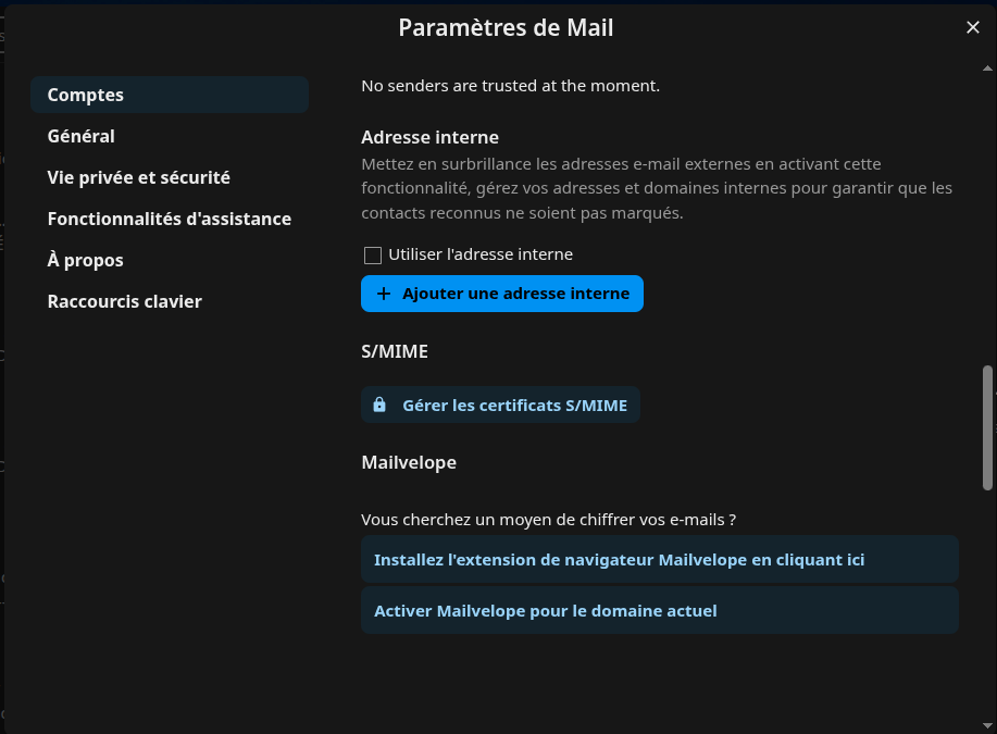

Hello,
After verification, you must enter a user certificate here:
Emails go out directly.
good to see that you resolved it.
For the internal server errors you should find something either in the mail- logs or nextcloud.log.
