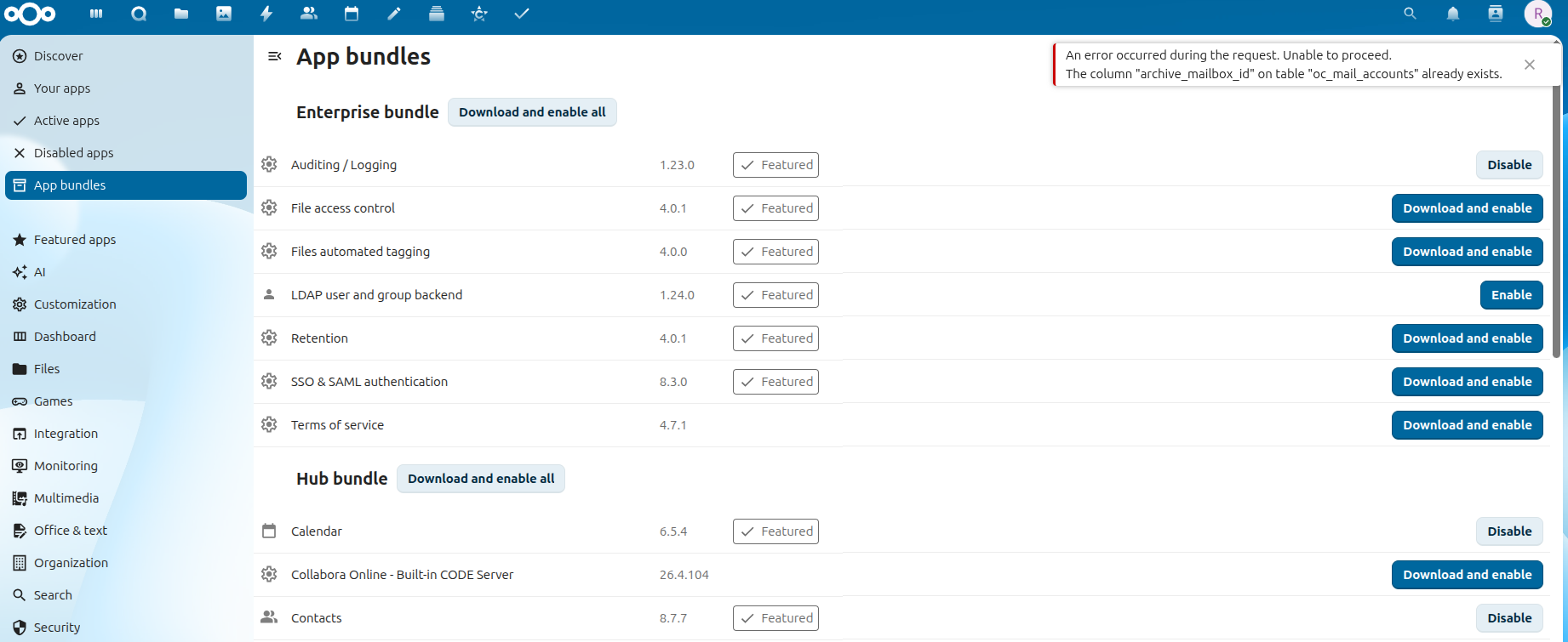

When installing the Mailapp by clicking in the apps console on download and enable, I got this error.
An error occured during the request. Unable to proceed. The column “Archive mailbox ID” on table “OC_mail_accounts” already exists.

  1. First I tried to download and enable the Nextcloud mail app, but that did not work because there were updating problems. So
  2. Second My service provider did help me out updating all AIO containers, normally that goes automatically, now it didn´t and so my service provider did help me out and got everything working again.
  3. Then I tried again download and enable and I got this error message, so I tried a remove on the mailapp and tried again inclusive deleting the cookies in de browser. Did not work.

Hello
This makes sense once you line up the timeline: your original mail app install attempt got hit by the database going down mid-migration (all those “database system is not yet accepting connections” / “server closed the connection unexpectedly” errors from Aug 30), so the migration that adds archive_mailbox_id to oc_mail_accounts partially ran, the column got created, but Nextcloud’s internal migration tracking never got marked as complete because the connection dropped before it could finish. Now every retry sees “run this migration” as still pending, tries to add the column again, and fails because it’s already there.
This isn’t something to fix via the UI, uninstall/reinstall through the apps page won’t touch the actual DB migration state table. It needs a manual DB fix:
Connect to the AIO database container directly:
docker exec -it nextcloud-aio-database psql -U nextcloud -d nextcloud_database
Check the migrations table for the mail app to see what’s marked as applied vs not:
sql
SELECT * FROM oc_migrations WHERE app = ‘mail’ ORDER BY version;
Compare against the mail app’s actual migration files (in apps/mail/lib/Migration/) to find which version corresponds to adding archive_mailbox_id. Once identified, manually insert that version as applied so Nextcloud stops trying to re-run it:
sql
INSERT INTO oc_migrations (app, version) VALUES (‘mail’, ‘XXXXXXXXXXXX’);
(replace XXXXXXXXXXXX with the actual version string from the migration filename)
Since this touches the database directly and a wrong entry can cause other issues, it’s worth taking a snapshot/backup of the database container’s volume before running the INSERT, and ideally posting the exact migration filenames from the mail app’s Migration folder here first so someone can confirm the right version string before you commit it.
Also worth flagging to your service provider (Yourdata Network) separately, since the DB going down mid-operation during their container update is what caused this in the first place, worth them checking why postgres terminated unexpectedly during that maintenance window so it doesn’t repeat on the next update.
