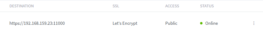

  5. After the initial setup, configured NGINX Proxy Manager to route a domain (e.g. cloud.example.com) to the internal IP of the nextcloud-aio-mastercontainer (192.168.159.20:8080).

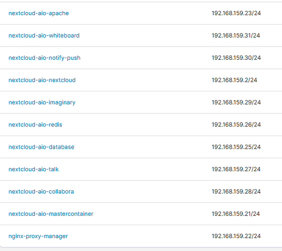

  7. During this step, the AIO Mastercontainer created several additional Nextcloud containers (like nextcloud-aio-apache, nextcloud-aio-db, etc.).
  8. At this point, I attempted to switch all containers to the macvlan network to give them dedicated LAN IPs and make them accessible.

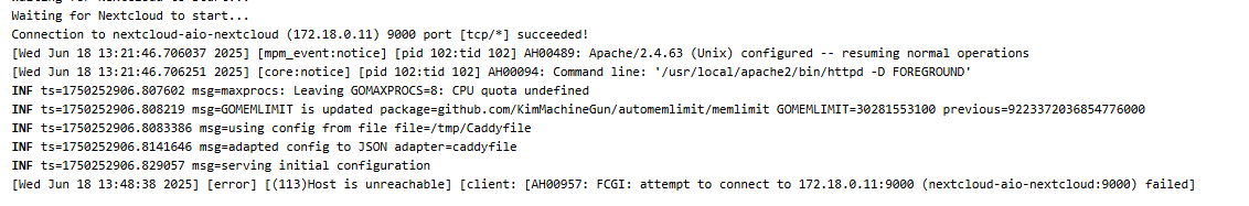

  9. Problem: Once on the macvlan network, the containers could no longer communicate with each other internally and if i had both netwerken (the default aio network) the containers wil connect internal in docker but not what the npm anymore.

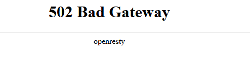

each other, but then the macvlan doesn’t work anymore and if I remove the internal network they can’t communicate with each other internally anymore, which gives me the bad gateway. if I put nginx back to the master container 8080 then I just get to the nextcloud page, but here it says that I need the apache container, probably because I created this container myself and the apache container was created by the setup.

Nginx proxy manager

screenshots
Docker macvlan

npm
