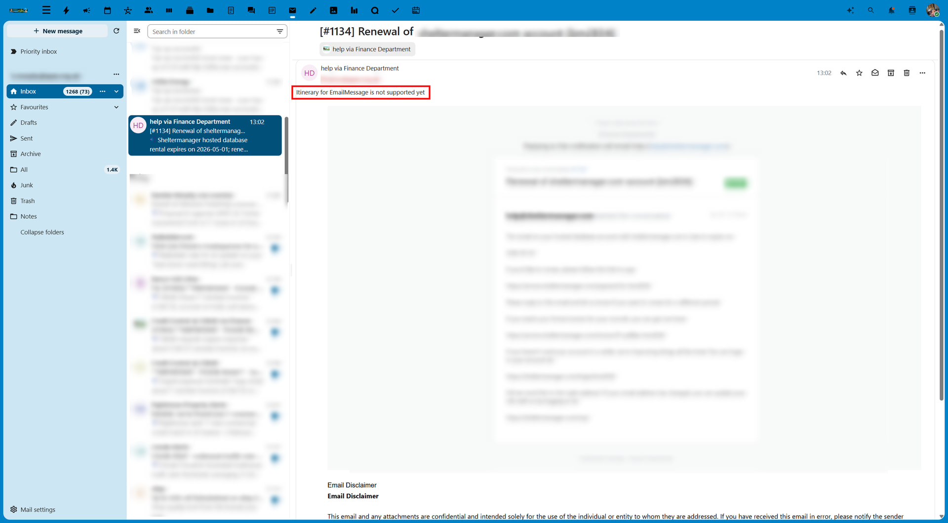

Itinerary Not Supported?
Has anyone else got or seen this error?

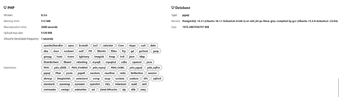

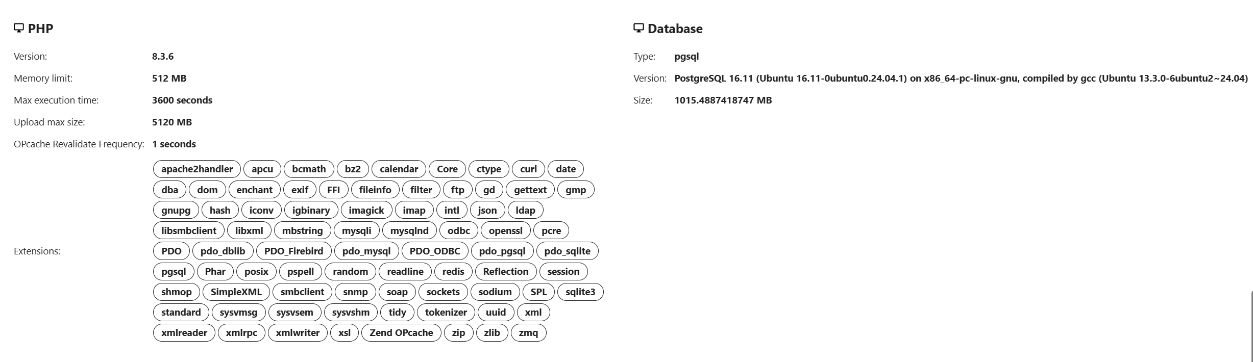

This is our server details.
Our Mail app is on 5.1.12

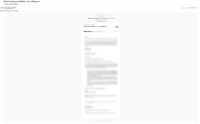

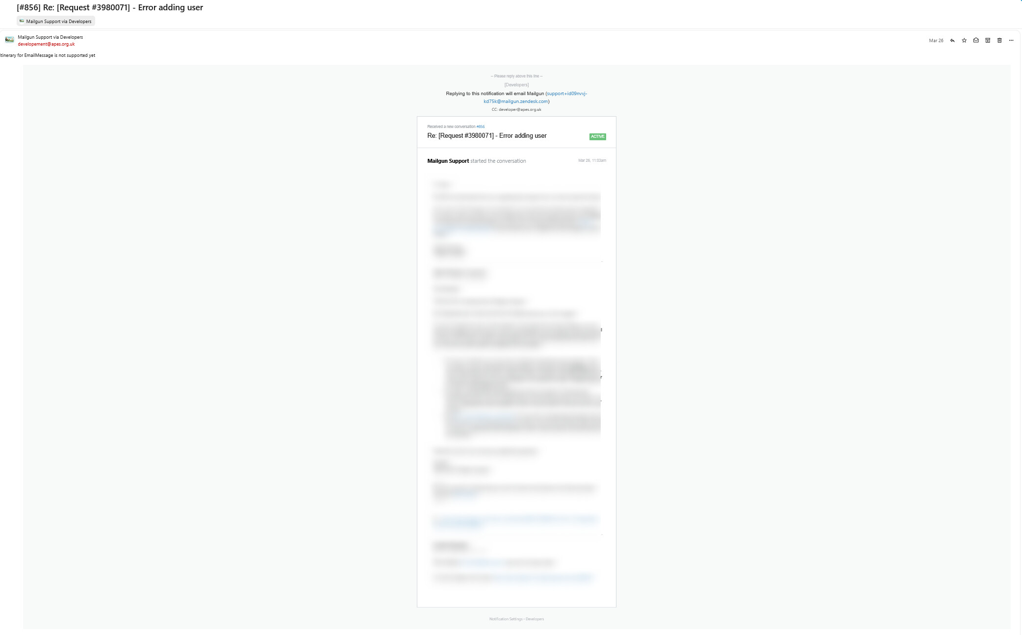

I have investigated more, it seems to be emails from freescout that contain content from a ticket. As other emails like log monitoring and fetching problems, that do not contain a reply from a client in a ticket, are working fine.
And it does seem it is only freescout notification emails from tickets that seem affected.
This is one of the emails,
The contents are primarly text with links from mailgun support no dates, or flight details. Maybe it’d faulse error?
Also I traid chatwoot as it emails contents of tickets in emails and the error is not present on them emails. Seems to be isloated to freescout emails as I can not find any others.
