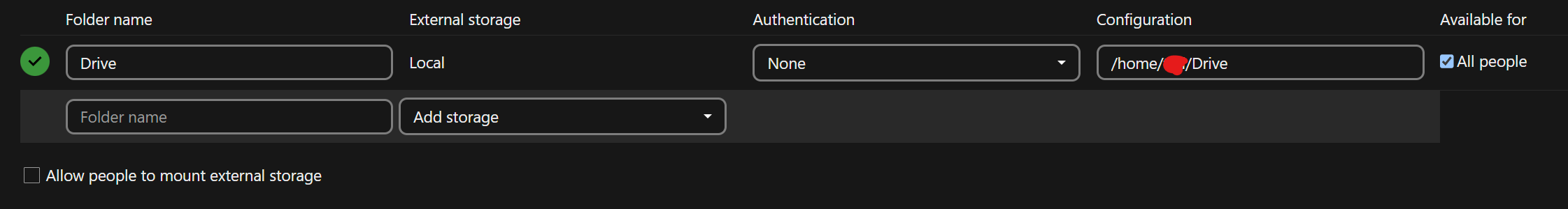

I recently started using NextCloud and encountered an issue. The photos plugin is not displaying images from a mounted Samba disk, although I can view them without any problems in the “Files” section.

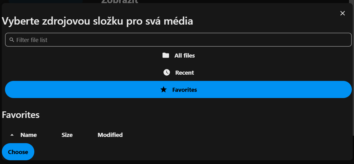

I have the same problem. The version 30.0.4 did not have this problem. I coud use external storage as source for Photos. But in 30.0.5 they changed GUI in selecting source for Photos. There is no external drive shown. I even tried to select Folder in external drive as Favorites but the Favorites did not show in Photo selection of source. Any idea how to fix it?
Thank you

The Samba disk mounted in the user’s folder.
