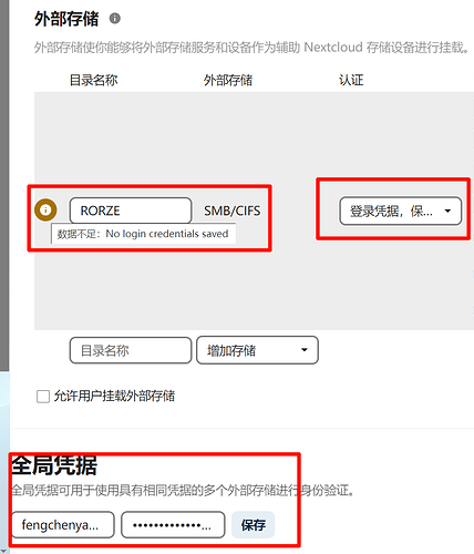

When I connect the AD domain controller and NAS in NextCloud, I am unable to collaboratively edit files when my authentication uses login credentials saved in the database. Additionally, in the background, I can see the message “No login credentials saved”, which is undoubtedly a bug. How can I solve this?

From the screenshot you the problem seems related to external storage. do you have this issue using local storage? if you login using credential provider you don’t use internal application password - this might be the reason why external storage doesn’t work as expected. I would recommend you test with completely fresh user who never use internal password but only login and configure external storage using AD login.

The issue I’ve discovered is that when I use the extended storage and the authentication method is “username:password”, the NAS folder I see is actually determined by the account and password I entered during the background mounting, rather than by the user I logged in as. When User A and User B open the same file, the collaborative editing function of Only Office can be triggered, meaning that User A and User B can see each other’s real-time edits in the file. However, due to incorrect folder permissions, User A cannot see the folders they should be able to. So I switched to “Save login credentials to the database”, at which point the NAS folder permissions for User A and User B were correct. I authorized the same folder in the NAS for my NextCloud User A and User B to view, but when opening the file simultaneously, the collaborative editing function does not trigger. After some attempts, I saw “No login credentials saved”. The problem is most likely here. How should I solve this issue?

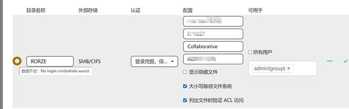

When I tried to use the “login data saved in the database” authentication method, I was surprised to find that the folder permissions seen by my user A were consistent with what I set in the NAS, because the user accessing the NAS at this time was the user I was currently logged in as. However, this raised a problem: if user A doesn’t share the folder with user B through the sharing function (because user B and user A have the same permissions and can see the same files in the folder), then when user A opens file A and user B opens file A, the collaborative editing function won’t be triggered. I have already checked my system, and I suspect the problem lies in the backend prompt of “login credentials not saved”.
Since my NextCloud actually doesn’t mount external storage, it can’t trigger the collaborative editing function.
Do you think my understanding is correct?
I wonder if it’s possible to add in the “login credentials saved in the database” authentication mode which user NextCloud uses to mount external storage?
I have already set a global account password, but NextCloud doesn’t seem to use the global account password to mount external storage.
