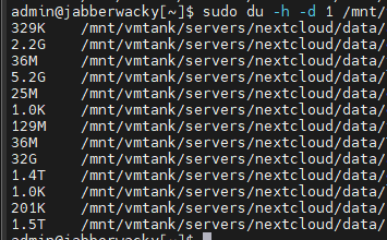

this is from a du -h -d 1 of the files location, the 1.4tb is for the user displayed above

If you do the du -h -d 1 within the user’s folder, what do you get?
1.4TB same as shown above, same as what used to display in the UI in 29.03.
