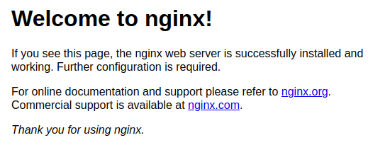

The database backup worked, but I’m stuck now with a standard welcome message.
I’ll open up a new thread since the question has changed.
