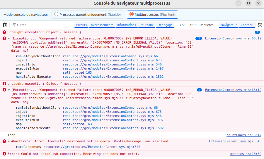

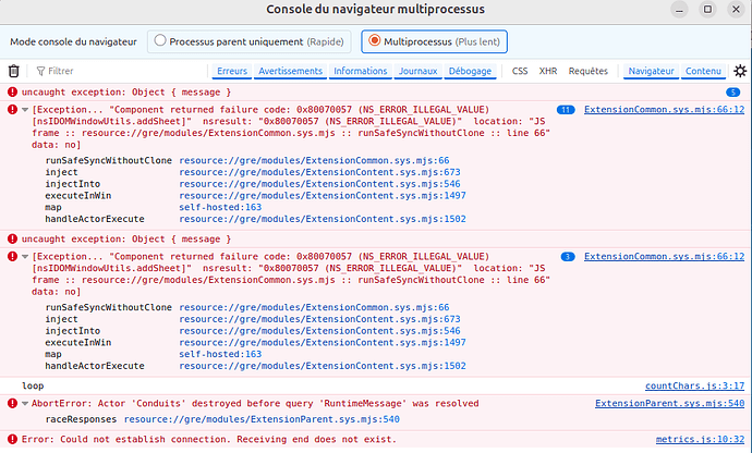

I join a screen shot of the console when I try to login :
I tried with an another web navigator (Chrome), there is the same pb.
That error looks like it’s coming from a browser extension.
Maybe try in private browsing mode and/or with extensions off?
