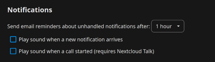

sounds good to me @vawaver but I am not able to find the way to enable mail notifications for backup
in settings/user/notifications the only section I can see that is relevant could be this below, am I right ?
Thank you.
Indeed, this is what should be used. You can also configure the mail address for any admin account to send emails to a certain mail address.
