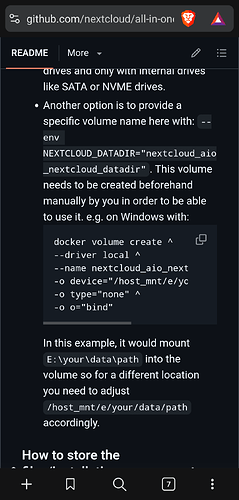

Hey, just to link to this post again and quote my own screenshot:
  • Another option is to provide a specific volume name here with: --env NEXTCLOUD_DATADIR="nextcloud_aio_nextcloud_datadir". This volume needs to be created beforehand manually by you in order to be able to use it. e.g. on Windows with:
    docker volume create ^
    --driver local ^
    --name nextcloud_aio_nextcloud_datadir ^
    -o device="/host_mnt/e/your/data/path" ^
    -o type="none" ^
    -o o="bind"
    In this example, it would mount E:\your\data\path into the volume so for a different location you need to adjust /host_mnt/e/your/data/path accordingly.
To highlight it even more, you are probably missing --env NEXTCLOUD_DATADIR="nextcloud_aio_nextcloud_datadir" in the compose file.
