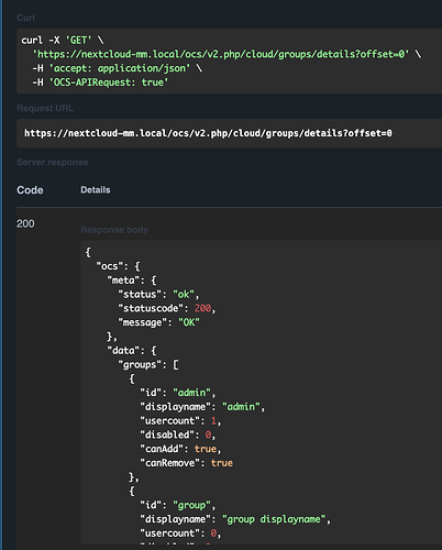

You can use the details API for that:
curl -X 'GET' \
  'https://nextcloud-mm.local/ocs/v2.php/cloud/groups/details?offset=0' \
  -H 'accept: application/json' \
  -H 'OCS-APIRequest: true'
I recommend OCS API Viewer - Apps - App Store - Nextcloud if you wanna play around with the API :slight_smile:
Thank you so much.
Can you explain how to find this API from the OCS API viewer? I find its user interface baffling.
It’s a bit tricky if you don’t know the modules, indeed. For this you need to look at the provisioning api
