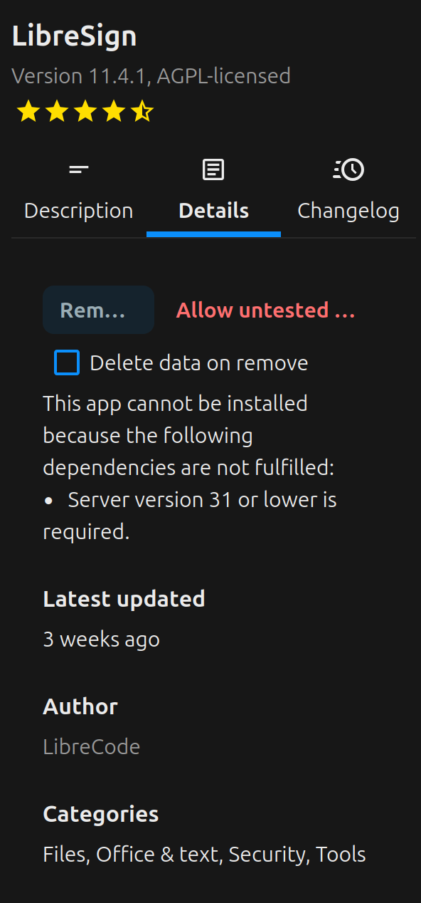

Did you end up switching to Documenso? I’m also looking at OpenSign. With the release of Nextcloud 32, Libresign is no longer working. Is there typically a lag between a Nextcloud release and a LibreSign update?
