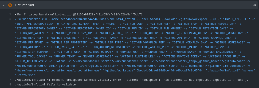

I do get a lot of failure messages at the moment, every time I push to Git hub “Lint info.xml: All jobs have failed”

Well, fixing the issues. This is no problem with the GitHub actions. They are just warning you of different incompatibilities. Take this example:
This tells you that in your info.xml file, there is a bug. This might work but is not guaranteed to do.
Having a look at the workflow file, you find the test is just a XSD check. The XSD file is this one.
Having a look at the XSD and the XML file in your repo, you quickly find that the ordering of the XML elements is off. The order is id, name, summary, description, version, licence, author, and then namespace. You have id, namespace, category, name, etc. Fix that ordering and the linting of the info.xml will succeed most probably.
