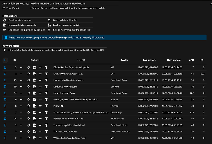

@ernolf

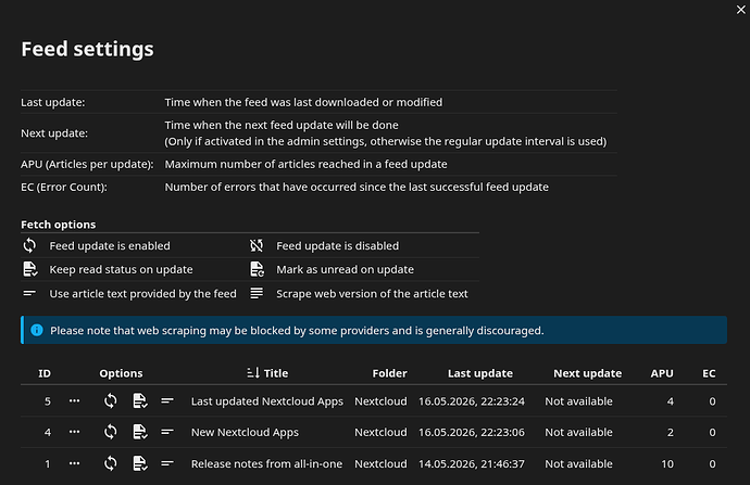

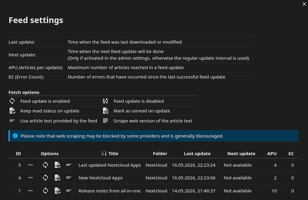

One more thing while we’re on the topic — I’ve subscribed to the feeds and they work when I manually refresh, but automatic feed updates don’t seem to be running. All three feeds show “Not available” under Next update (screenshot attached). Running News version 28.3.0.
I’m guessing this is related to the background job / cron setup on my instance, but wanted to check if anyone has run into this and what the fix was.

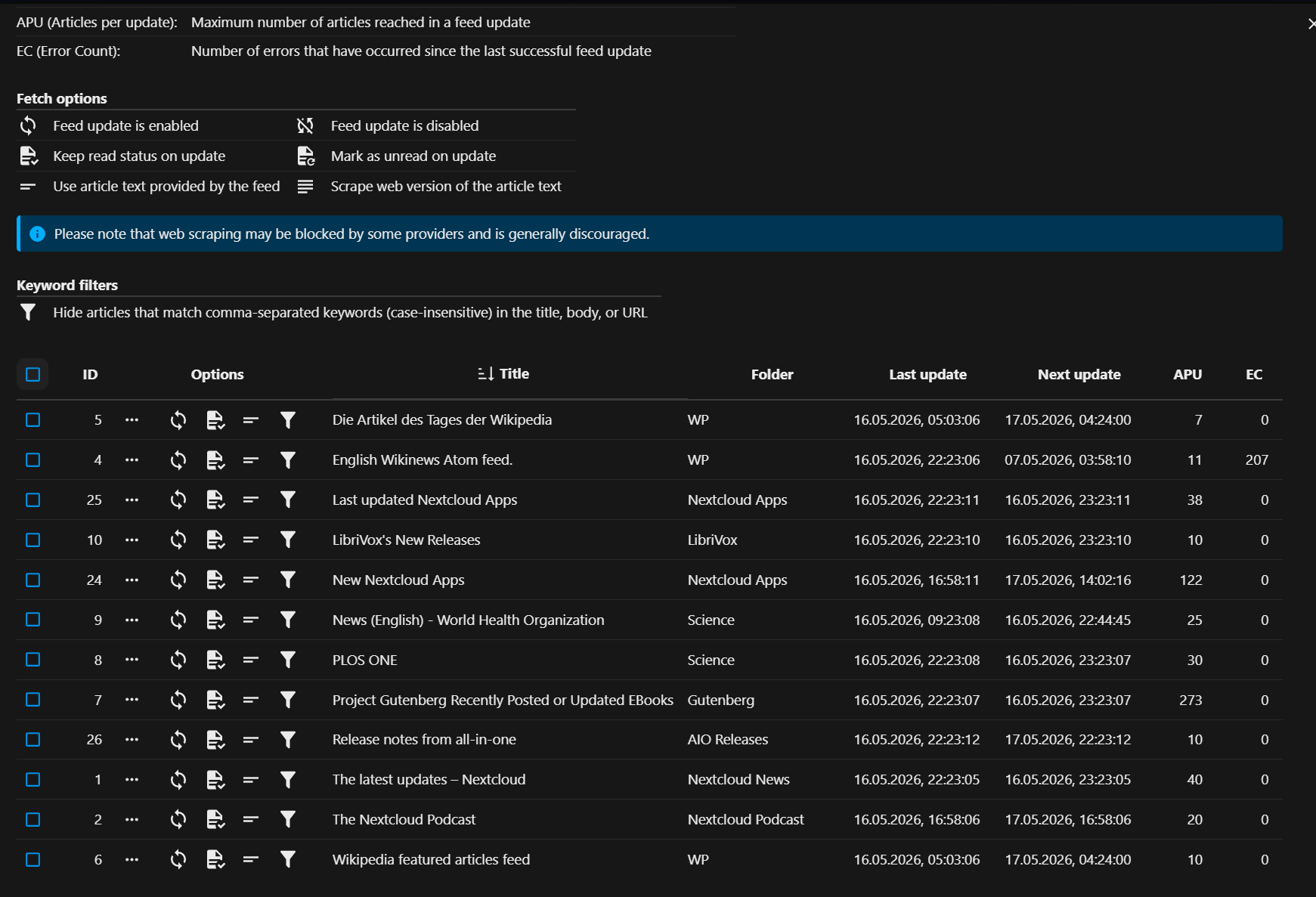

Hi @vawaver,

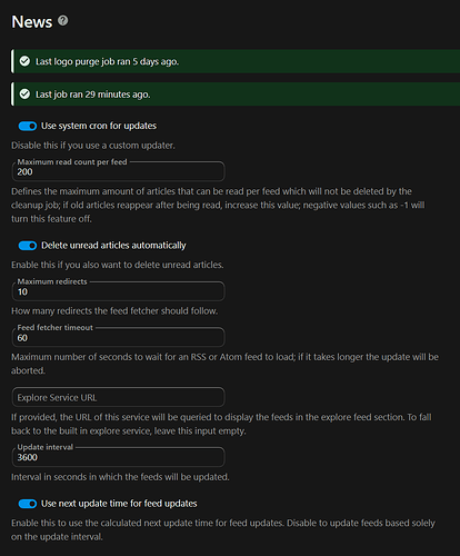

This is how it looks for me:

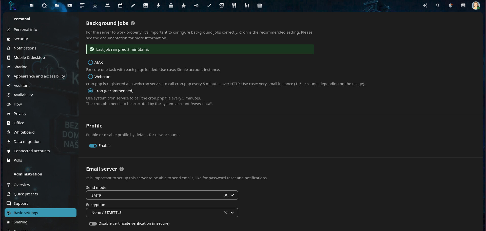

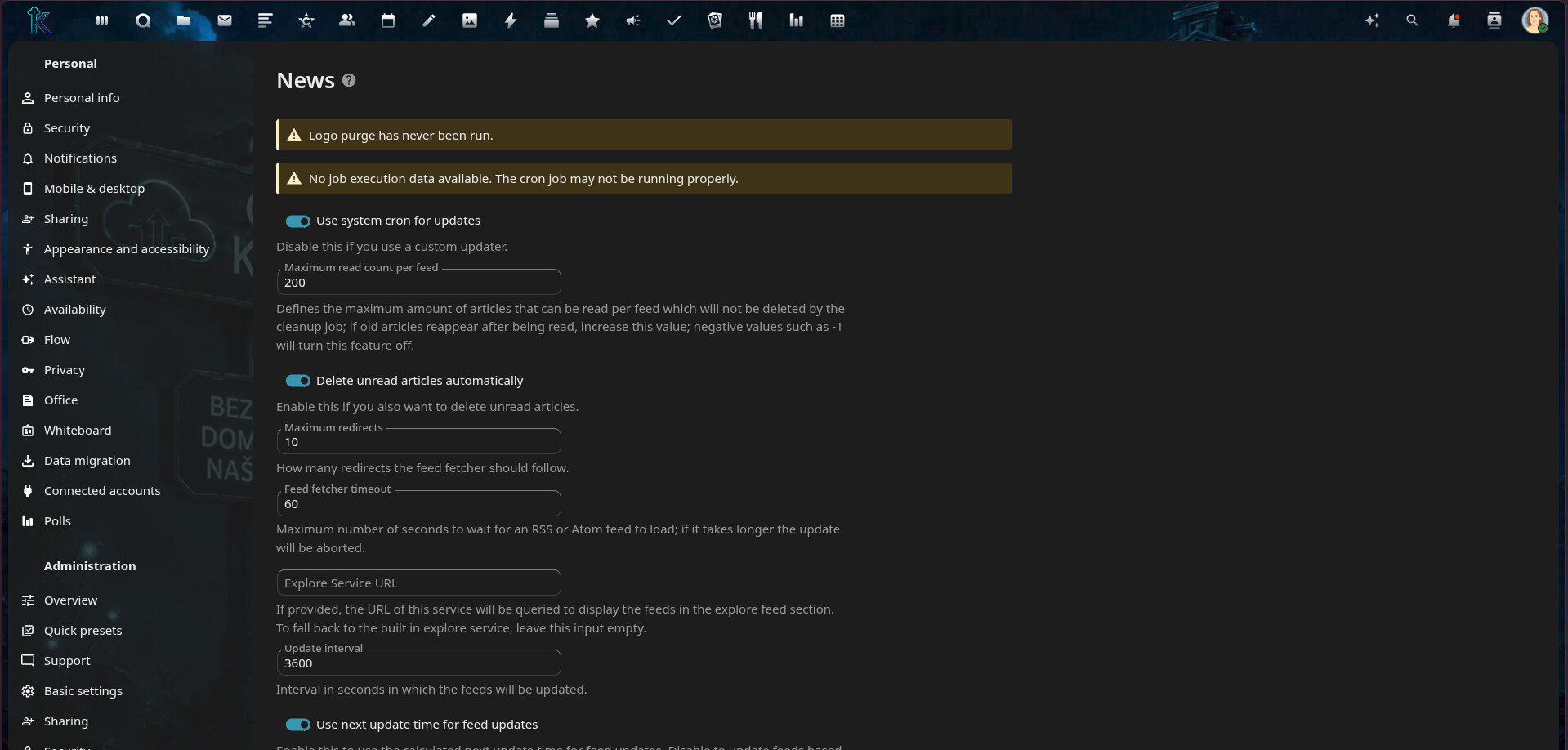

Yes.it is from importance how you configure your cronjobs. Ther is an admin interface for news:

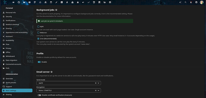

@ernolf

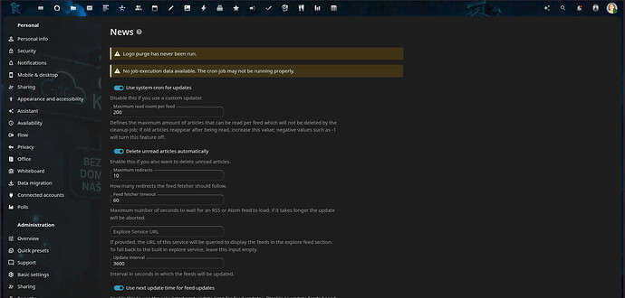

something is wrong. I have no idea how to fix it.
but the cron works.
I found the solution, attaching the full guide.
Nextcloud News: Feed auto-refresh not working even though Nextcloud cron is running
I ran into an issue with the Nextcloud News app where automatic feed updates were not working, even though the main Nextcloud cron system was working correctly.
Environment
  • Nextcloud AIO
  • Nextcloud version: 33.0.3
  • News app version: 28.3.0
  • Background jobs mode: Cron
Symptoms
In the Nextcloud administration settings, the main background job status looked fine. The system cron was running normally, and Nextcloud reported that the last background job had run recently.
However, in the News app admin settings, I saw warnings like:
Logo purge has never been run.
No job execution data available. The cron job may not be running properly.
The News app was not automatically refreshing feeds.
