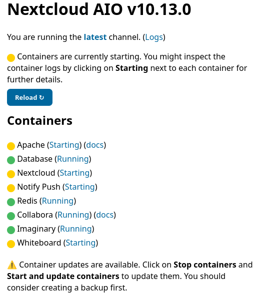

I have “same” problem and “same” network config.
An I have got question to author, to narrow source of the problem, how other containers are working?
For me AIO web interface shows that only Database and Redis are running (out of 5 base components including not counting above mentioned Apache, Nextcloud and Notify Push - simplest test config to cut dawn Talk problems etc)
Same time Portainer shows all containers are healthy except nextcloud-aio-nextcloud with error:
nc: getaddrinfo for host “nextcloud-aio-database” port 5432: Try again", but it can ping in manualy by name or internal IP without problem.
But nextcloud-aio-notify-push is “Waiting for Nextcloud to start…” with “same” error “nc: getaddrinfo for host “nextcloud-aio-nextcloud” port 9000: Try again”. Same ping works good.
Same goes to nextcloud-aio-apache that is also “Waiting for Nextcloud to start…” with same error “nc: getaddrinfo for host “nextcloud-aio-nextcloud” port 9000: Try again”. Also ping is working.
After days of trials and mostly errors I think that AIO default config has same internal connection problems between containers…that manually can “communicate” ping with each other. I even have tried to connect it manually to docker default bridge (hell with security) but it didn’t help.
