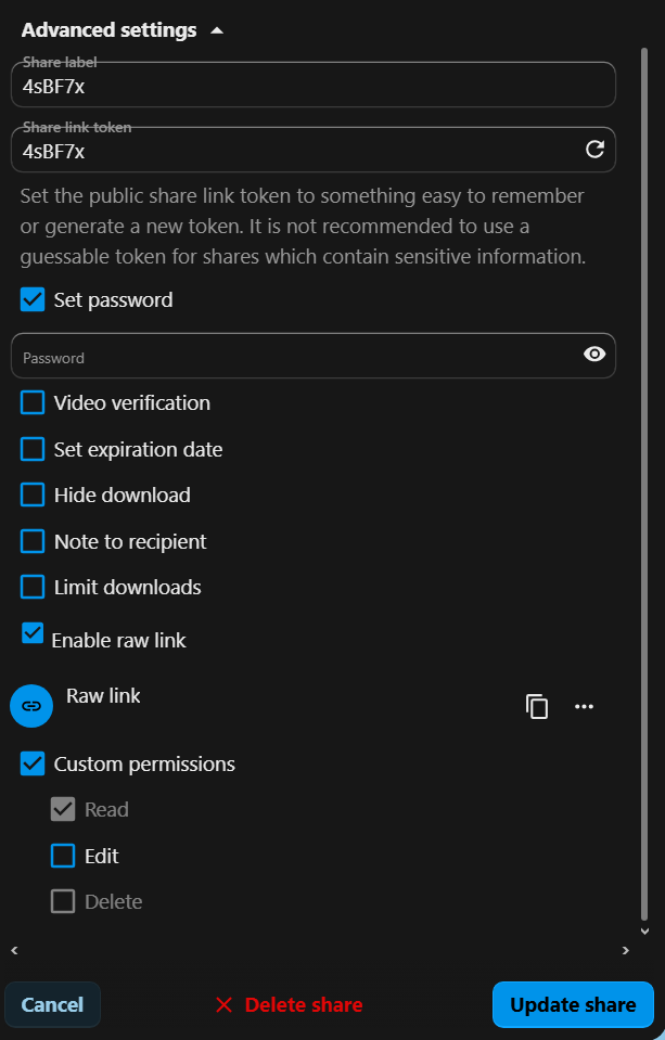

I can’t check the “enable raw link” option in the sharing properties. I check the box, but it clears within a second.

Regarding “enable raw link“ checkbox, I can’t check it at all.
Checkbox clears in a split second after I’ve checked it. Before I can push any button or move the cursor.

I also have the same problem, I am using nextcloud AIO
Have the same issue, checkbox unchecking after split of second.
Update: Found the issue and could reproduce it.
In order for the short /raw/$token URLs to work, the app must be added to an array in the core code from the server. This change has already been implemented with this PR, but it will take until the next server point release for this change to arrive in the server core code.
Until then, an alternative setup was designed to work with longer urls. Unfortunately the alternative setup (without patching) doesn’t work correctly in this case. I am working on a fix. So the only working solution right now is the patch. How this must be done in “All-In-One” and Docker can be found here: Readme-aio

This behavior should be resolved with version 0.5.2
