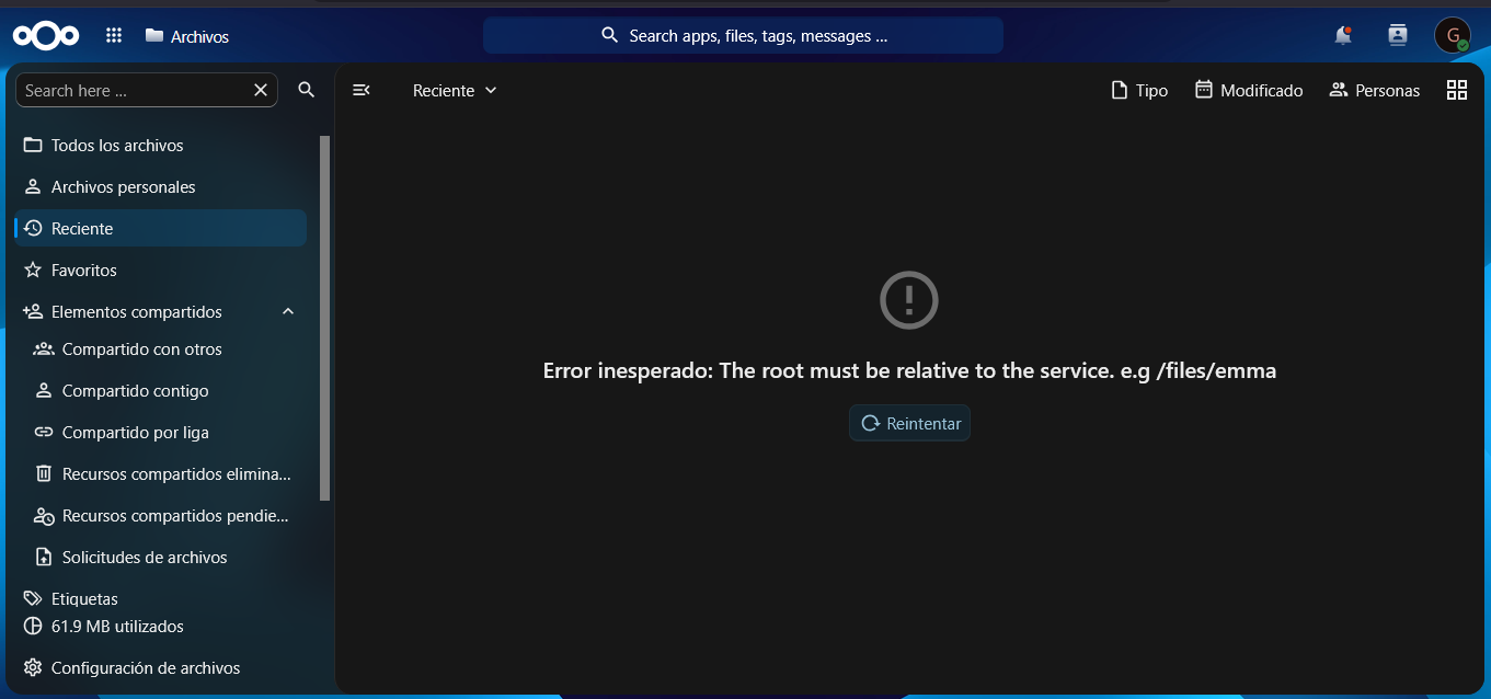

The Files app throws an error whenever it needs to render a view, showing:
Error: The root must be relative to the service. e.g /files/emma
It started when I set up a Team Folder (groupfolders app) and first only affected the “Recent” and “Tags” views. Disabling groupfolders did not fix it. I then performed a completely fresh install of Nextcloud 34.0.3 (official zip, brand new empty database) on the same server, without installing groupfolders at all, and the error still appears — now even in the main Files list, for a brand new user with nothing shared and no external storage configured.

[ERROR] files: Error while fetching content
{app: "files", uid: "<user>", level: 2, error: Error: The root must be relative to the service. e.g /files/emma

What is your overwritewebroot config parameter set to (and htaccess.RewriteBase for that matter)?

I fixed making a subdomain nextcloud.mydomain.com, and adding to my ssl certificate, generate a nextcloud-subdomain.conf with this

then all it works fine
In your original sub-folder installation, I’d expect this to be set to the sub-folder (/nextcloud) not your /.
But a subdomain approach, like you switched to, is probably best anyhow unless you have a compelling reason otherwise.
