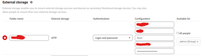

From the command line I can connect to sftp share without problem
Same configuration on External Storage on NC I got error
In the log I can see
Error - files_external - Exception Login failed
Info - lib - Storage with sftp::[USER]@[HOST]// marked as unavailable
Info - PHP - Cannot connect to [HOST]:22. Error 110. Connection timed out at /var/www/html/nextcloud/3rdparty/phpseclib/phpseclib/phpseclib/Net/SSH2.php#1361
why those double slashes in the first Info?
I tried to put a home too but it always puts the double slash, is that correct?
Why that “:22” in the second Info when the port I use is different?
  1. Configure external storage and save
  1. [files_external] Error: Login failed
    PUT /apps/files_external/globalstorages/3
    from [IP_ADDRESS] by [USER] at 26 mar 2025, 15:34:58
  2. [lib] Info: Storage with sftp::[USER]@[HOST_WITHOUT_PORT]// marked as unavailable
  3. [PHP] Info: Cannot connect to [HOST]:22. Error 110. Connection timed out at /var/www/html/nextcloud/3rdparty/phpseclib/phpseclib/phpseclib/Net/SSH2.php#1361
