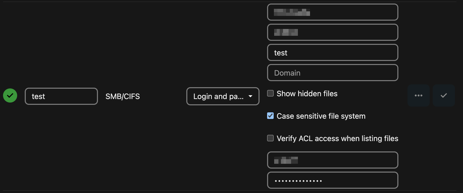

  1. Setup external storage (SMB/CIFS) using log-in credentials authentication method, mount directory with drwxr-xr-x user:group.

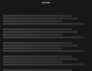

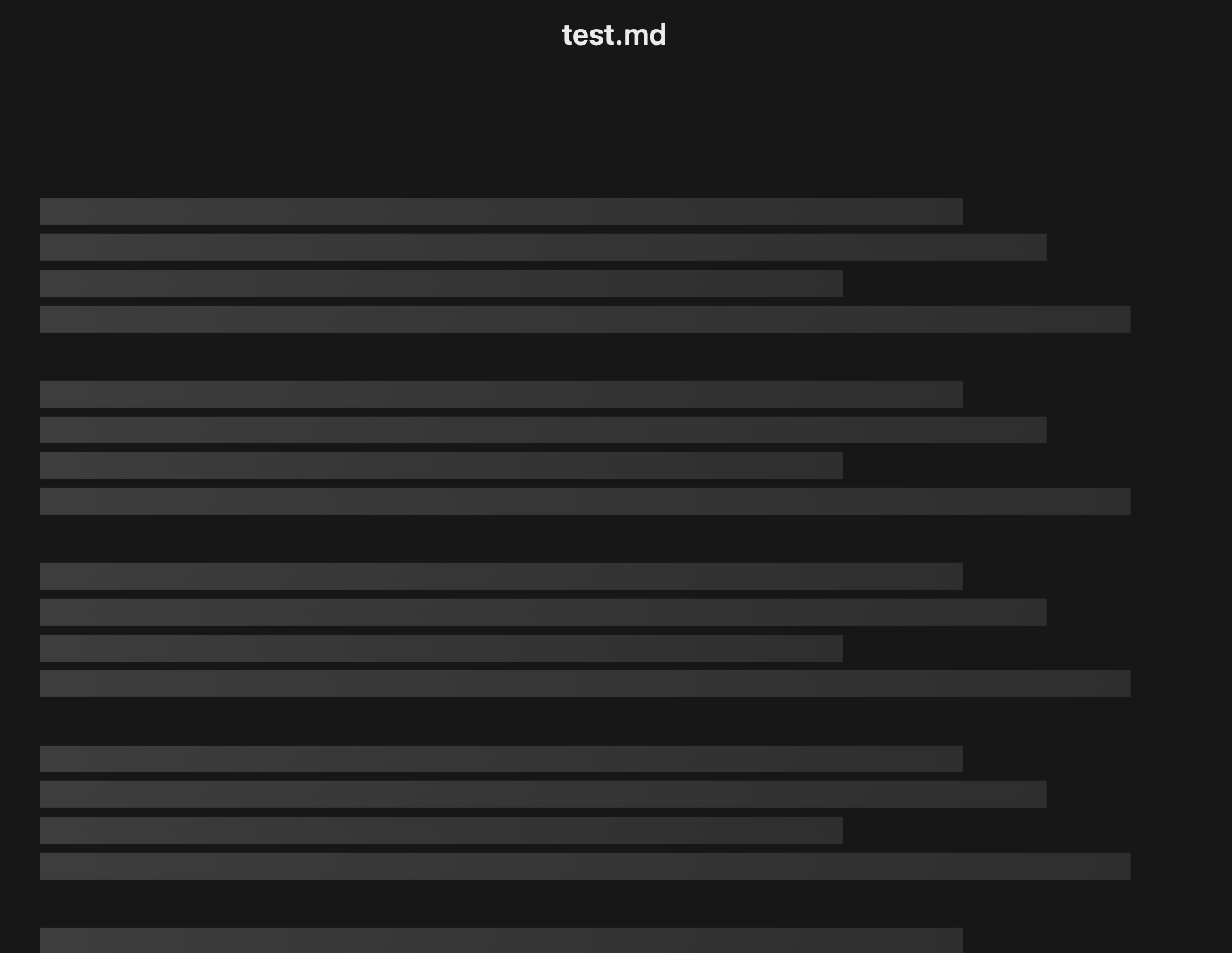

  2. Using Nextcloud web, create a new text file.
  3. Then you will see a pending editor.
  1. If I write some content via external storage, and reopen the file, you will see the file has been changed outside the editor, but the two versions are the identical content.

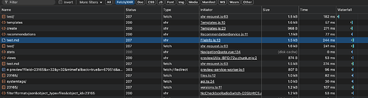

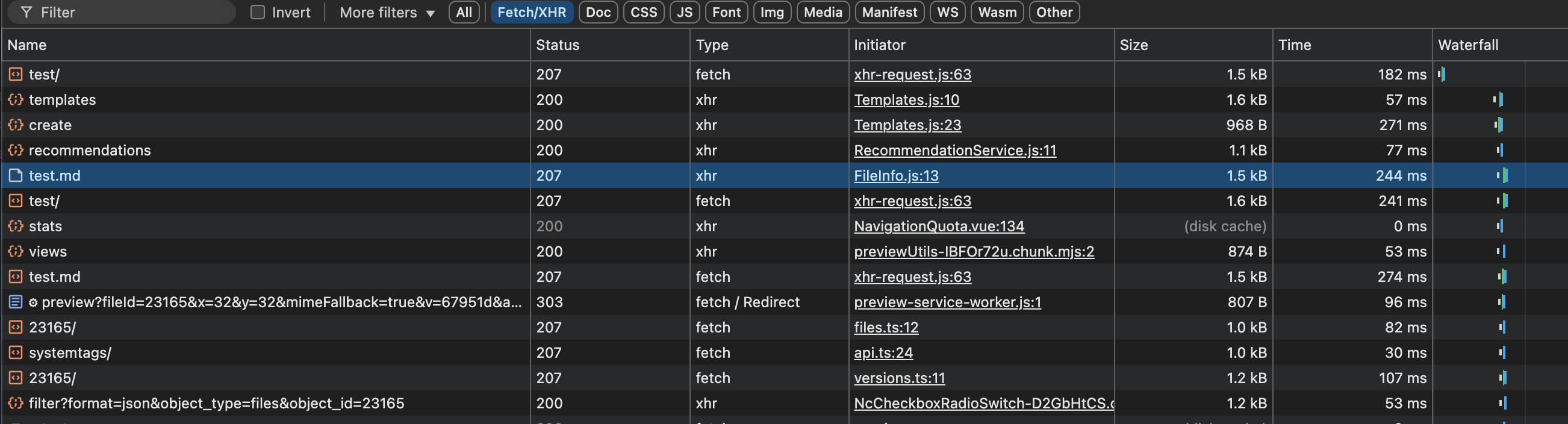

Console
Autofocus processing was blocked because a document already has a focused element.
Network
PASTE HERE
not related.

Instead of using the OS to mount the SMB/CIFS, I use external storage.
To install smbclient, I use the following commands:
docker compose exec app bash -c 'apt update && apt install -y smbclient'
I manually set two attributes in config.php:
'filesystem_check_changes' => 1,
'skeletondirectory' => '',
I then set up the test external storage with advanced configuration as the default (only enabling previews).
