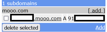

my sub-Domain is from freedns:
the ip that it forwards to fits to my public ip4, i used wget to update it regularly, but since it fits atm this should be of relevance, i guess.
