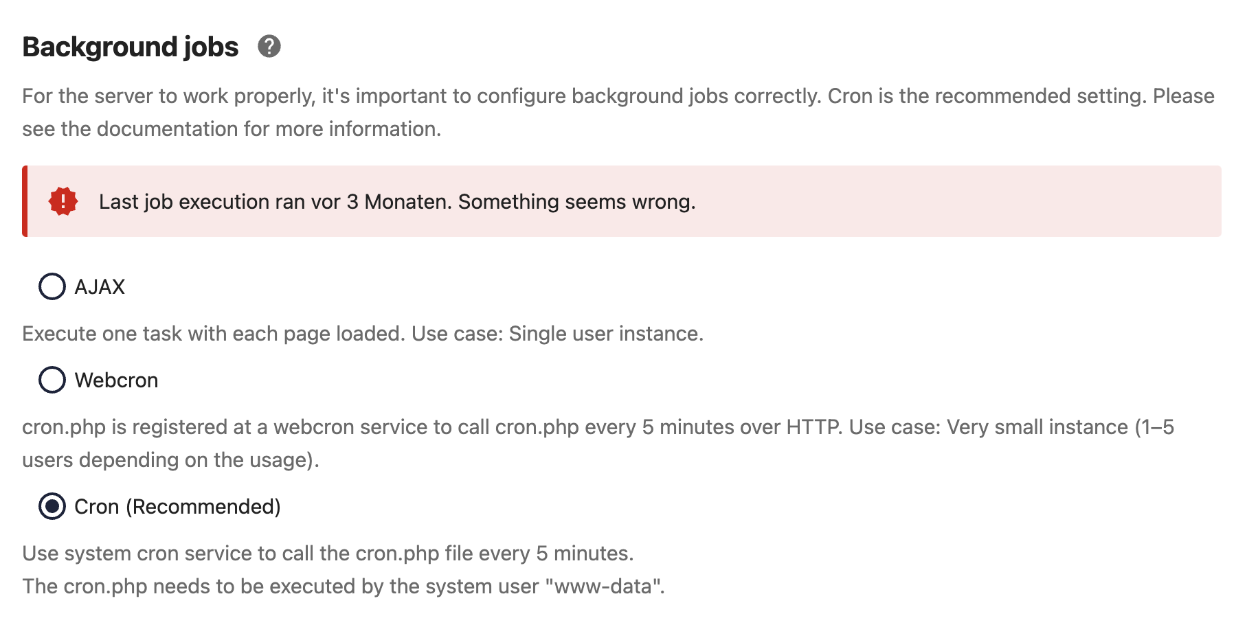

Hello, I have the problem that my background job does not seem to be working. What do I have to do to fix this error? What more information do you need from me?

Well, that’s certainly a nice tutorial/explanation, but we don’t even know if @tomg1970 is using docker, or a manual installation, or an installation via distro packages, or AIO, or the snap, or some 3rd party docker image. We literally know nothing, except that the background jobs have not been working for 3 months
