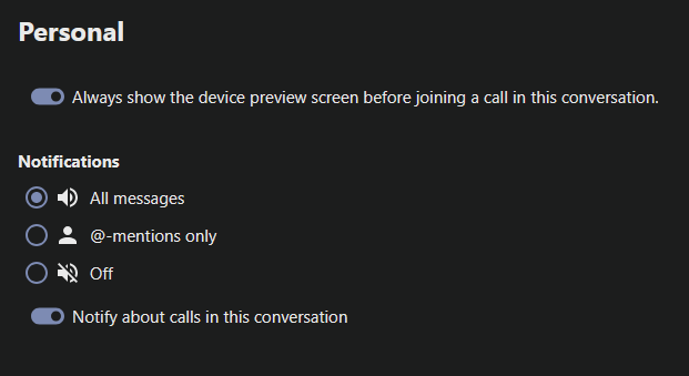

In Talk in the “conversation settings” I found this:
But there I can not specify whether the notification is push (dektop client, app) or email.
