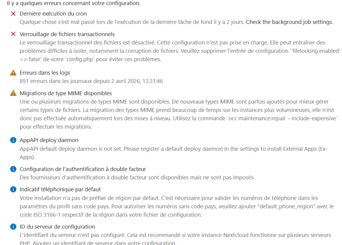

Since the upgrade to version 33, I have a recurring problem:
When I run the cron with the command: occ background-job:worker
The process gets stuck. In the MariaDB database, I can see several transactions that are blocked, and one large transaction that has been in ROLLING BACK state for many hours (currently more than 1.3 million undo log entries).
Even when the rollback transactions eventually finish, the problem reappears as soon as I relaunch the cron jobs. Additionally, there are currently around 6000 jobs waiting in the cron queue.
This is causing high database load and frequent “Lock wait timeout exceeded” errors.

BD rollback
  1. run cron job
BD process list + transaction
SHOW ENGINE INNODB STATUS;

docker compose exec --user www-data app php occ background-job:list -v -l 25000

Can you confirm there are no warnings or errors under Admin settings->Overview, particularly database/index related?
Also, any clues in the Nextcloud log?
You may need to lower the log level to 1 (INFO level) temporarily to see a bit more about what’s going on with the jobs.
Just to make sure there isn’t a misunderstanding: When you say “stuck”, you’re not just referring to the worker not exiting, correct? Because the worker mode for cron (versus running cron.php directly every 5 minutes) is meant to be a persistent process.
Lastly, what specific MySQL/MariaDB version?
Thank you for welcome !
Everything looks good in the Overview page.
I temporarily disabled file locking to avoid blocking my users (I have about 900 accounts on this instance).
The logs are not very helpful — there are a lot of false positives at INFO level but I active now .
From yesterday evening until this morning, the number of waiting jobs remained exactly the same, as if the process had been killed in between.
(The firewall cuts inactive connections, so I’m not sure what happened. I didn’t have tmux running at the time, only on my bastion server.)
When I tried to restart the job, I got lock errors again, similar to yesterday, with transactions stuck in the database.
This afternoon, once the rollback finally finished, I manually relaunched a few jobs, but I don’t know which one is causing the crash.
Sorry, it’s a bit unclear, but I don’t really understand what’s happening. I don’t know which job is blocking it, but I’ll restart everything this weekend to avoid generating users
What I do know is that when a transaction is in ROLLBACK, the whole instance becomes unusable.
As a workaround, I have blocked access to the synchronization clients via Nginx.
I have mariadb:10.11 and redis:8.4
Thank’s
