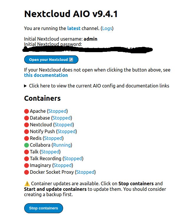

Containers won't start in docker image
Nextcloud AIO v9.4.1
Operating system and version Debian 12
Nginx Proxy Manger v2.11.3
The issue you are facing:
when trying to start Nextcloud it seems to be unable to open the containers

$ docker logs -f nextcloud-aio-mastercontainer
Trying to fix docker.sock permissions internally...
Creating docker group internally with id 993
Initial startup of Nextcloud All-in-One complete!
You should be able to open the Nextcloud AIO Interface now on port 8080 of this server!
E.g. https://internal.ip.of.this.server:8080
⚠️ Important: do always use an ip-address if you access this port and not a domain as HSTS might block access to it later!
If your server has port 80 and 8443 open and you point a domain to your server, you can get a valid certificate automatically by opening the Nextcloud AIO Interface via:
https://your-domain-that-points-to-this-server.tld:8443
[Mon Aug 26 06:05:40.755983 2024] [mpm_event:notice] [pid 134:tid 134] AH00489: Apache/2.4.62 (Unix) OpenSSL/3.3.1 configured -- resuming normal operations
[Mon Aug 26 06:05:40.756313 2024] [core:notice] [pid 134:tid 134] AH00094: Command line: 'httpd -D FOREGROUND'
[26-Aug-2024 06:05:40] NOTICE: fpm is running, pid 140
[26-Aug-2024 06:05:40] NOTICE: ready to handle connections
{"level":"info","ts":1724652340.7871454,"msg":"using config from file","file":"/Caddyfile"}
{"level":"info","ts":1724652340.7889686,"msg":"adapted config to JSON","adapter":"caddyfile"}
NOTICE: PHP message: Slim Application Error
Type: Exception
Code: 0
Message: Could not start container nextcloud-aio-talk: Server error: `POST http://127.0.0.1/v1.41/containers/nextcloud-aio-talk/start` resulted in a `500 Internal Server Error` response:
{"message":"driver failed programming external connectivity on endpoint nextcloud-aio-talk (2154ca228482871e599ccab8224d (truncated...)
File: /var/www/docker-aio/php/src/Docker/DockerActionManager.php
Line: 192

Hi, can you run sudo netstat -tulpn on the server and post the output here?
Active Internet connections (only servers)
Proto Recv-Q Send-Q Local Address           Foreign Address         State       PID/Program name
tcp        0      0 0.0.0.0:3478            0.0.0.0:*               LISTEN      249207/docker-proxy
tcp        0      0 0.0.0.0:3000            0.0.0.0:*               LISTEN      238945/docker-proxy
tcp        0      0 0.0.0.0:3001            0.0.0.0:*               LISTEN      238965/docker-proxy
tcp        0      0 0.0.0.0:9697            0.0.0.0:*               LISTEN      186242/docker-proxy
tcp        0      0 0.0.0.0:8990            0.0.0.0:*               LISTEN      141807/docker-proxy
tcp        0      0 0.0.0.0:8991            0.0.0.0:*               LISTEN      141847/docker-proxy
tcp        0      0 0.0.0.0:8788            0.0.0.0:*               LISTEN      141732/docker-proxy
tcp        0      0 0.0.0.0:8920            0.0.0.0:*               LISTEN      2850272/jellyfin
tcp        0      0 0.0.0.0:443             0.0.0.0:*               LISTEN      233536/docker-proxy
tcp        0      0 0.0.0.0:445             0.0.0.0:*               LISTEN      567/smbd
tcp        0      0 0.0.0.0:8687            0.0.0.0:*               LISTEN      141884/docker-proxy

I see. Can you post the output of sudo docker ps here?
oh I see, the proxy had to be set to http and not https when t connects to the apache server
according to yacht everything seems to be running, but i get a 502 bad gateway error when i go to nextcloud.mysite.com, or 192.x.x.x:11000, and i don’t know why, I don’t see error logs
I did a trial and error of which containers work, and it seems it may be related to nextcloud talk, as disabling that plugin makes the containers work
i think what happened was that I did not understand how nextcloud would deploy separate containers for it’s apps, and added the port for nextcloud talk to nextcould-aio-mastercontainer
removing that port for nextcloud’s entry in compose.yml makes that issue go away, and now nextcloud seems to be running fine
but for some reason yacht keeps crashing when nextcloud is running and i don’t know why
Ah I see. Makes sense
