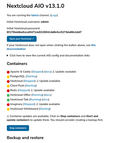

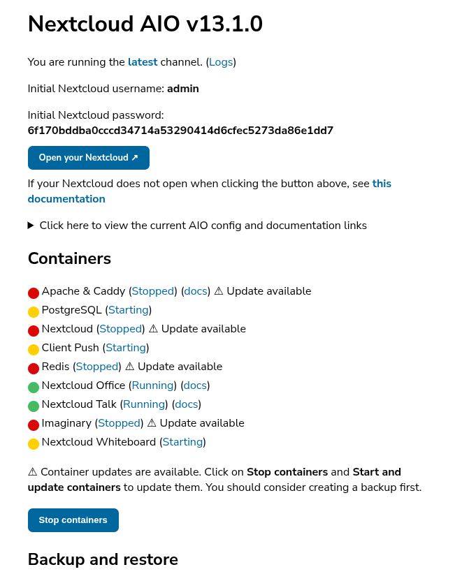

After stopping and updating containers in AIO, some of them don’t start and Nextcloud does not work:
  1. Install AIO using
    sudo docker run --init --sig-proxy=false --name nextcloud-aio-mastercontainer --restart always --publish 80:80 --publish 8080:8080 --publish 8443:8443 --volume nextcloud_aio_mastercontainer:/mnt/docker-aio-config --volume /var/run/docker.sock:/var/run/docker.sock:ro --env NEXTCLOUD_MOUNT=“/media/dnerukh/” Package all-in-one · GitHub
  2. open in browser https://192.168.0.55:8080
  3. login to AIO
  4. Stop container
  5. Start and update containers

Okay, I think I may have solved it in my case.
The logs for fulltextsearch held the clue.
It wasn’t starting, and looping complaining that my CPU didn’t support all the features it required.
I’m running a VM on proxmox, and I realized I had by mistake set the CPU to x86-64-v2-AES which does in fact not support a lot of CPU flags/features.
Changing the CPU type to x86-64-v4, shutting down the VM and starting it through proxmox again (not restarting it from the VM itself) worked on my system,
This left fulltextsearch happy again, and then the update worked.
