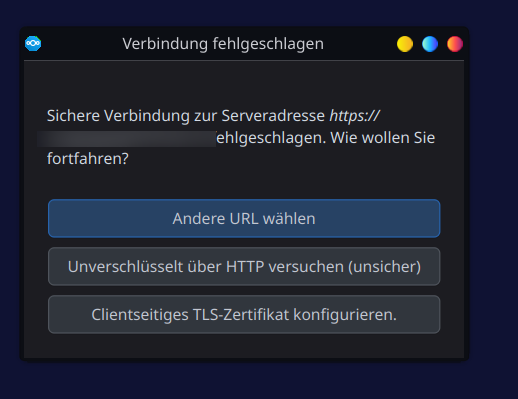

Hi, guys! I am at a loss. Two days ago, my clients stopped working. I updated my Nextcloud AIO to Nextcloud Hub 26 Winter (33.0.6), as well as the client. However, the client no longer connects to the server and requests a client TLS certificate. Access via the browser works fine. Where do I get that certificate? Thanks for the help. (Oh and I am on Linux)

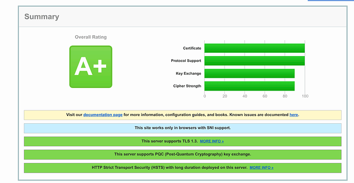

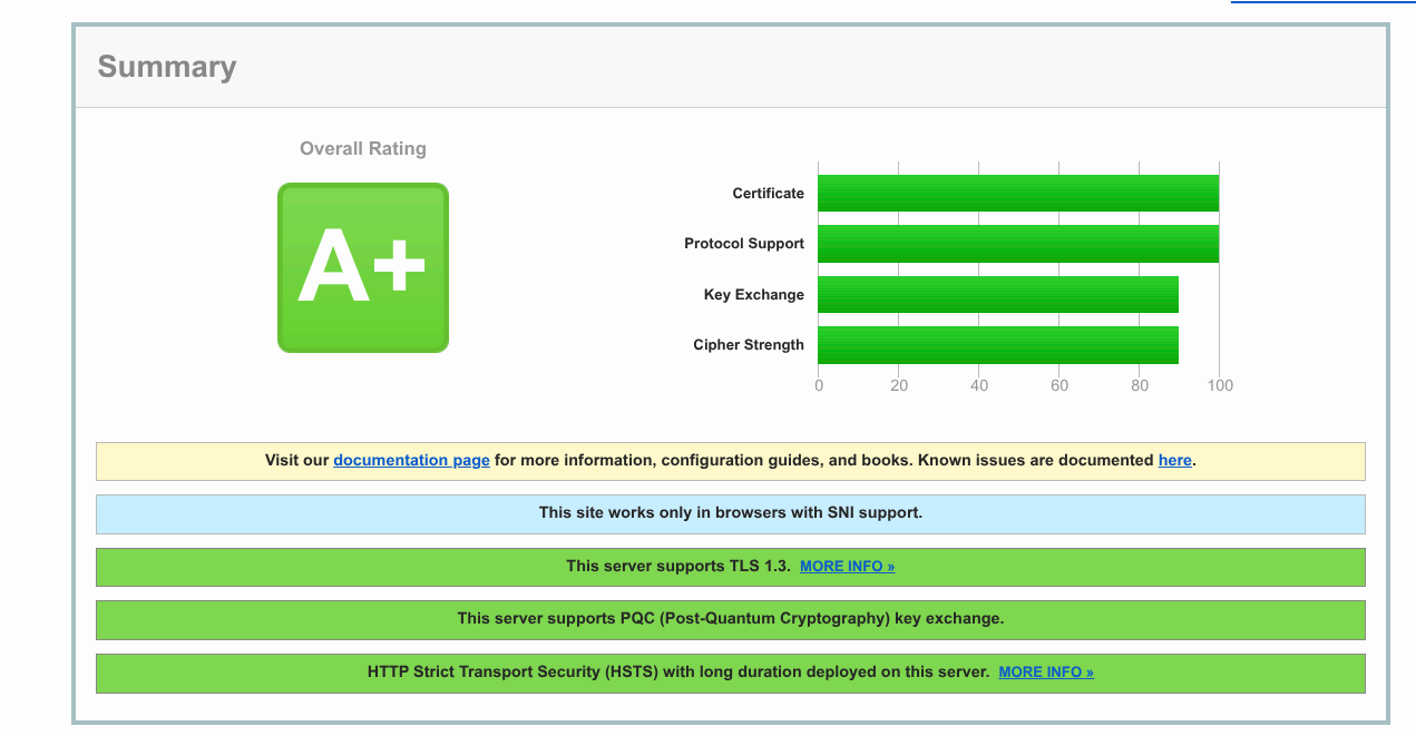

But also a bit of those:

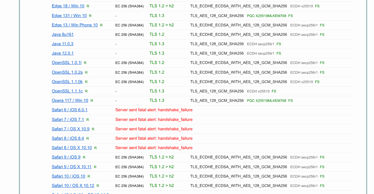

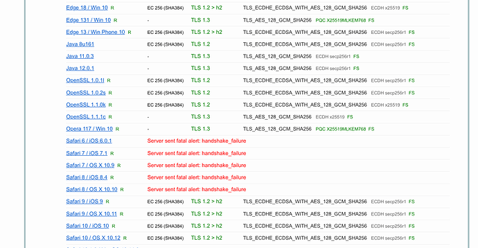

The striking feature, at least in my view, is in the first picture:
  • this server works only in browsers with sni support
The message “This server works only in browsers with SNI support” is a standard informational warning from SSL testing tools (like SSL Labs) indicating that your web server uses Server Name Indication (SNI) to host multiple SSL certificates on a single IP address and it cannot identify the correct certificate if a connecting client fails to send the hostname during the TLS handshake

Yes, I wrote my comment partly because, as I understand it, you shifted the focus with the following sentence:
the lines marked in red in the second image, which relate to the outdated versions of Safari. However, these are outdated and are therefore no longer in use today; this also applies to other outdated versions of browsers.
