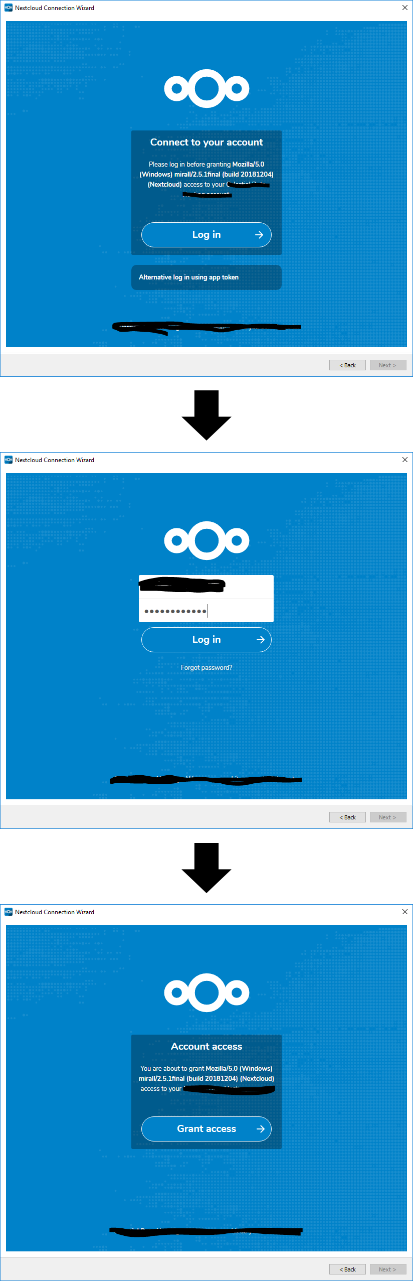

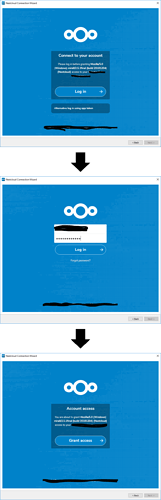

I have just performed a clean install of Nextcloud 15 on a Ubuntu Server 18.04 VM with NGINX as the webserver. I use a pfsense firewall, and am using the HAProxy to handle traffic to and from the VM. The SSL certificates are installed on the HAProxy, not the nginx server. I am able to access the web interface and webdav without issues, however when I attempt to login with any of the clients (I have tried Windows, ios, and Android) it will not login. I get the screen that asks to connect your account by logging in, from there I can use my credentials, and it logins and asks to authorize the device.

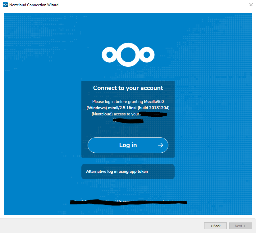

But it just goes back to the original login page.
The above happens no matter what client I try and use. This is my config for nginx (Note: I have replaced sensitive info with the word ommitted):
