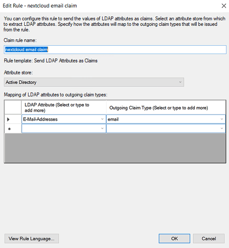

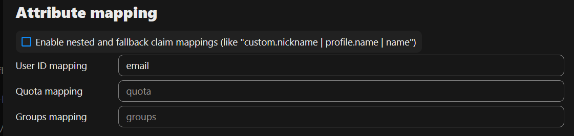

I have generally managed to do the openidconnect implementation but unfortunately the accountname of a new user is a uid instead of the email from the AD. The Issunance Transform Rule is a rule with E-Mail-Addresses as LDAP Attribute and email as Outgoing claim type and no other claim in that rule. The nextcloud OpenidConnect App is configured to use email as the claim for user_id. What could be the problem?

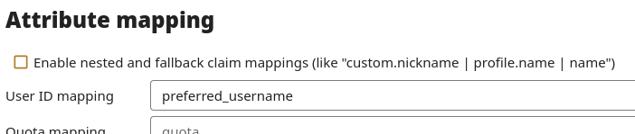

Do I have to use preferred_username for that field? Because I have my email claim already mapped to that field.
you can use whatever you want as a mapping. If you want IdP mail attribute to become NC username then use mail there.
I did the mapping but the nextcloud still takes the uid as user id mapping. Below you can see my configuration.

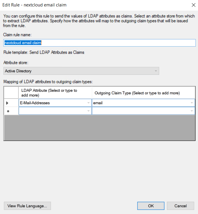

Is “E-Mail-Adresses“ a valid LDAP Attribute (what about “mail” if the source is an AD?)? What is the source of your users? What ist your OIDC Provider? We nearly have no information about your systems so we can not help..
I have E-Mail-Addresses in an other working OIDC Instance for another Application so I believe it is a valid attribute. I can not choose mail as an LDAP-Attribut because it does not exist in the dropdown menu and manual writing mail in the field does not let me save mail. My user source is the Active Directory and my OIDC-Provider is Microsoft AD FS.
