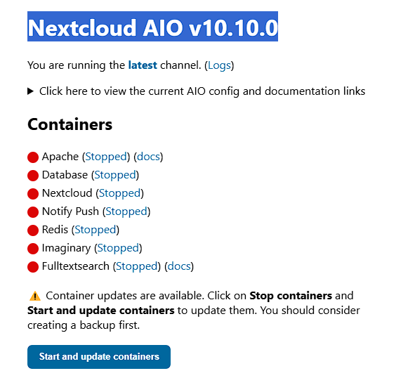

    • I had this problem this week, when I tried to upgrade NextCloud AIO to the latest version
    • AIO
NextCloud was working fine until this week, when I started upgrading.
I upgraded the master container and reached this point:
When I click “start and upgrade containers”, it doesn’t run and asks me to check the container logs

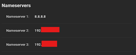

Issue resolved.
After testing everything i could, in TrueNAS configuration I changed the order of the DNSs and put 8.8.8.8 as the first one (like image below) before it was in “Nameserver 3”
it solved the issue
