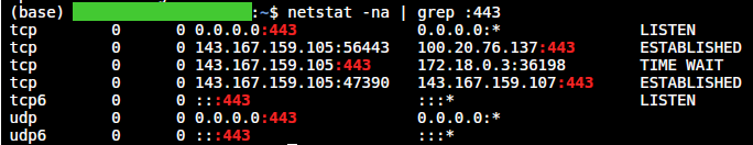

I just can’t get this set up! I followed the AIO installer instructions on Github to try to install on a Virtual Machine that is being run by the University I work at. This VM is only accessible when I’m on the local network or VPN, although that isn’t a problem to me, I don’t know if it has anything to do with the other issues I’m having.
I get as far as seeing the page showing all my containers as running and the link to “Open your Nextcloud” However on following the link I get the Secure Connection Failed error as described here. I see Timeout during connect (likely firewall problem) in my logs, so I’ve tried those steps. According to this site I don’t have an AAAA DNS record, so it’s not that. It does show a CNAME record (value is amrc-jupyter.ddns.shef.ac.uk), but I don’t know how to change that. On “make sure that port 443 is correctly forwarded” I think this is OK, if I run nmap -p 443 143.167.159.105 from outside the VM I get a response: 443/tcp open https and inside the VM I get this:
Does this look right? Is there more I should be checking to make sure this port is correctly forwarded?
