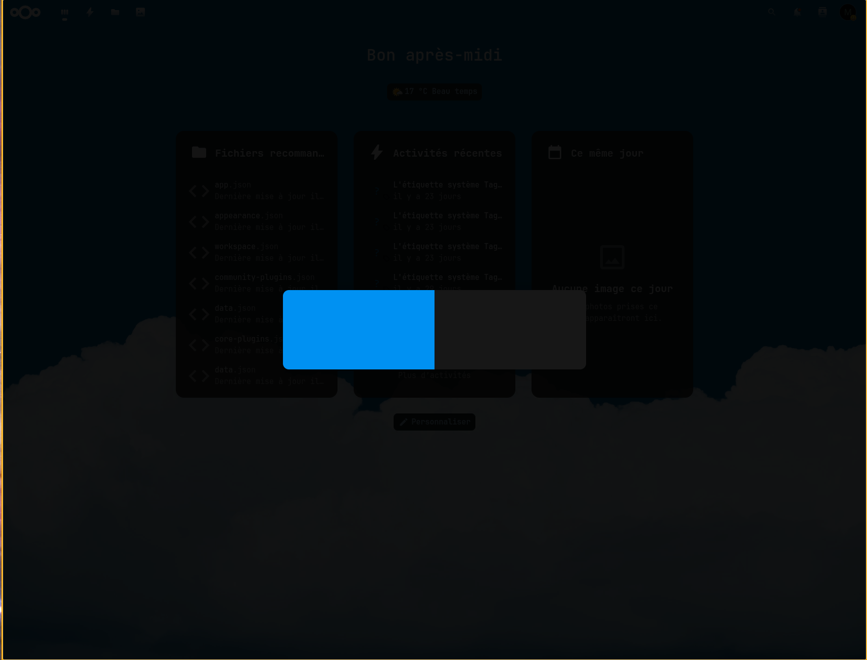

I have been using Nextcloud for years, maybe 10 years, and I have always performed major updates without any problems . Today Just after the upgrade from the latest 31 after the first login once upgraded, I’m stuck with this JS popup and I can’t remove it or continue … This is not the first time that I have broken / empty useless popup after an upgrade but each time it was not an issue and all I had to do was click next to it to make it disappear.
But this time nothing to do, It doesn’t want to disappear ? How can I get ride of this ?

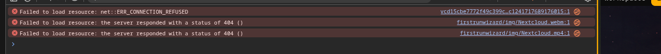

I didn’t find something very relevant in the log. But I have this in the chrome’s log :
Result :

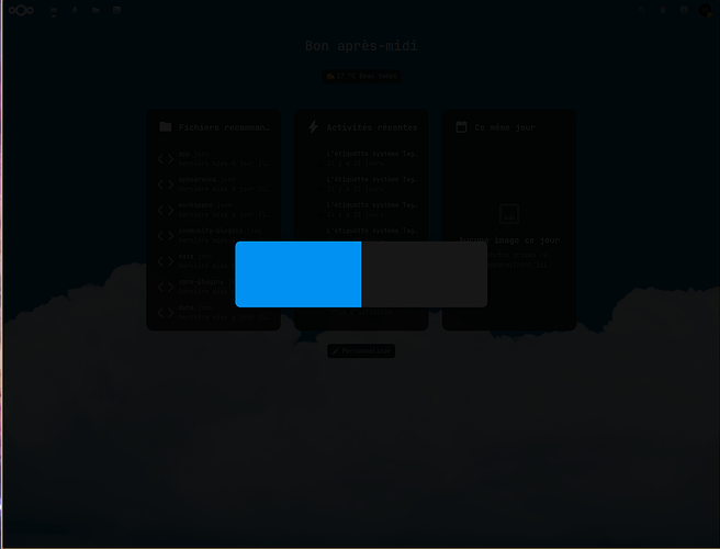

Fixed by disabling the firstrunwizard occ module , thank you :slight_smile:
su -m www -c “/usr/local/bin/php --define apc.enable_cli=1 /usr/local/www/nextcloud/occ app:disable firstrunwizard”
