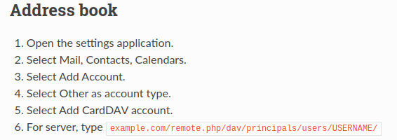

Oh boy, it’s one of those Read The Freakin Manual moments. Hope this saves others hours of frustration. I didn’t pay enough attention to No. 6 and went down the rabbit hole chasing an SSL issue:
https://docs.nextcloud.com/server/13/user_manual/pim/sync_ios.html#calendar
In the section for Thunderbird, there is a better description:
https://docs.nextcloud.com/server/13/user_manual/pim/sync_thunderbird.html
The URL for CardDAV server can be copied from the contacts settings in NC (the three little dots):
This URL looks like this: https://nextcloud.mytailnet.ts.net/remote.php/dav/addressbooks/users/myusername/contacts/
With this URL I got it synced within seconds. My mistake was to use the same URL for adding the CardDAV account as I use for logging in via the NC app which is https://nextcloud.mytailnet.ts.net
